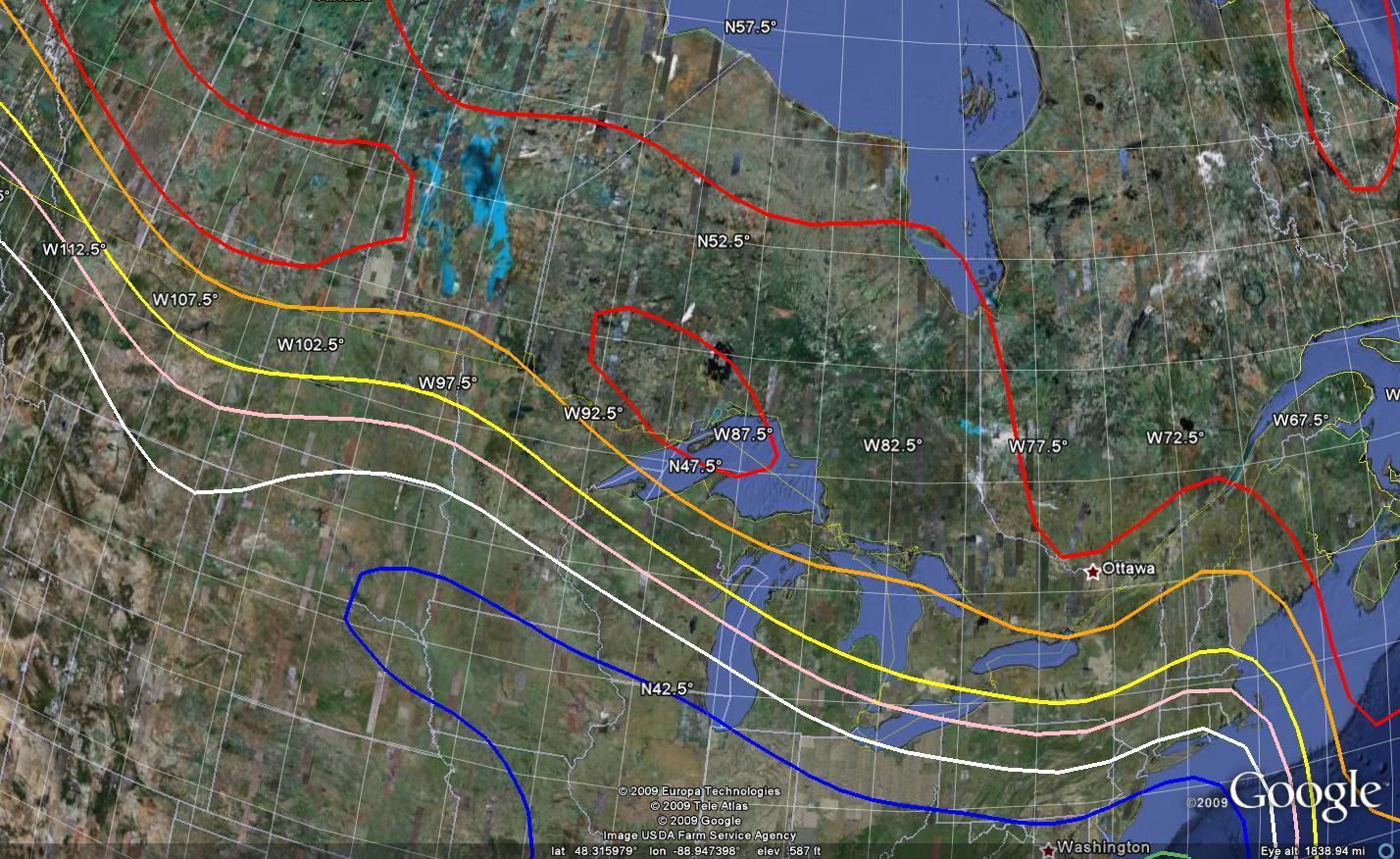

you cant get any signal on it?
that satellite use to be at 110 which was conus so unless the footprint really hosed up you might get it
Best guess for Silver Bay area ( half way up the north shore) would be something like a 4-6 foot diameter antenna (~40 dBw). It really drops off fast
