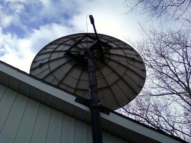

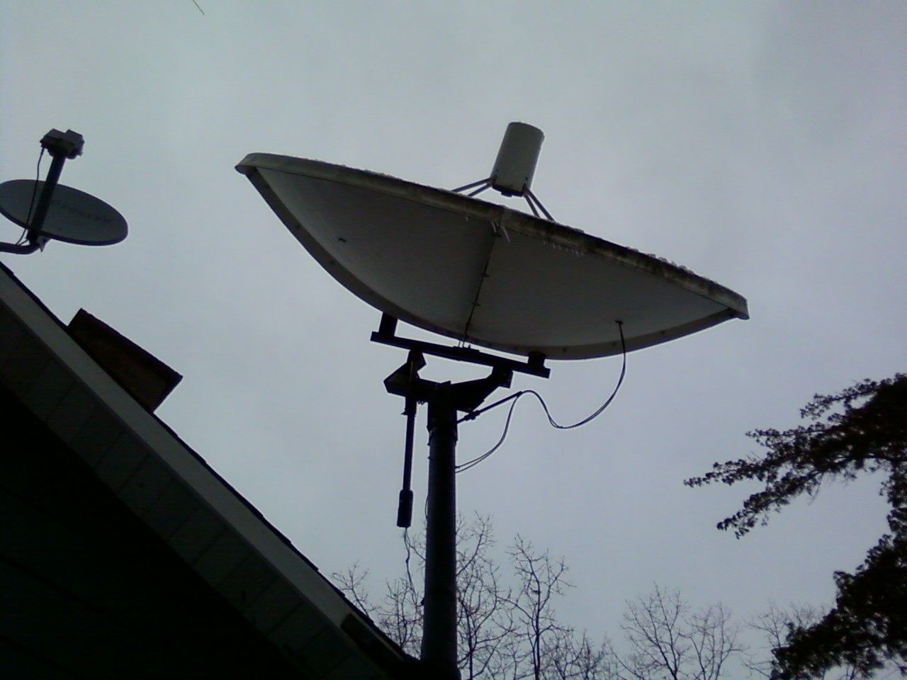

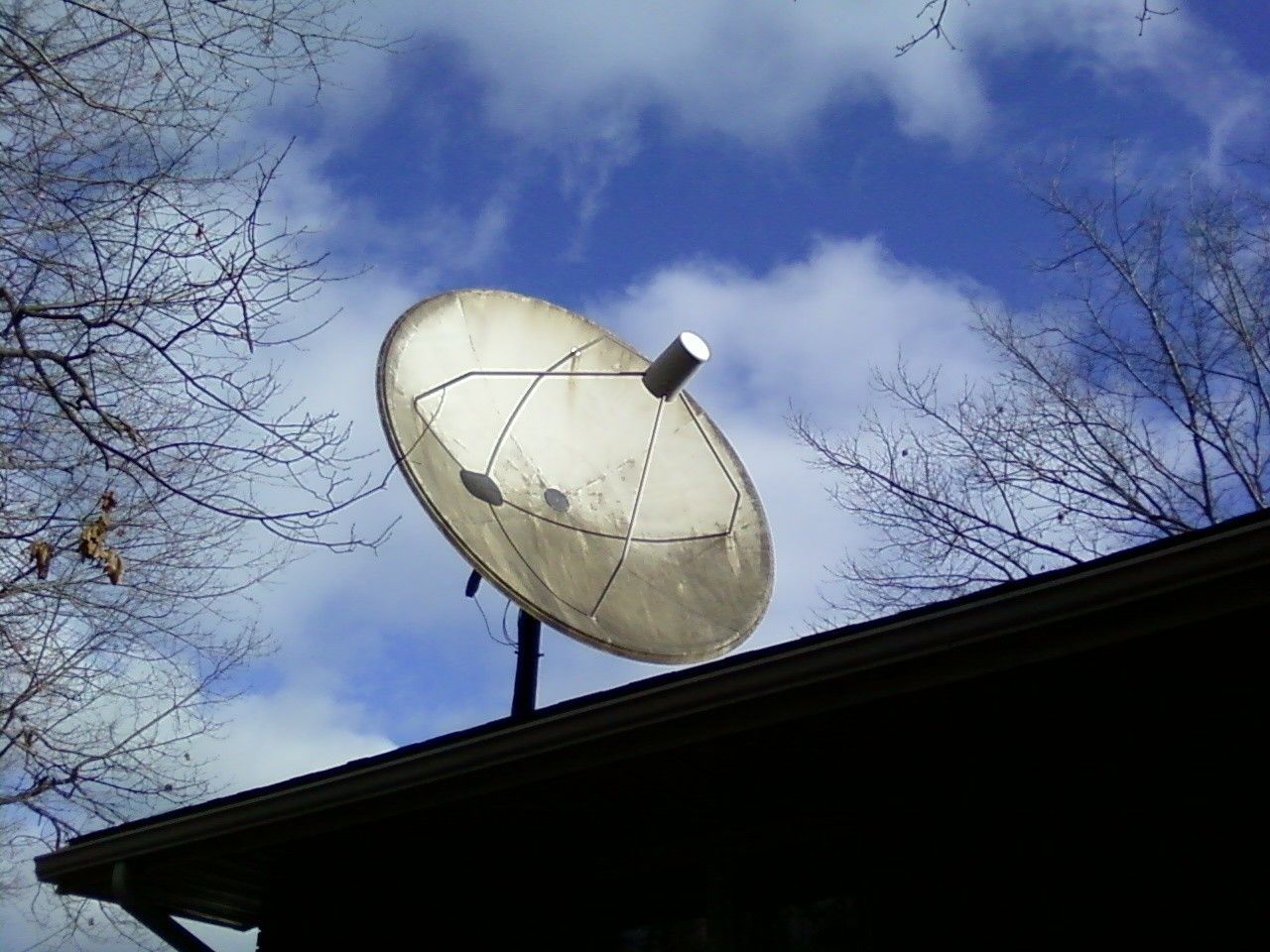

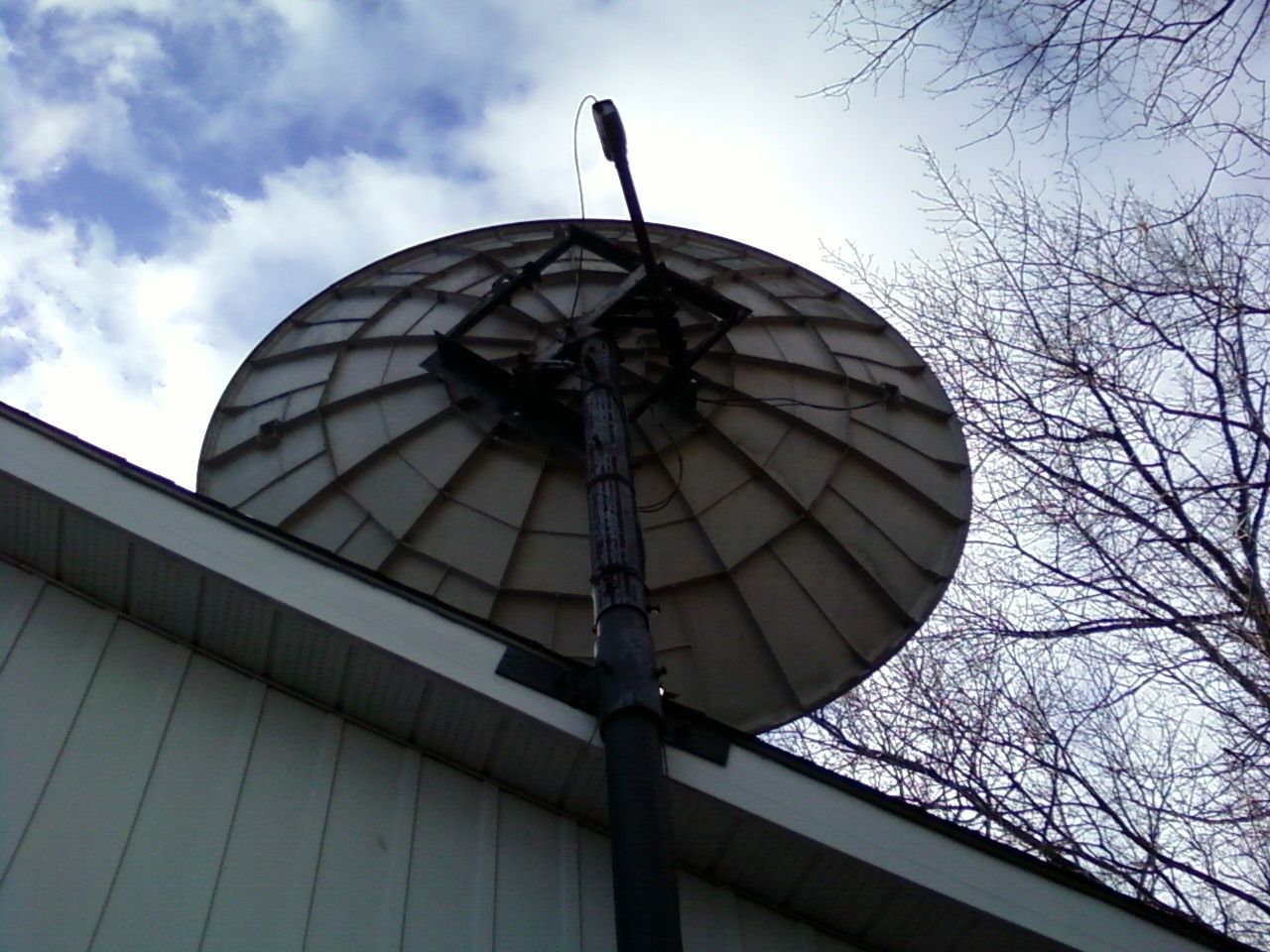

I found 2 Channel Master SMC dishes in my hunting this year. The first 2 pics are from an early version dish (it says Channel Master TVRO on the dish) that the declination is done with spacer plates. the second two pics are from a later version where the declination is done with the backplate. See the link for the manual I uploaded.

hope this helps

That's how this one is too. Declination is done with spacer plates. I don't have any other size spacer plates, so I'll have to leave it as it was originally set up for declination. I only moved the dish about 25 miles from where it was set up. I hope it's close enough on the declination side. Thanks for your help. Chad
