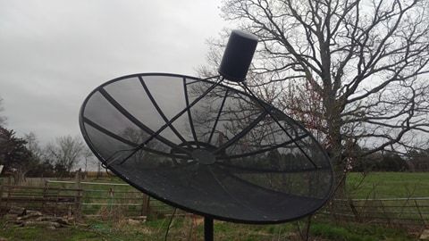

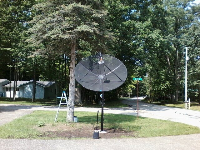

Thought I'd share my shoestring budget C-Band system. Total invested in materials and equipment is around $225. I'm using an 8ft SAMI w/24" US Electronics actuator that was given to me by someone about 15 miles down the road, a Titanium Sat Dual-Output C-Band LNBF w/WiMAX filtering. This is fed into an Amiko MiniHD 265 STB sold by Michael Electronics. To move it, I bought an old ProSat 210 for $20 w/shipping. It will tie me over until I find a good mover.
For my setup, I went with a floating concrete pad (4.5ft square, 2.75" thick) so that I can move it when I eventually buy a home.
So far, once I got the mount properly aligned and the dish up on it, I started finding loads of channels. I scanned in 91w first, using it as my southern sat. Then I was able to go both ways from there. Once I got to 133, I peaked the declination. I was able to go down to 43w.
I was hoping for the Alaskan Mux on 139w, but I am assuming it is not possible from Arkansas with an 8ft reflector?

Thanks. It actually sits on the ground without ground penetration. I probably skimped a bit on the pad size, but It is at least 600 lbs of concrete, plus some extra large blocks laid on top just in case a stiff gust comes sweeping down the plain from Oklahomie! I had a friend weld angle iron legs and a support arm (for what it is worth) and then I sank it in concrete.

It's solid enough that I won't need guys, but I am planning on a few spikes around the pad to secure it from any storm gusts. Luckily, it is on the east side of the house, so the typical thunderstorm winds will be slowed a bit by the structure.

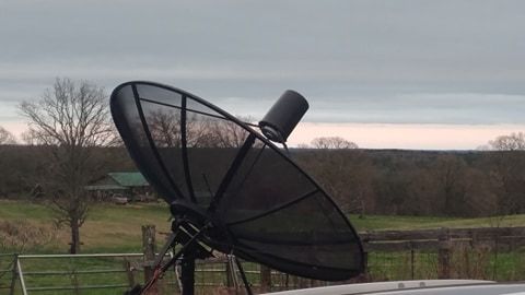

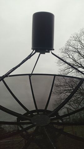

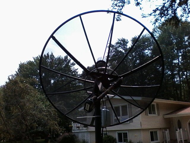

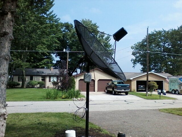

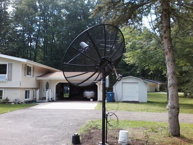

Just thought I'd give and update. With warmer weather and time off for COVID-19, I had a chance to make some adjustments to my feed and put on a new LNB cover.
I really focused an getting my f/d setting and focal distance just right. Trial and error for a couple of hours seems to have everything squared away. Many of my weaker signals improved 10-15%.

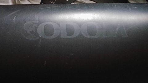

My new feedhorn cover came from a 6ft dish that had huge gashes in the mesh. Imagine this thing on a little 6 footer! It was comical. But this cover and ring were both in really good shape. It was in a yard with many trees and was spared UV damage. I noticed it had the name ODOM on it. Anyone familiar with that company?
This cover and ring were molded in Little Rock, AR, so it was fitting to go on my SAMI dish that was made in Judsonia, AR. Now I have true homemade hardware!
