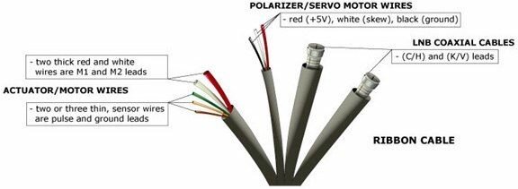

here is a pic that might help you out...
