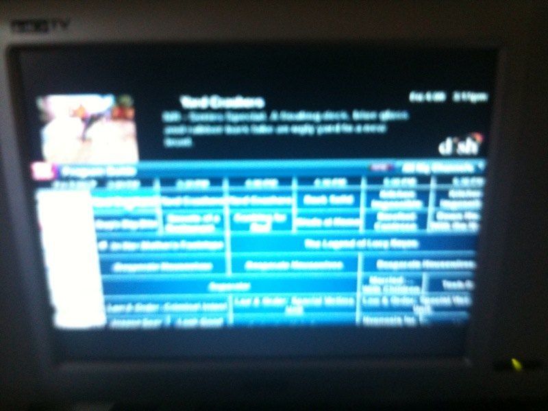

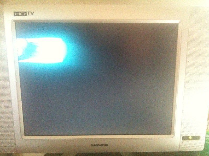

What about the issue of when you do go remote view or sling on ur iphone ur tv mirror to the other tvs shows everything from the guide to the menu black? then when you reset your reciever it goes back to normal? Picture 3 shows the guide before sling and picture 2 shows after you go sling and remote view. U have to reset the reciever to go back to normal before remote view. it can last hours also after u get out of sling on iphone.
sent from Iphone

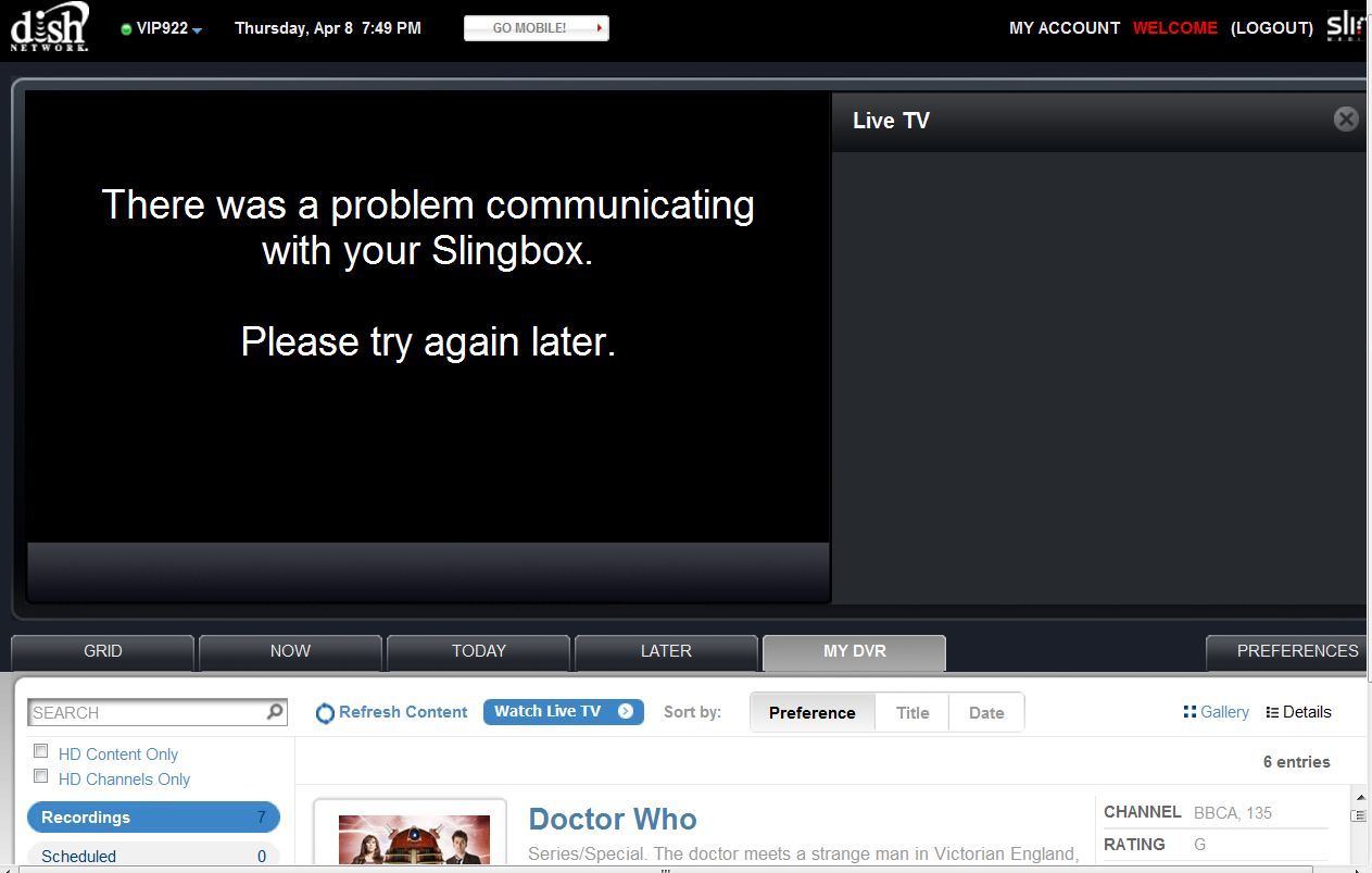

I'm still getting this error. I downloaded the new plug-in and tried this using Firefox and Windows Explorer.
I can still connect using my iPhone.
Keep an eye on it, and if your still having the problem on Monday please PM me your receiver ID number and I can have someone from Sling check into it.
I actually get the error message while I'm trying to view something. Scott, are you using Firefox or Safari? What version? I want to get thing nipped tonight. Thank you so much for the help!

Ok finally figured out u have to enable share view so u can get the guide on the other tv's
Sent from iPad
