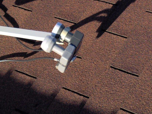

Here's an old one that I did about a year ago. The one on the right is KU and left is DBS
The DBS is off by -6 degrees so if I was at 95, the DBS was at 89

I did that too, you can't see in iceberg's picture, but well my setup, the dbs lnb is about 1/2" higher than the ku fss lnb to get optimal signal.
