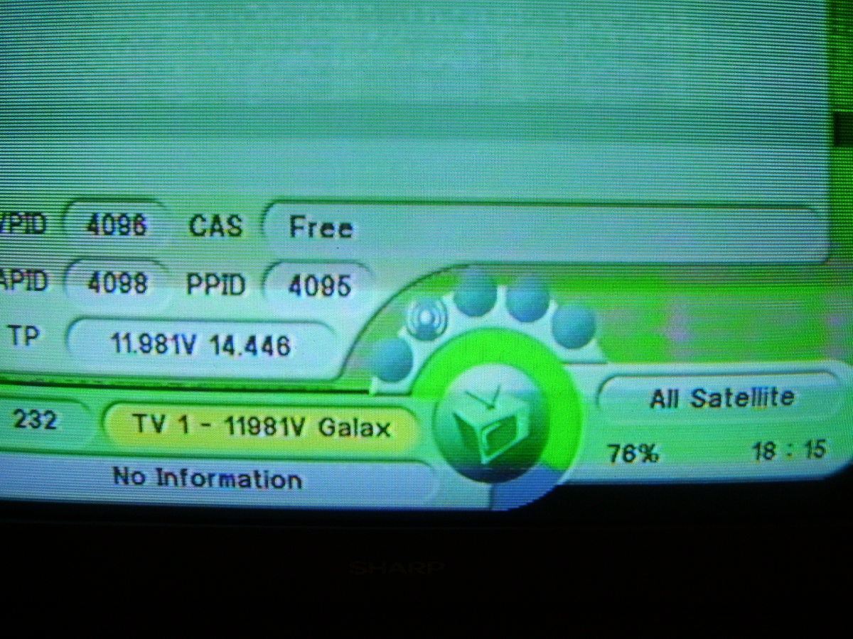

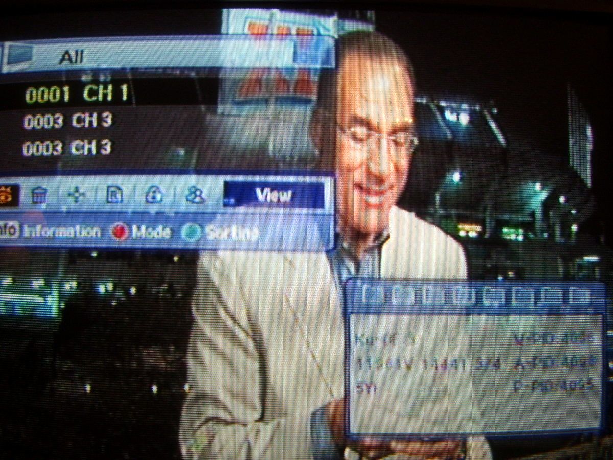

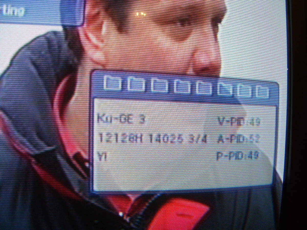

But here are a few screengrabs to show it will decode QPSK HD
1st is PBS HD on AMC3
2nd & 3rd is a feed. 2nd is the Coolsat 5000 and the 3rd is the 8000. Yes the 8000 says the channel is on AMC3 but it isn't. I am using the loop out right now from the 5000.
