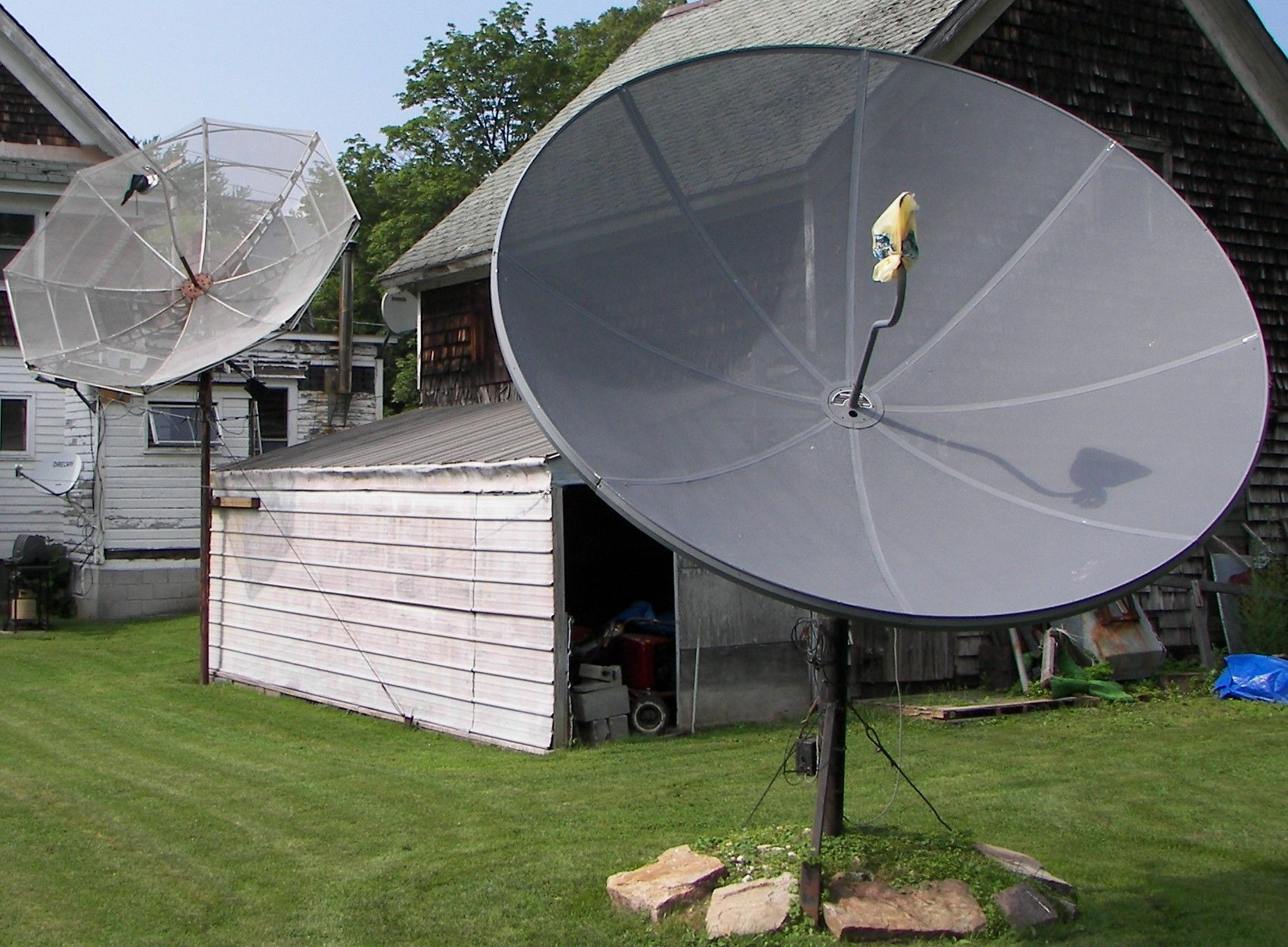

The dish is on the pole!! Tomorrow, we're going to put the LNBF (as well as support arms) into the dish. Then we're going to scan our first satellite, which may be one of he following: Galaxy 19, Galaxy 16, or SES 1.
Looking at the picture in this post of yours, I hope you have enough concrete in that hole. Maybe your ground is more solid than what I have here, but it just gives me a little worry. Mine is almost two yards and is about 2-1/2 feet diameter circle around the post coming out of the ground. Even with a mesh dish there is a lot of wind load on a ten footer.
Yes. Our ground (at least in my area) is much harder. All of the rain we've had the past few days has really helped us.

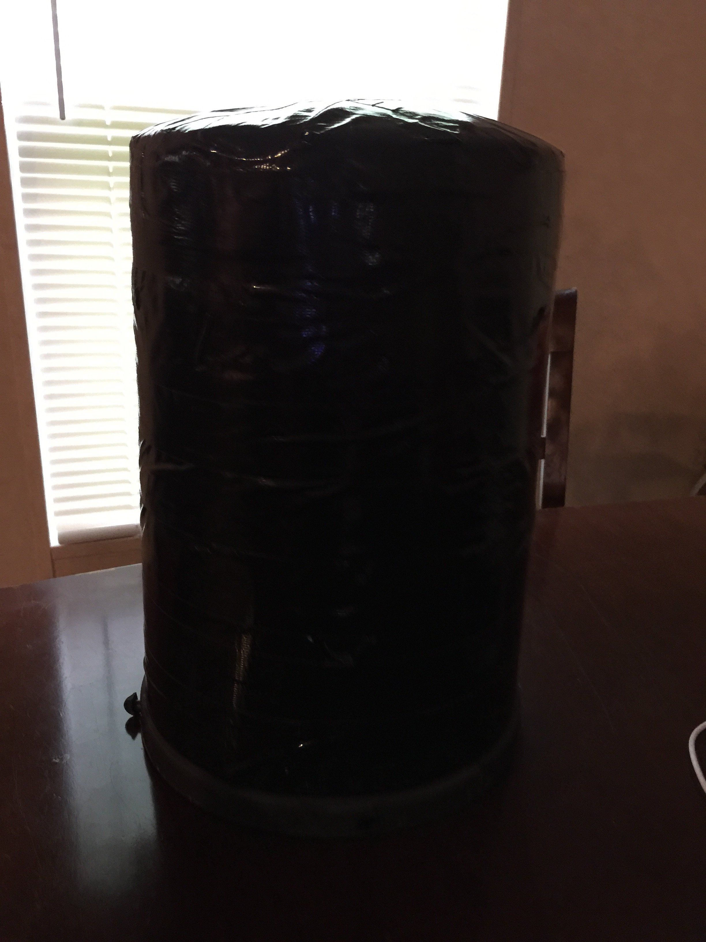

With a little super glue, silicon gel, a plastic bag, and duct tape, I have made this LNBF cover look new, almost.

Does anybody know where I can get a LNBF cover (or feedhorn cover)? If not, what could I use as an alternate one?
Some will say it is a good way to roast your LNB in that "hot box." Others may not. I had one on my first and second dish until it was mentioned about the heat. I have not used one for several years since. Just make sure you use a good sealer on the connectors to keep out the water and you should do OK.
