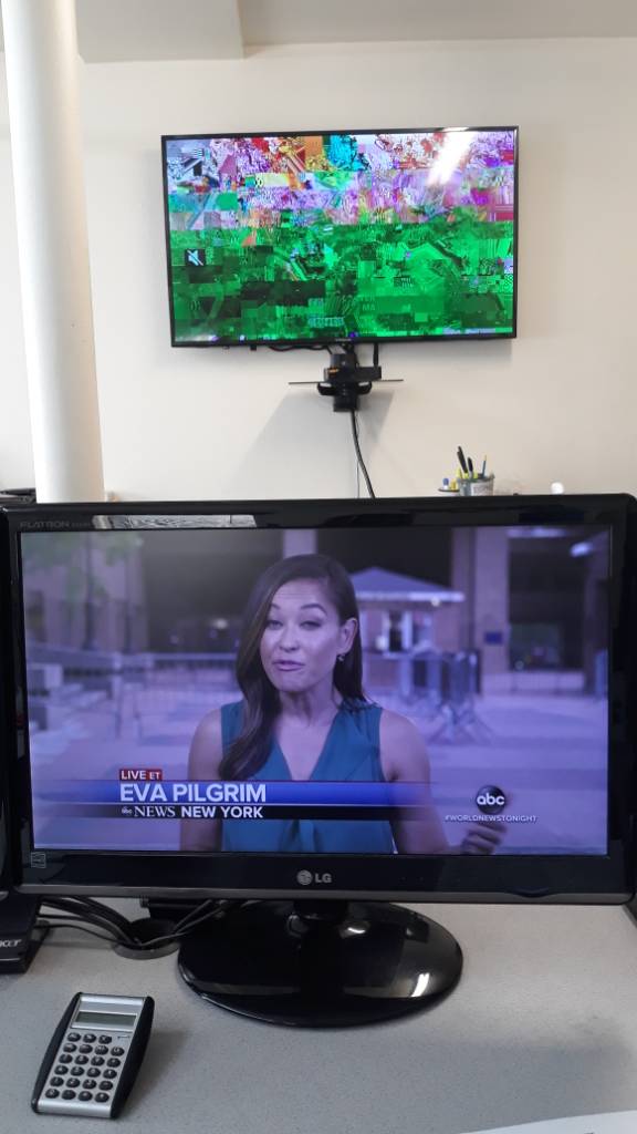

Yep, the top monitor is what FTA (unencrypted) 4:2:2 looks like with direct HDMI connection from the STB to a monitor.
The bottom monitor is displaying the same STB via live stream to a PC running the free VLC media player.
Reactions: FTA4PA
Weird; on every 4:2:2 feed I've seen on my Edision it's just a black screen over HDMI-
Not tried on the Mio yet, but everything 4:2:2 I have seen before, looks like the top TV.
