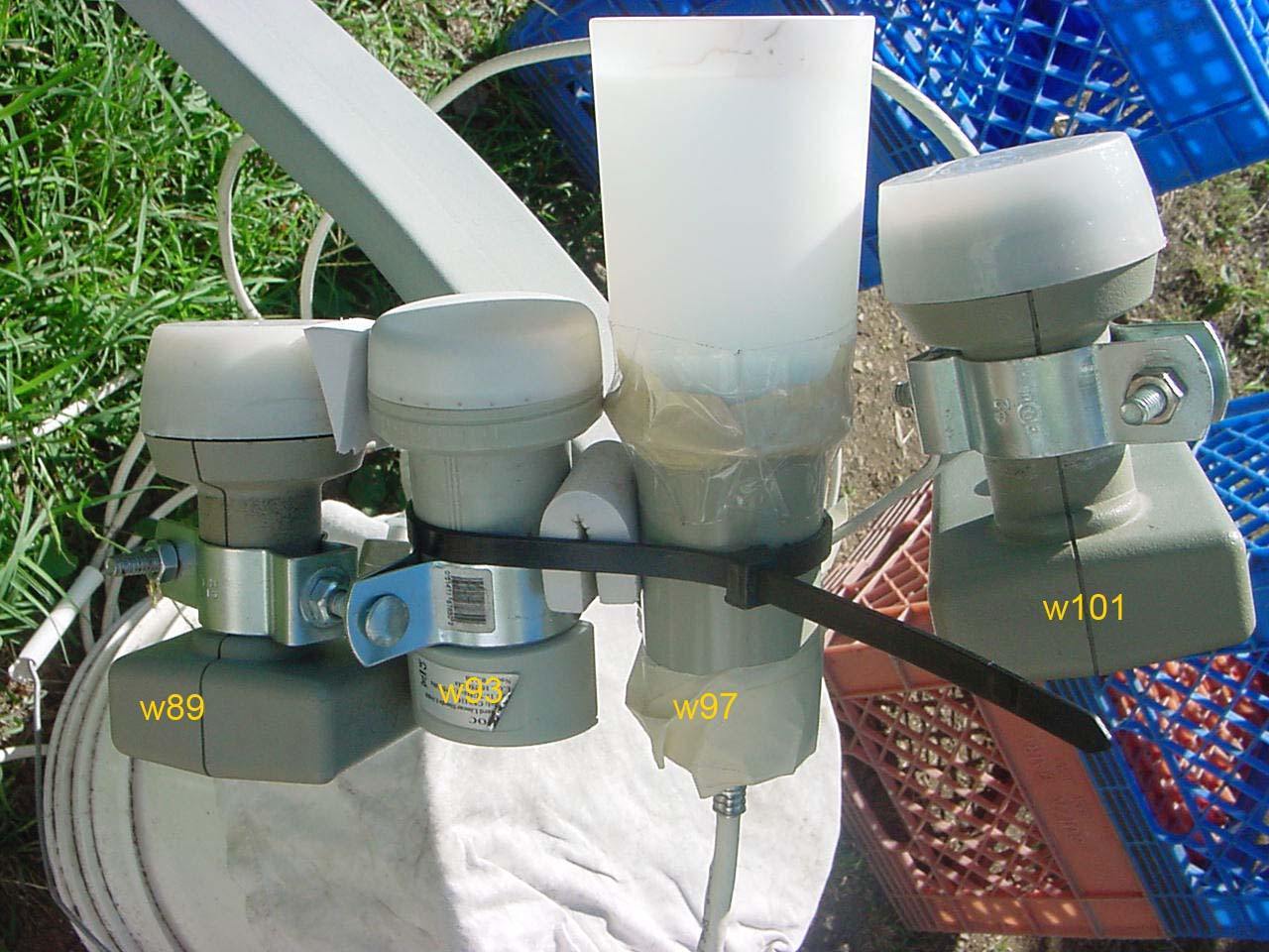

You can set 101 as the main lnb on the dish then on left side you can put another lnb next to the 101 and you can get it 97 next to it!
Here is one of the invention of one of my members of my forum did

My dish is pointing to 101w and I clamped a second LNB for 97w without a holder, just with round metal clamp. It works well. The motor would be nice, but just for two satellites this setup is cheaper and reliable. the lnb for 97w is squeezed tightly under the 101w.
