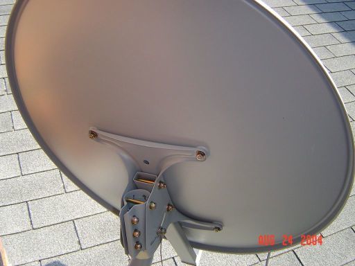

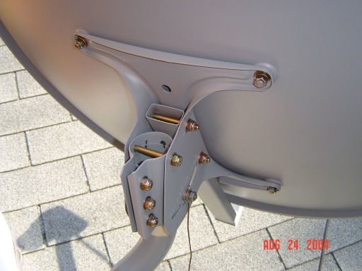

I just got my SG-2100 motor today. My dish has the slide in mount that goes over the mast not one that has u-bolts. The slide that does over the mast is to big for the motor arm on the SG-2100. I need suggestions on how to get this to work short of buying a new dish with u-bolt mounts. I need HELP or SUGGESTIONS ASAP!!! Thanks.
What size of dish is it (30" ?) And what size of pole/mast is it designed to fit on? There may be no quick fix other than making up a spacer the correct diameter to make up the difference, I have seen this done on a few pictures, its worth taking your time and fabricating the spacer first before dismantling everything, it will take a bit longer but it will be worth the wait, as long as you get it done before winter.
Heres the sizes...
The diameter of the slide mount on the dish is 2 inches. The pole in the motor is 1 5/8. Now what? Any ideas on how to make up spacers. I want to try and get this motor hooked up tomorrow.....
Maybe a strip of thin metal or aluminium curved round the motor pole to make up the difference in diameter? When you put the dish on and tighten it it may well be enough to grip it, I used this method one or twice when working with odd systems and it worked!
Thanks for the pictures that is some dish! You don't want to go back the way, you want to keep that dish, its big and does not look too heavy.
If you knew someone with a lathe machine tool they could knock out a spacer, but I think the strip of metal wrapped round the pipe will work, you will need to drill holes in it to correspond with the holes in the motor down pipe, they also may need opened up a bit in size if needed, that big through bolt is going to have to go through, let us know how you are getting on!
Post some pics here so the guys can see, its a common problem with a bigger dish, there are 90cm dish available that would slip right on, the motor works with dish up to 1.2m, as long as they are not too heavy. But as I said you WANT to keep that dish :0)
And the down pipe is easy to get off if you need to work on it, its a good idea to get all the work done before you ever plug the motor in and motor it as its preset in the "0" position.
Gonna attempt motor install in the AM
PSB, really appreciate the help. Instructions for the motor say to be careful removing the arm because the "slider" could drop into the motor. I would like to work on it off the motor though. OK, I know this has probably been asked a million times already but here it goes one more time. I know the mast has to be plumb. Once that is done, I need clarification on mounting the motor to the mast. My most south sat that I can receive is SBS6. I think I am suppose to mount the dish with the motor pole so that they are in direct line. Then turn the motor and dish as one. But I am not sure if I line the motor and dish up to true south or my my most south sat. If I line up to true south and not SBS6, what do I do after that? Then after the first alignment, do I have to align with all the sats in the arc or does the receiver take care of that. Thank in advance....
Current Dish Setup (pics)
Here is where I'm starting from...
You point it at your true south satellite and peak it in, it may not be "True South" but its all we have, then you can compensate later on when you motorize from side to side you will see a slight in balance then just split the difference, get everything in a straight line and the dish/motor turns on the mast until you hit SBS6, good luck.
