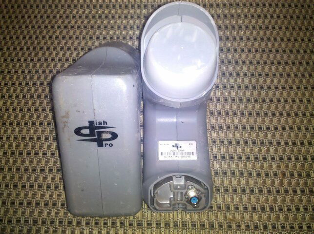

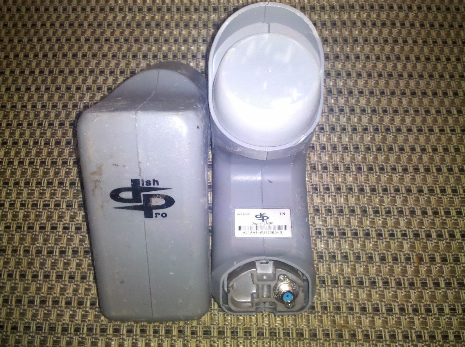

Is there a specific model or part number on those LNBFs I can search for? When I search for Dish Pro LNBF is bring up all sorts of nonsense and most of it is wrong. If there a specific number I can search for that would make it easier and reduce the chance of me ONCE AGAIN buying the wrong thing. Oops.
Get one and remove the plastic housing, it might look closer to your Directv LNBs. All you need to search for are DISH DP dual LNBs not Twins or Quads and definitely not Legacy.
Dish DP lnb will do it on search. You can save some money with a single lnb output model since your 3 dish setup would not be using the second output of a dual outputs lnb .
Rip the plastic cover off (not needed) and you will see that the aluminum horn will fit your existing mount. You may have to increase the barrel diameter a bit using duct tap for a snug fit if your old direct lnb has a slightly larger barrel diameter.
I found Ebays search function for Dish Pro dual LNBs was very poor Twins and Quads were listed.

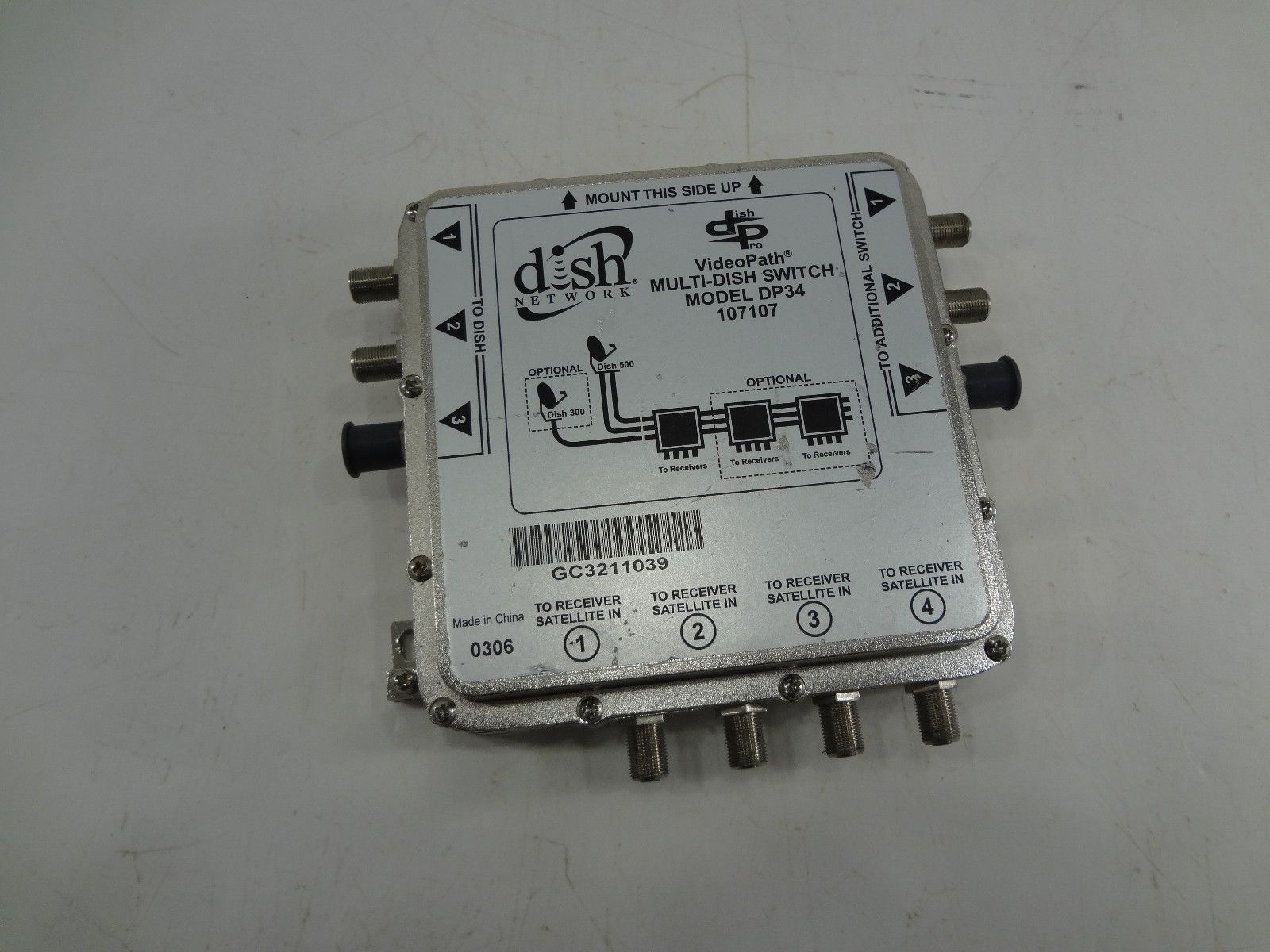

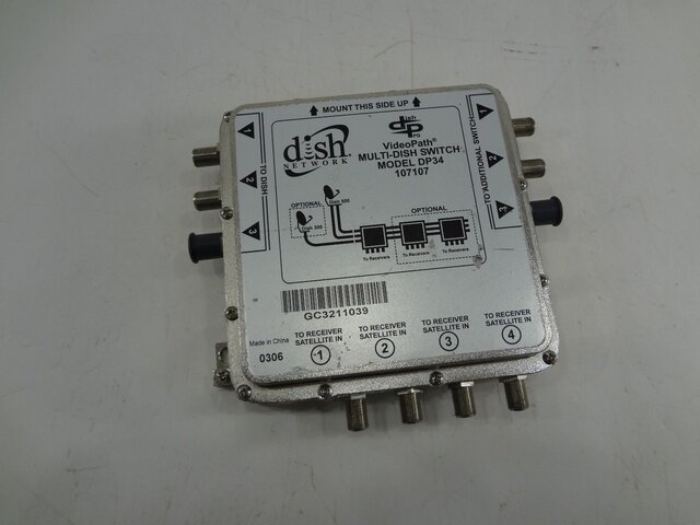

I will connect them to this switch $_57-7.JPG which will allow me to connect up to four receivers, correct?

I just bought three of these Dish Pro LNBFs View attachment 104721
I will connect them to this switch View attachment 104720 which will allow me to connect up to four receivers, correct?
well 4 tuners. If you had a dual tuner receiver (like the 722) then you would need two lines to the receiver.
But for simplification yes you could run 4 211's off of that switch
