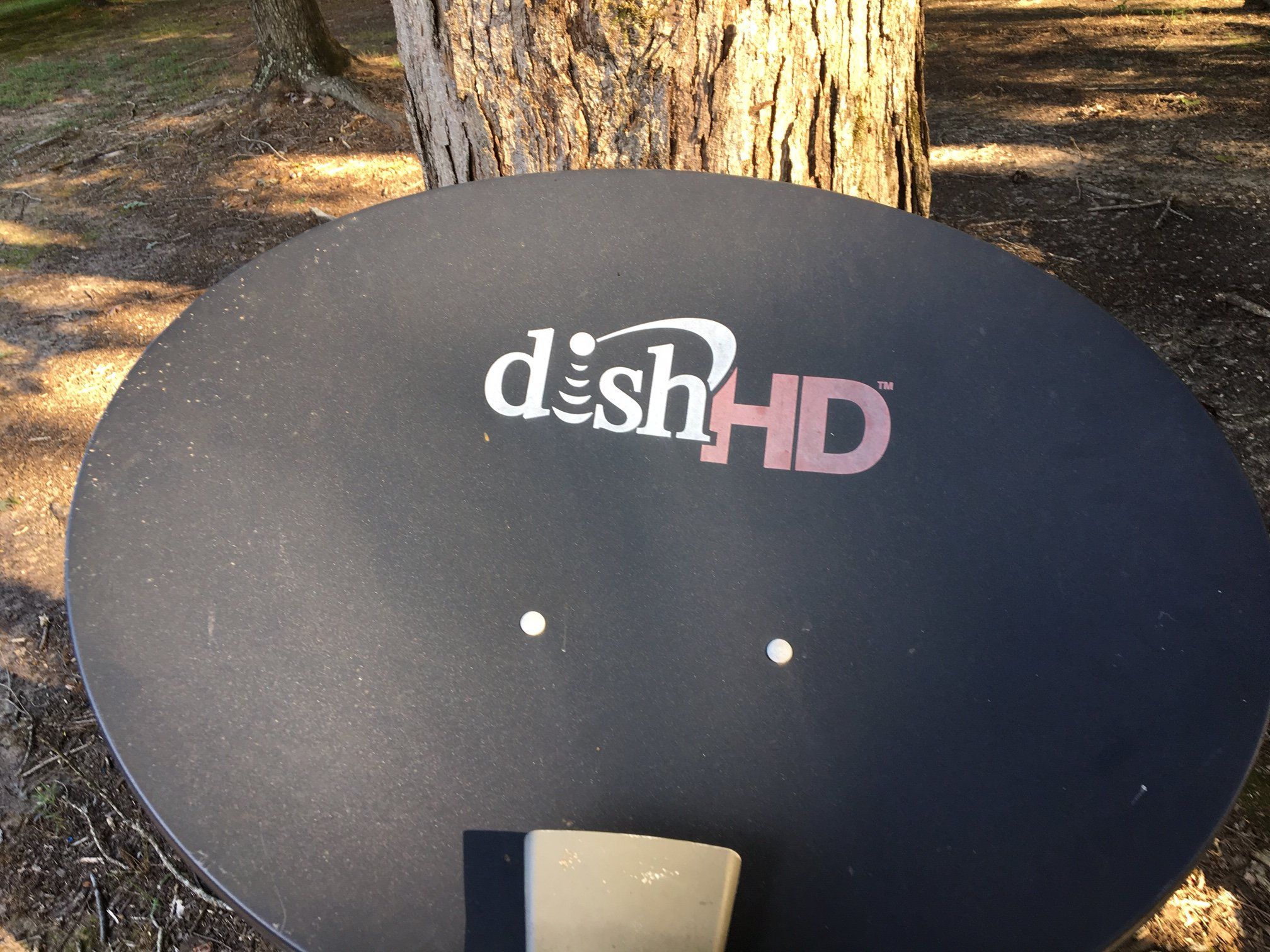

I live in central Arkansas and we like going camping on the river about 30 min south from home. First off after reading lots on here I know that I don't know much about all this so please bear with me. I have a Dish 722 receiver at home for 2 TV's that is eastern ark using the 61.5 and 72 sat. I just picked up a 211 k box and was given a dish by a friend to use. where we normally set the camper up has a good opening to the south, south east so I would like to try to use these same satellites. how can I tell if the dish I have will work with this? thanks for the help.
This is the dish I have
It will work just fine.
Its a 1000.4 EA dish.
It does 61.5, 72, 77 orbital locations.
Works with All 211s

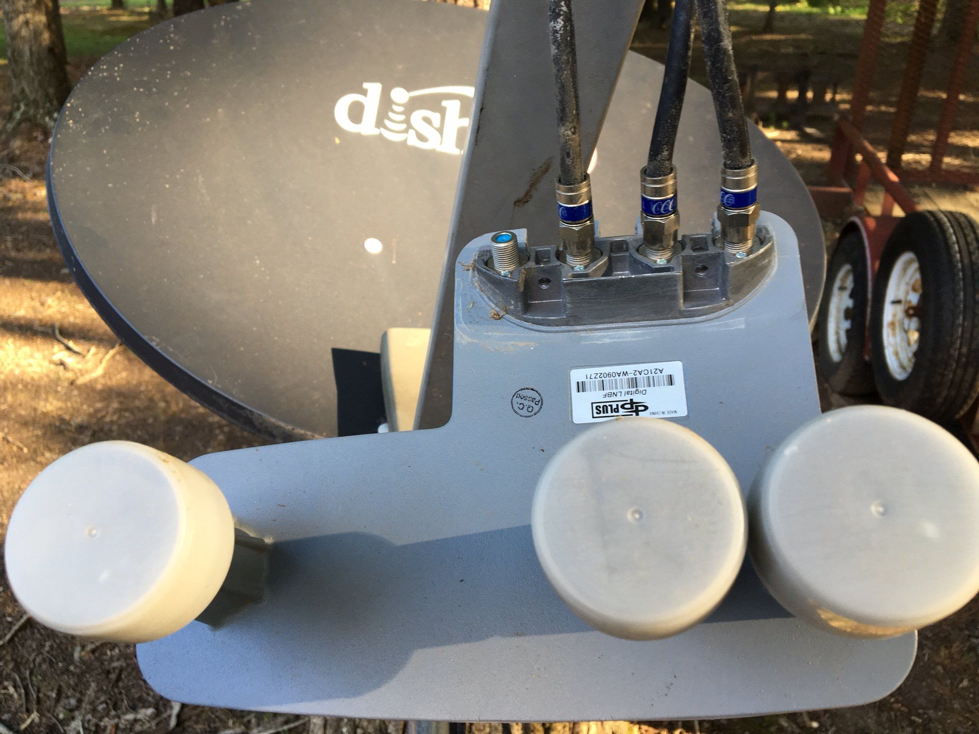

Thanks for the help. Next, the dish has 3 coax cables coming out. When I had it open I ohmed each and labeled them 1,2,3 to correspond to the lnb. 1=77, 2= 72.7, 3=61.5
Which do I connect to the receiver or do they all three need to connect to something and then to the receiver?

You only need 1 wire per receiver.
Doesn't matter which port.
Just not the LNB in port.
Pro Plus LNB does all 3 locations from one port.
If you are Hooking up a Dual Tuner VIP, than you need a Separator at the back of the Dual tuner receiver.
But 211s dont need this.
You only need to know which satellite is at each port if you are Using an external Multi switch, and even then, thats only if you don't want all 3 orbital locations at the switch.

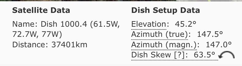

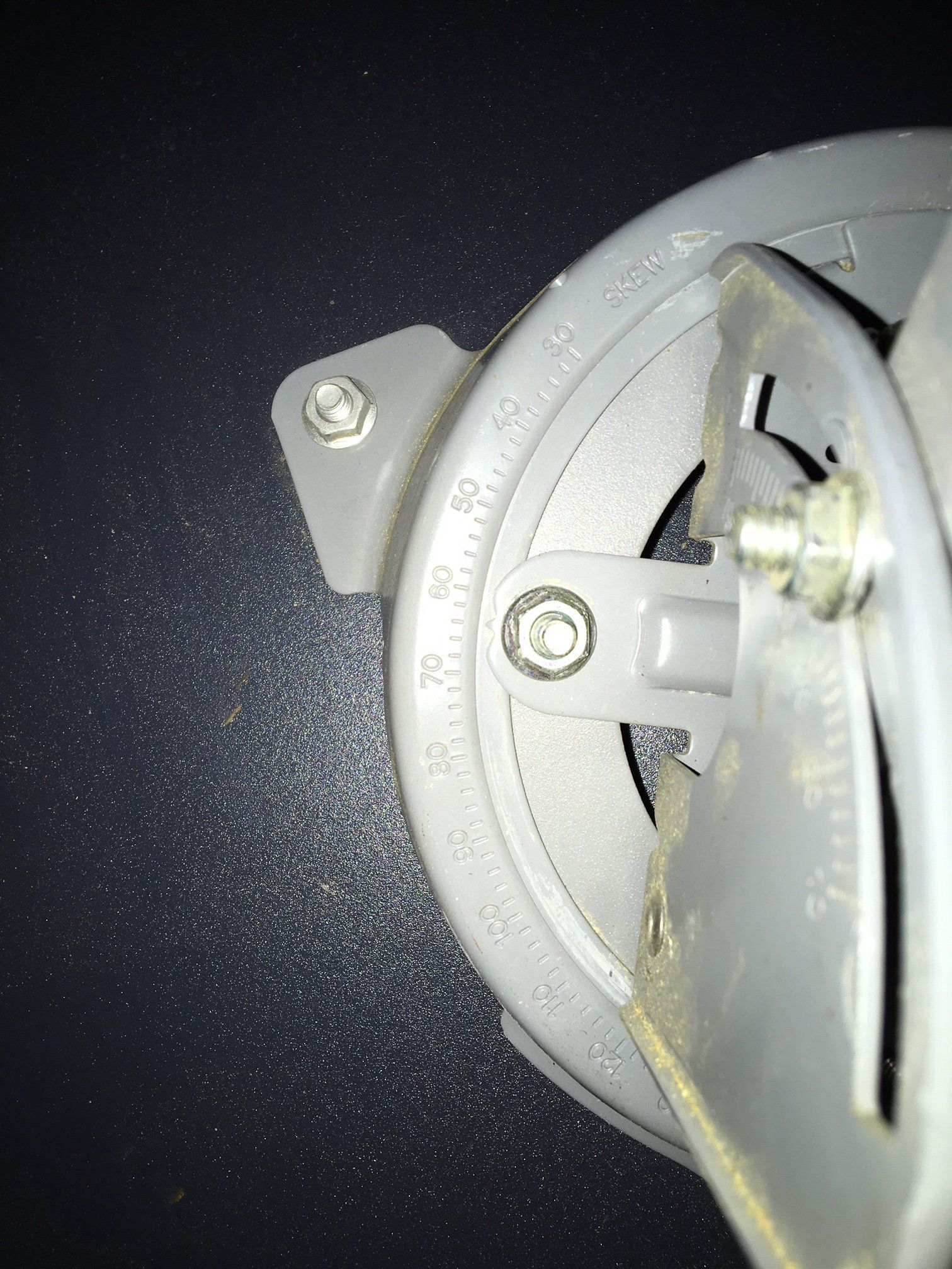

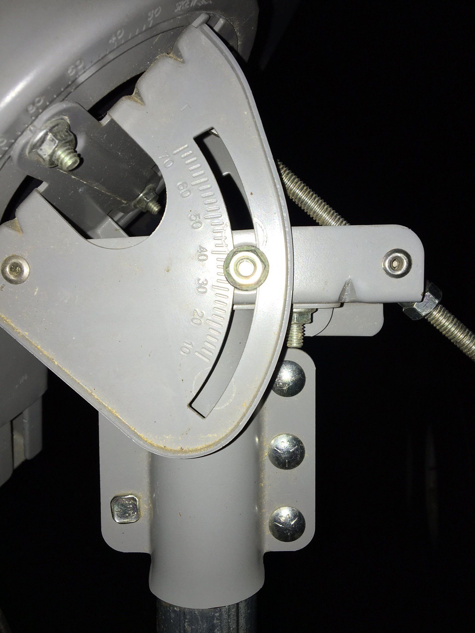

Thanks for the help, that makes sense now. One last question, I put in where I will be into dish pointer and this is what it spit out. Just making sure I picked the correct settings. Also assuming my mast is perfectly plumb is my dish set correctly now assuming I point the correct azimuth? Thanks again for getting me straightened out.
Thanks for the help, that makes sense now. One last question, I put in where I will be into dish pointer and this is what it spit out. Just making sure I picked the correct settings. Also assuming my mast is perfectly plumb is my dish set correctly now assuming I point the correct azimuth? Thanks again for getting me straightened out.View attachment 119645View attachment 119646View attachment 119647
No your dish is not set correctly. You will need to make small adjustments to peak your signal, but those settings will get you in the ballpark.

The settings look fine for elevation and skew.
But remember you still have to get the azimuth correct.
That requires a lot of patience, and a Signal meter would aid tremendously.
