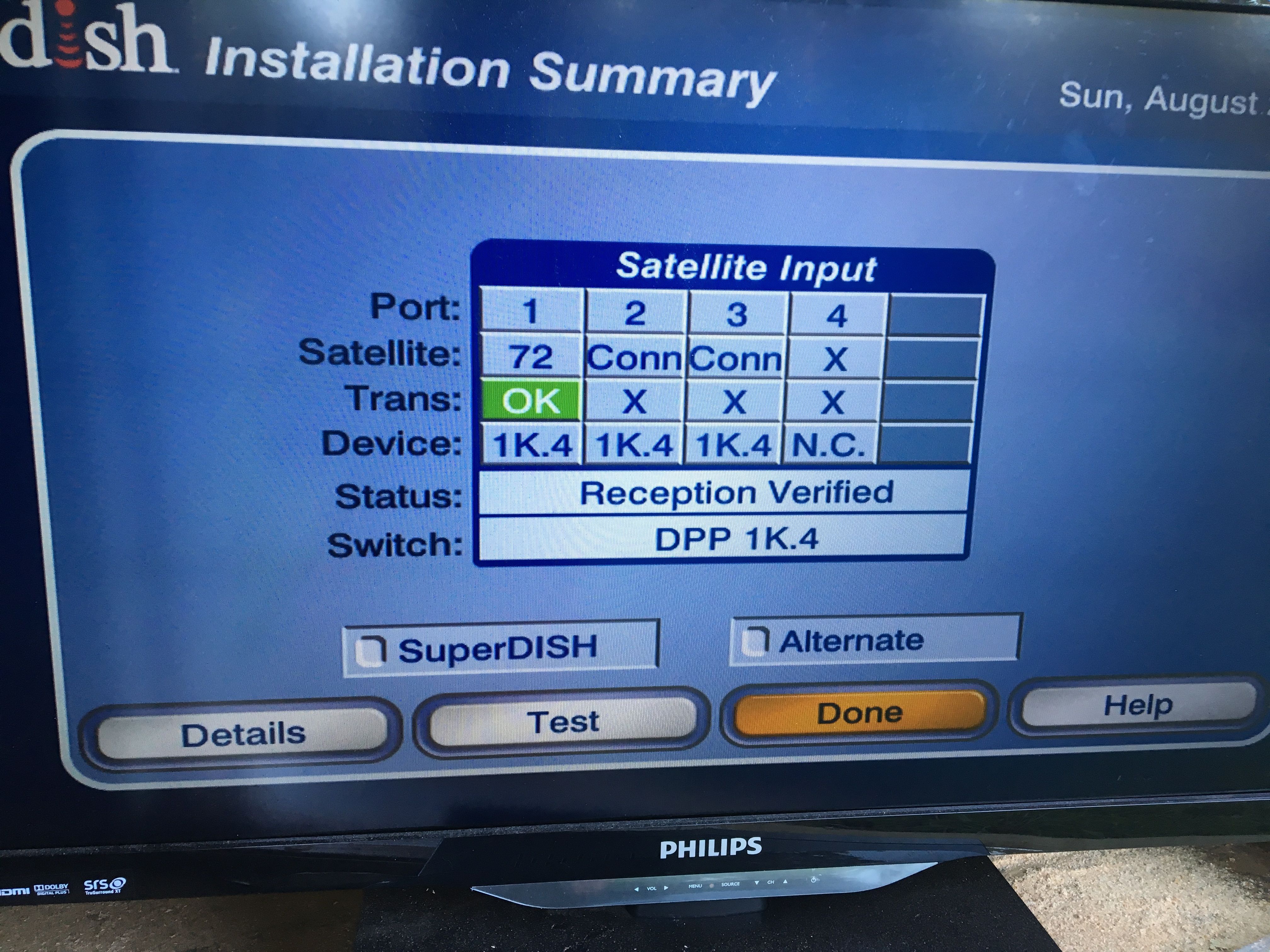

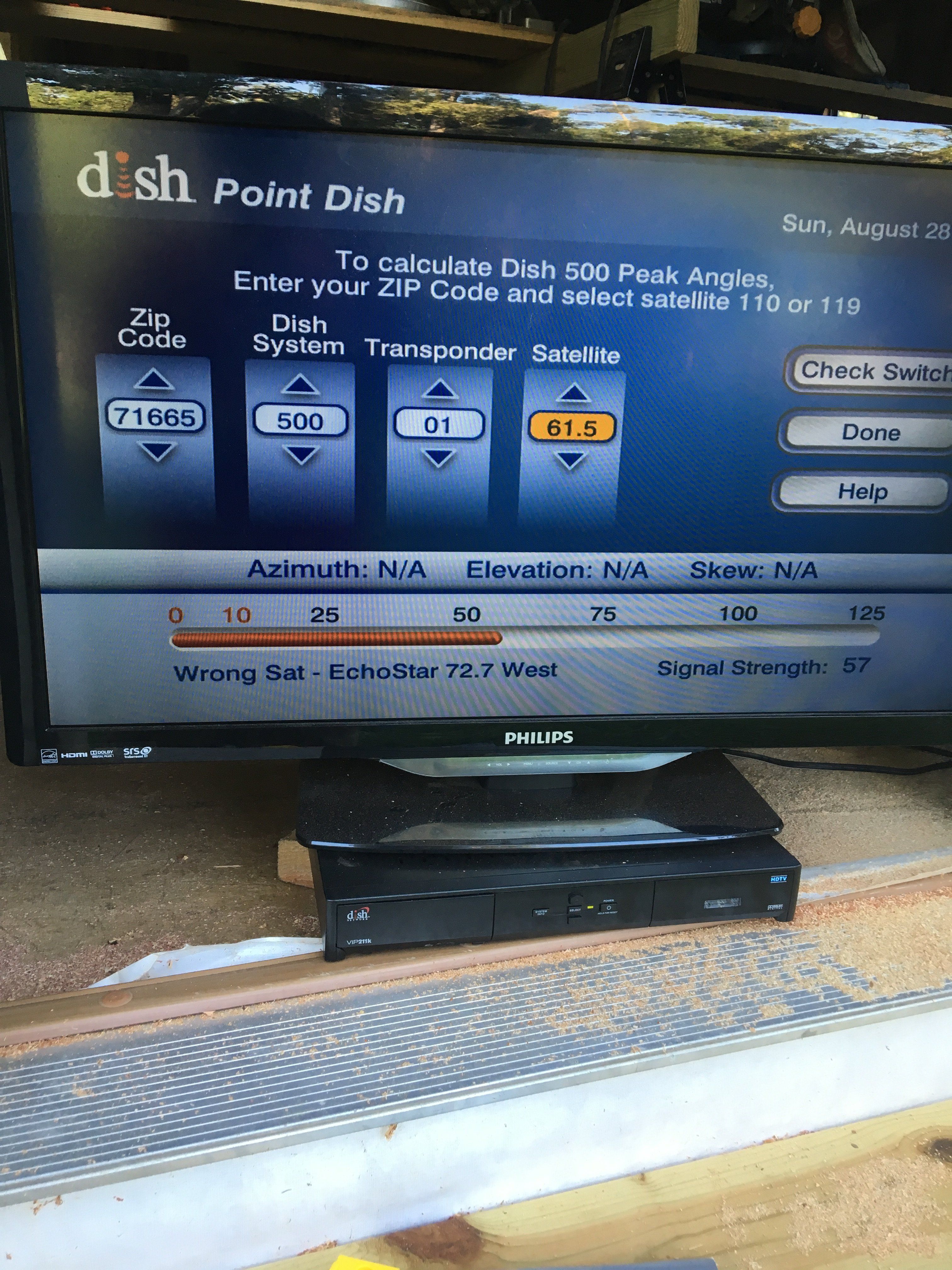

I drove back down this afternoon when we got back from the lake. I was still only able to find 72. It peaked at 60. I ran check switch and that's all that showed up. On the dish pointer screen if I change it to 61.5 all I get is wrong sat.
I haven't worked with an EA dish much but I know when I am aiming the WA with a DPP 1000.2, I need to insure that the multi-switch is connecting the 119 LNBF to the coax that I have the meter on. I do this by forcing a 22 KHz tone on the coax.
The order of cables on the multi-switch should not matter but perhaps the EA multi-switch needs to be set to the 72.7 LNBF.
Are you setting the receiver to point at satellite 72.7 and a transponder higher than 11?

View attachment 119700 View attachment 119701 I drove back down this afternoon when we got back from the lake. I was still only able to find 72. It peaked at 60. I ran check switch and that's all that showed up. On the dish pointer screen if I change it to 61.5 all I get is wrong sat.

But if you are peaked on the 72, I see no reason atleast 77 wouldn't show up.
Unplug, receiver, and try to rerun another check switch.
Its extremely difficult for you to be peaked at the 72, and not see the 77 or the 61.5.
Unless LNB is bad, your Skew is set at 90 degrees or completely skewed the wrong way, or there are obstructions of some type.

72.7 should be showing up on Port 2 after a check switch. Connect the coax to Port 2 on the LNB and try aiming again with the left and right LNB's covered with foil and the receiver set to 72.7 TP 14.

Well third trip was a charm, I covered the two outer lnb found the 72 and then removed the foil and had 61.5. No 77 but I didn't notice any channels on it. The 72 was around 49 strength and 61.5 around 45.. I imagine I could tweet it and do better.

Yes you can TWEAK it probably slight elevation adjustment..
Thanks for all the help. We just got set up for the long weekend
Yes good, nothing on 77 to worry about, but you could try peaking what you have.
If you have the 72 and 61.5 peaked, there should be no reason the 77 wouldn't be there.
