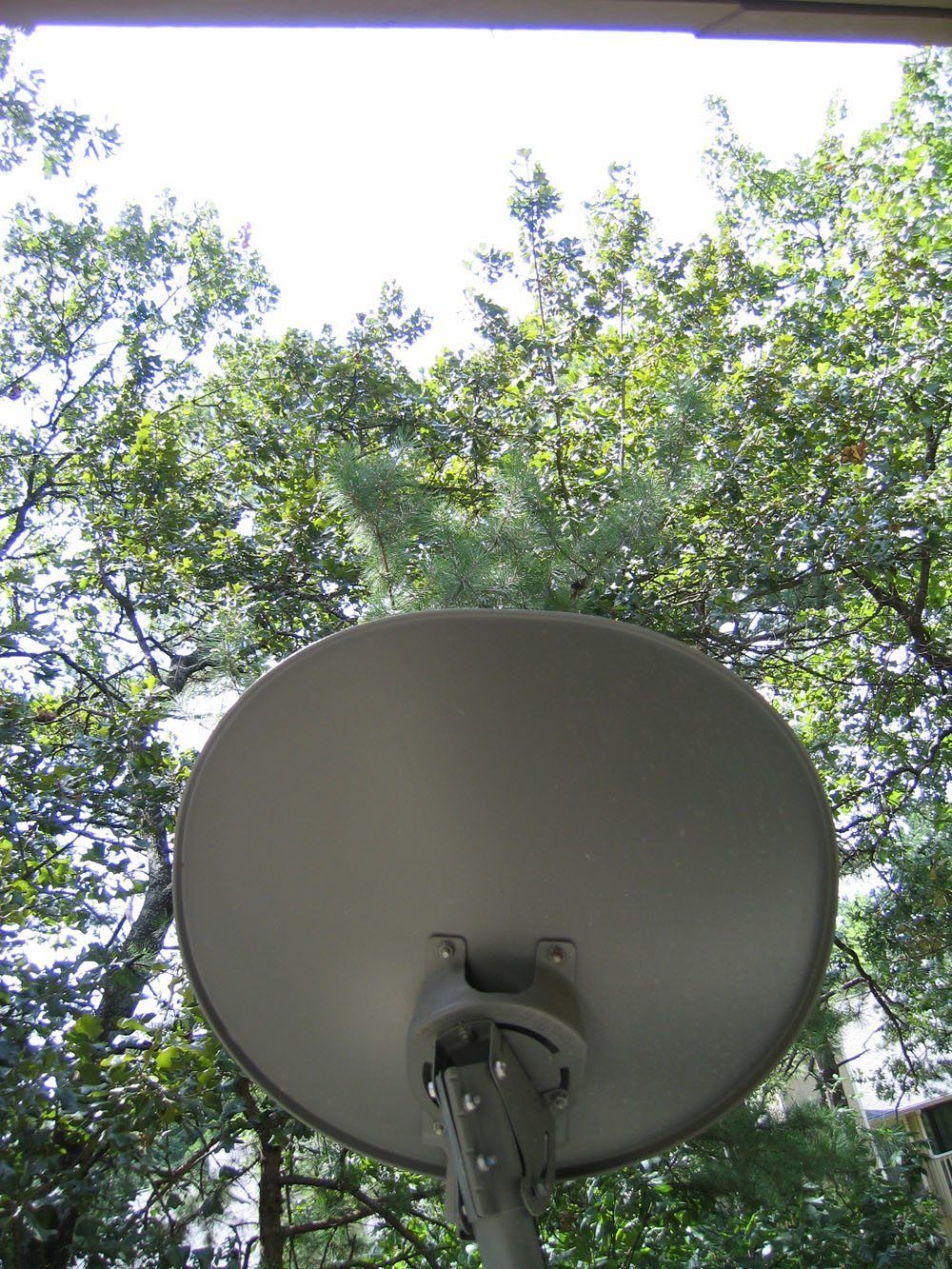

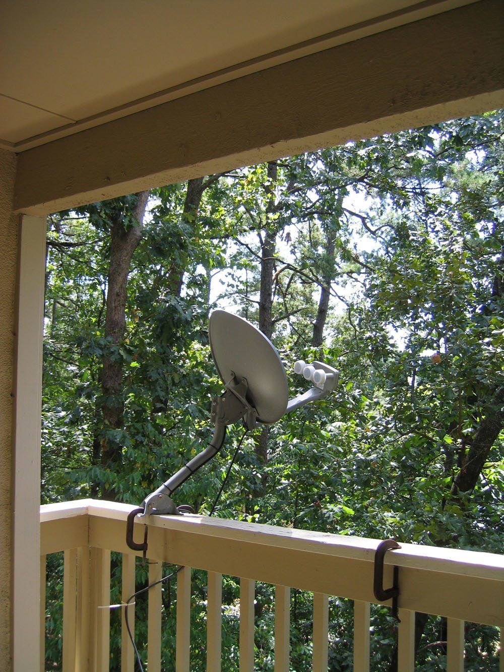

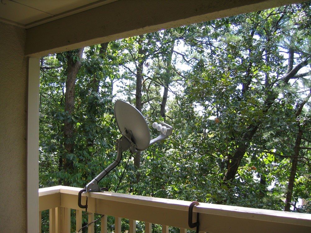

1. Currently have 3LNB installed (see all birds w/ exc. strength)
2. Apartment management loves me and let me do what I want (even trimming trees!)
3. Prefer to use clamps rather than screwing into wood (though I can do it; see #2)
4. Tree cover is a possible issue in terms of placement options (see pics)
5. Wind is not much of an issue given tree coverage. Practically live in a forrest!
I currently have a 5-LNB upgrade w/ HD-DVR installation scheduled for 8/31. I assume that I will not be able to use my current pole with the new slimline.
How do you all think the install will be done and do you see any issues given the pictures you see here.
I originally had to do the install myself since D* installer said there was no LOS (just from looking.) What should I be prepared for in terms of issues that could come up?
(I am in Arkansas so my angle is ~45 degrees to the sky.)

One thing that I would have ready is the knowledge of what satellite your HD Locals come in on. Second I would try and site them prior to the installer coming to do the install. I would lso invest in a non penetrating roof mount with a 2" mast. This will allow the installer to install the dish with out written permission from the complex. As the slimline is a little heavier and needs more support as well as make for a cleaner install.

Hard to tell on tree coverage. You will need a new mount though. I have a tripod on my balcony. My 3LNB was mounted to the railing like yours is now. The tripod has 4 small holes screwed into the cement on the balcony my complex did not have a problem.

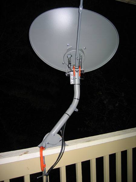

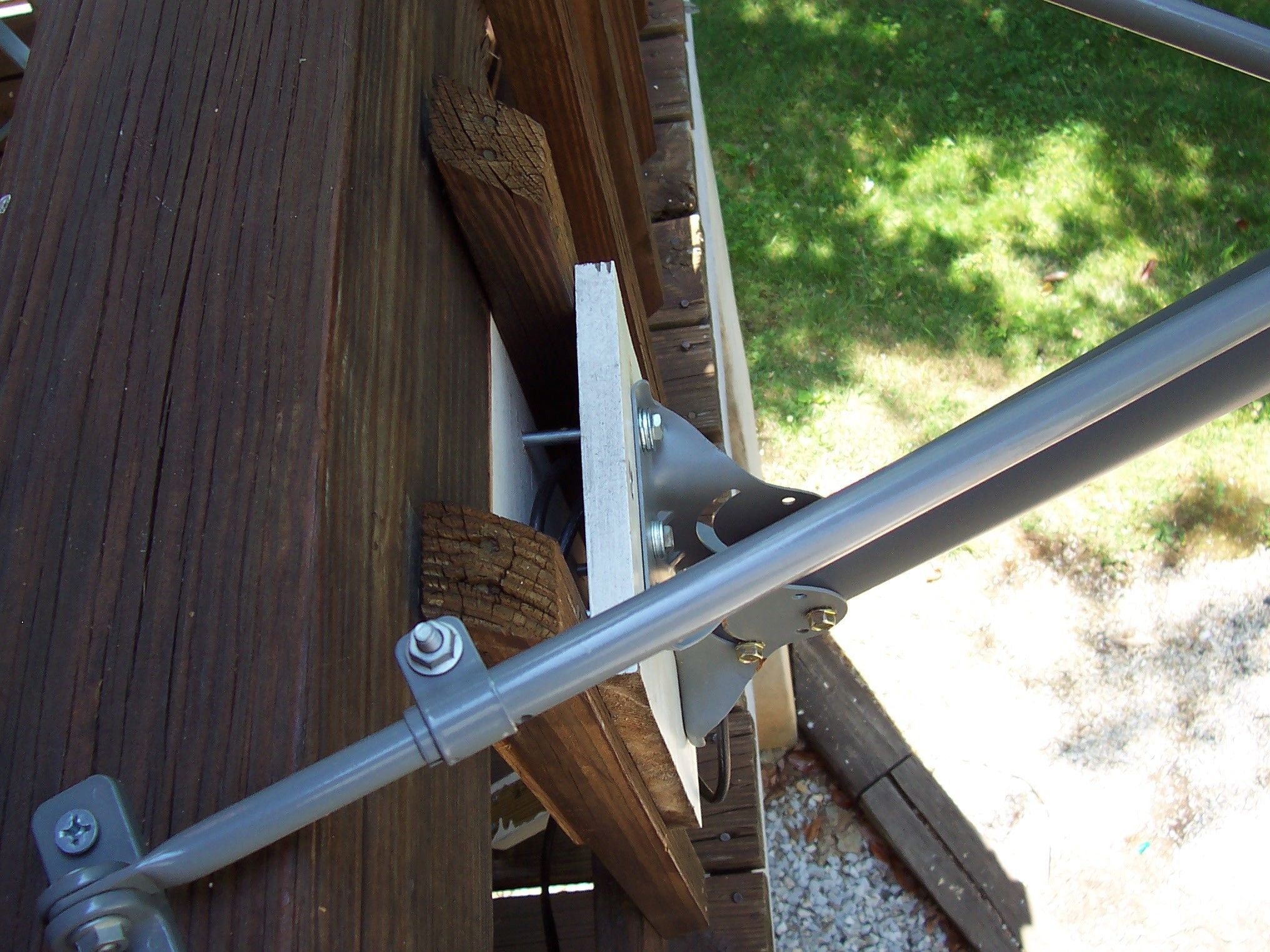

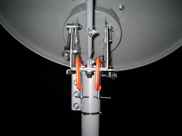

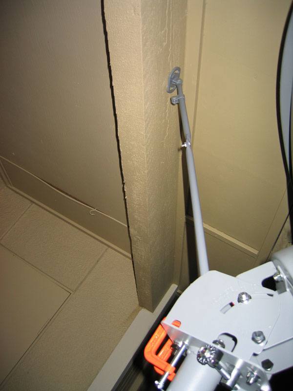

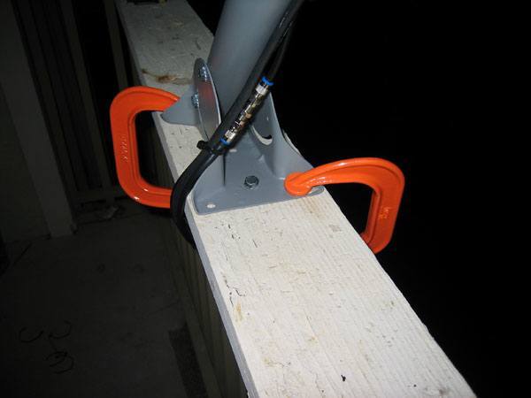

ok, this is either really stupid or really smart. but here is how we did this install.
I went out and bought clamps. Although the installer put two lag bolts into the railing (don't tell landlord!) I added clamps to secure it and cover up the fact there are lag bolts into the wood. It was pretty sturdy, but it's obvious a really high wind (which we don't get given trees and landscape) would move it around...
So, here's where I got really clever. :eureka
I took the two secondary support mounts/feet and put them together. Took one end and clamped it to the dish. The other end I put up against a concrete support beam than runs across the length of the apartments. I will go out and get a 6" deep clamp and tightly secure it to this support.
Obviously this is not textbook, but given that I'm on a hill surrounded by trees it should give the Slimline enough support. Right?

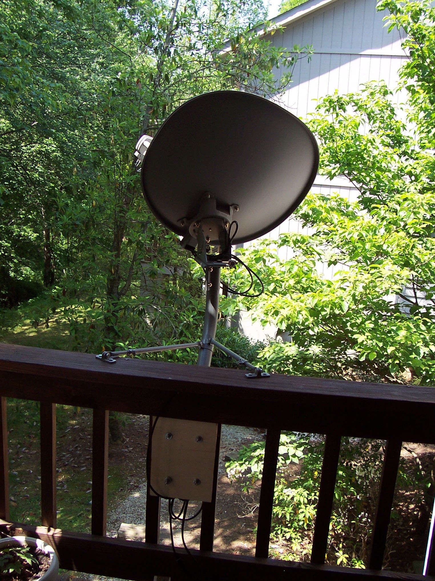

Here is my set up
