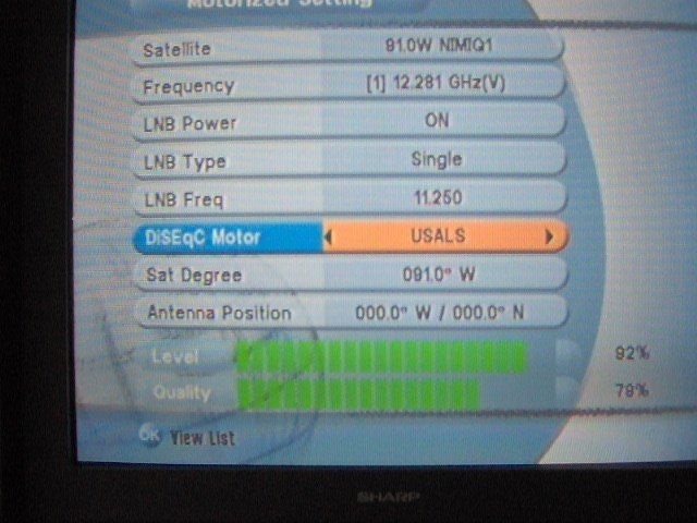

The Coolsat 5000 arrived today, and I've pulled the Traxis 2500 after moving to my true south satellite. My problem is that I don't understand how to set it up for USALS. diseq seems to work fine though.
How should I do this? True south is AMC9 (48342 zip).

Usually its done in the antenna setup screen under "Positioner"
Then you enter your Latitude and Longitude, and the longitude of your true south satellite store as your ref. position, and you are done.

go to the motorized section and select your true south. Enter your info at the bottom where it says antenna position
