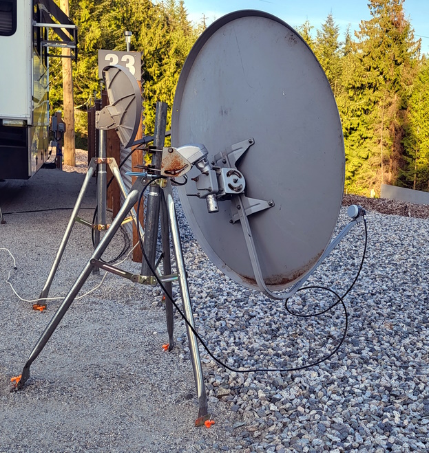

I have a built-in Winegard (I think) dish on my RV. It is designed for pay TV so it's small. It cranks up on the roof so it's very convenient. Problem is...when I park the RV in a typical campground, there always seem to be tree obstructions. So I've never used that built-in dish.
Much better is a short stand-alone tripod about 3-feet tall that I can position in the campground in the exact location that is best to see the satellites. I'm using a 1-metre dish (with a motor). I can receive every Ku satellite available on the arc from 139W to 67W. Without a motor, you could have the system up and running quickly. The motor is great but takes more knowledge and effort. I'm even playing with a C-band LNBF on it, but that's another story.
I also have a Shaw Direct 60e dish for pay TV on a separate tripod. That dish is even simpler to point.
