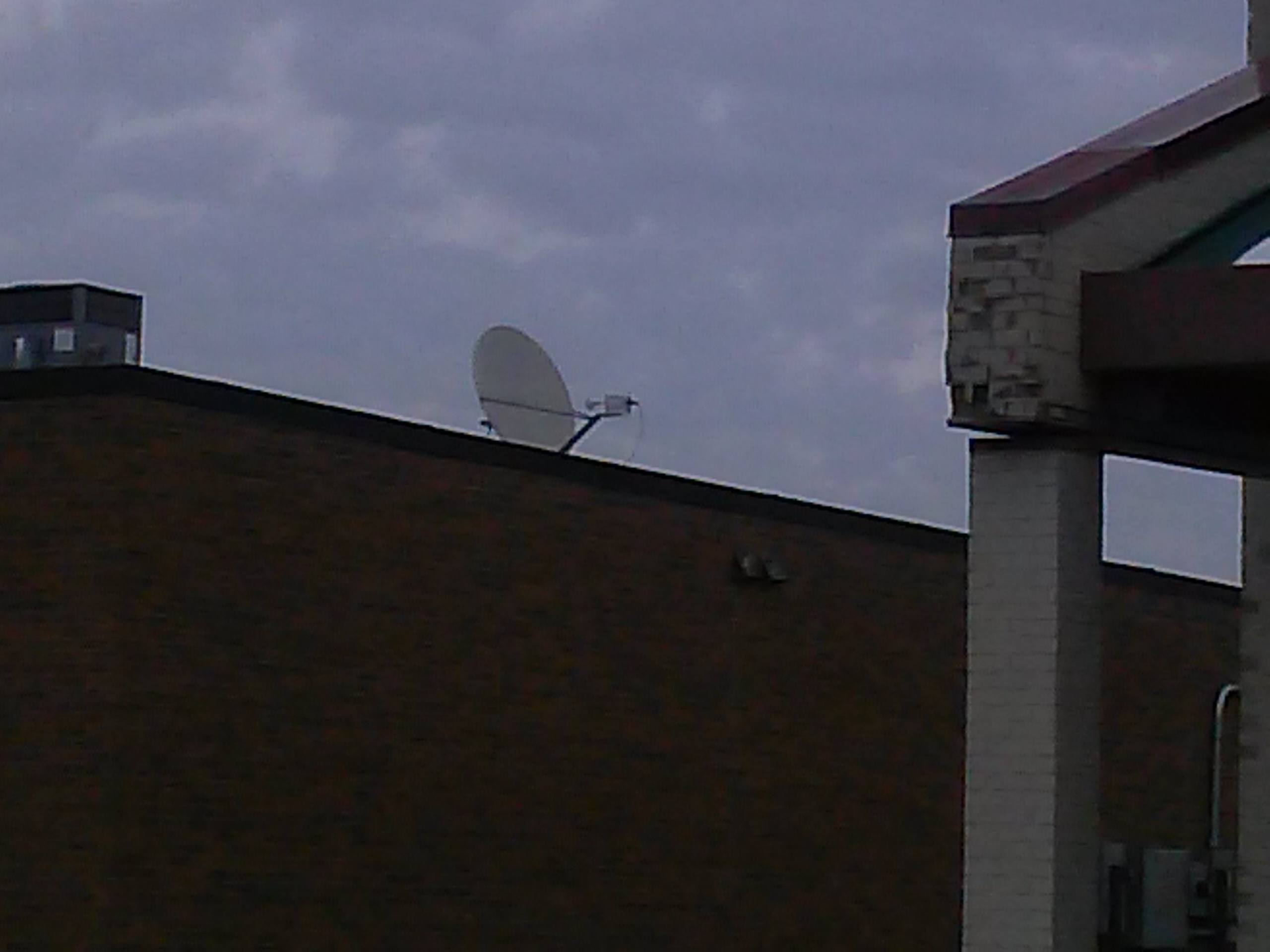

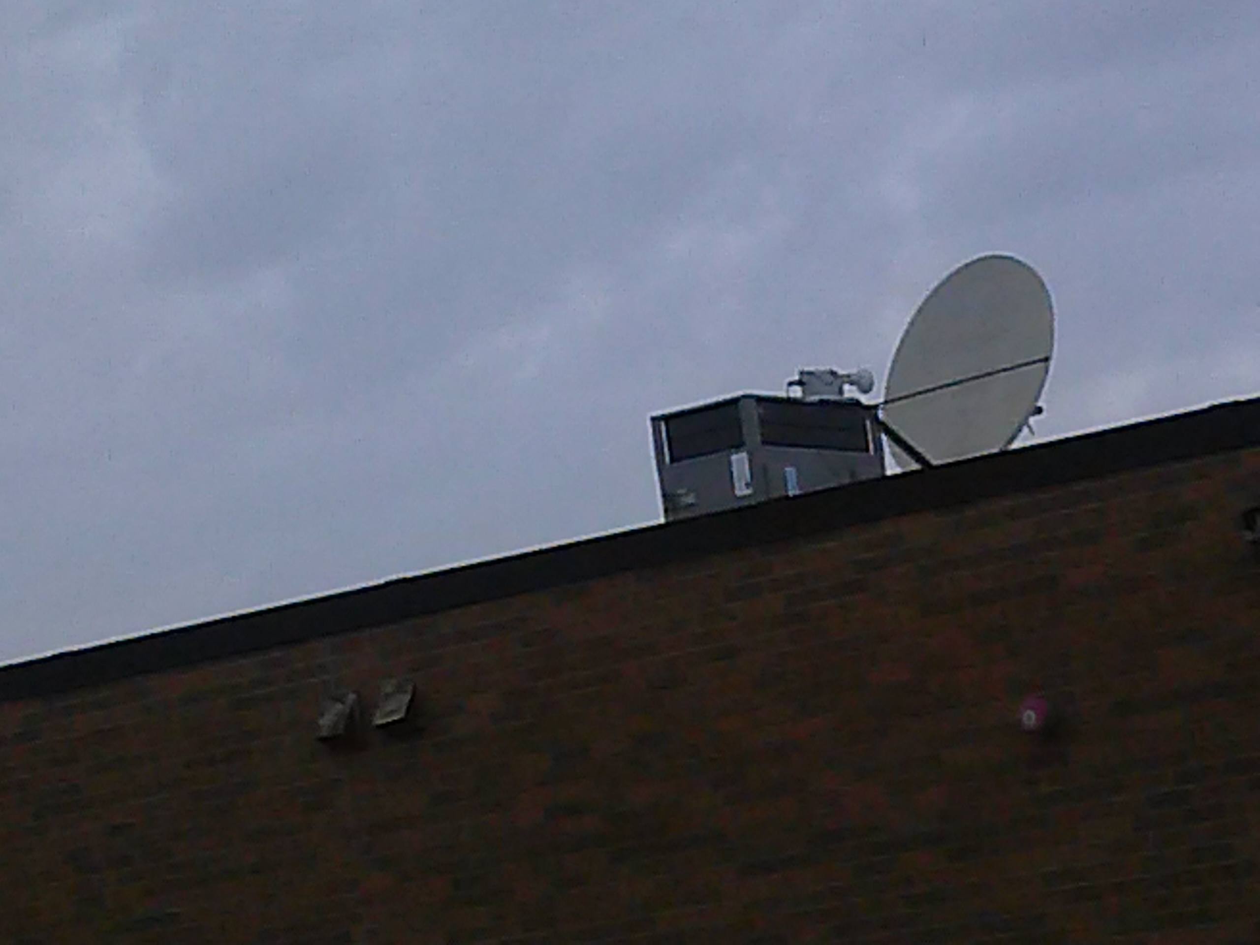

Does anyone know what dish/dishes that Aldi super market used/uses? I have one given to me, but waiting for contractor to take it down when he has time. Here are pix of it, best I could do. E_V
Hey, guys, I got it Saturday. Yes, it is a Prodelin series 1123, a 1.2m with an Atraxx NPRM, which is 6.5' by 6.5' square. Now to make a bracket to mount a proper lnb on it, be it Ku or C/band. E_V

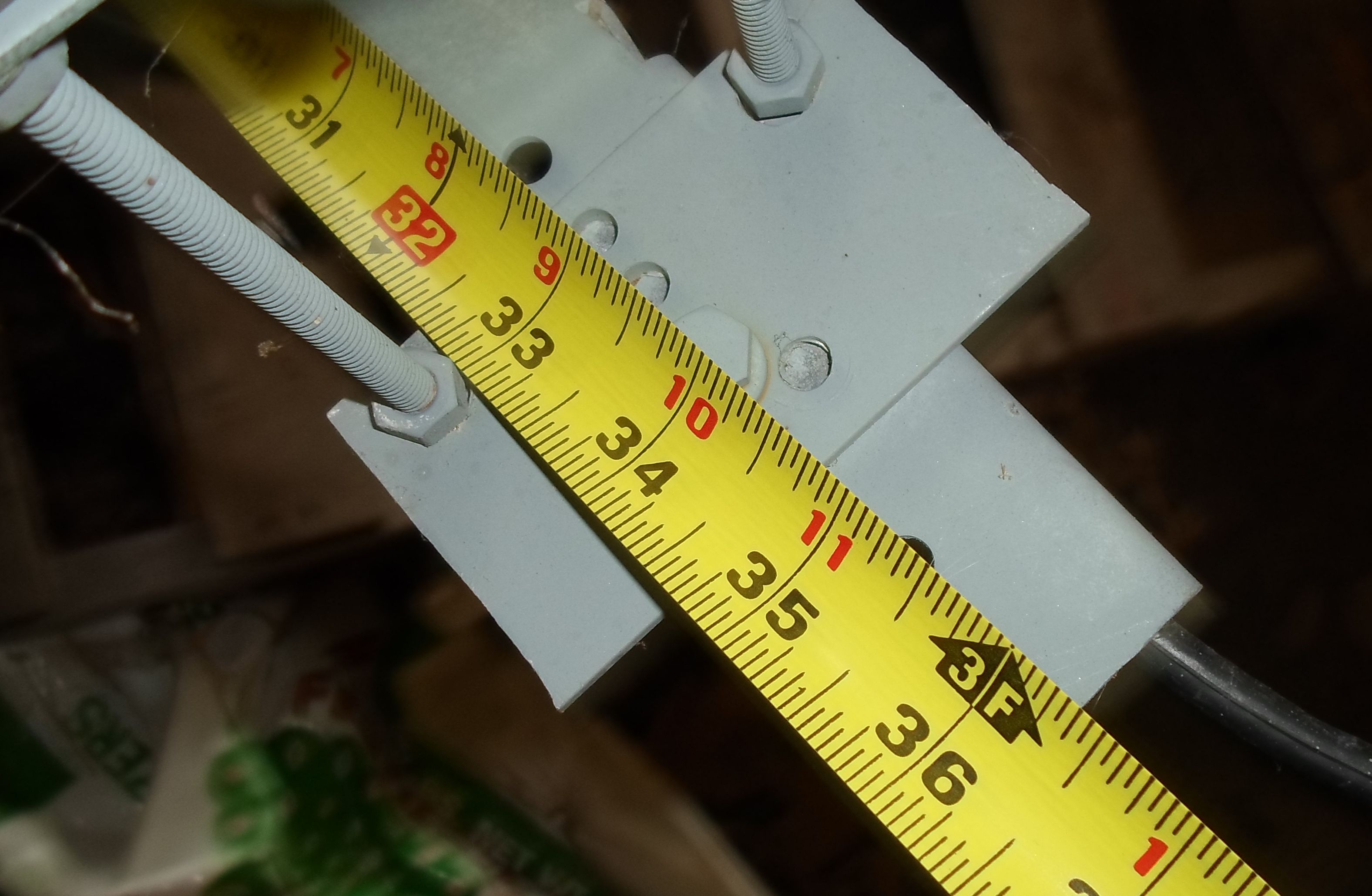

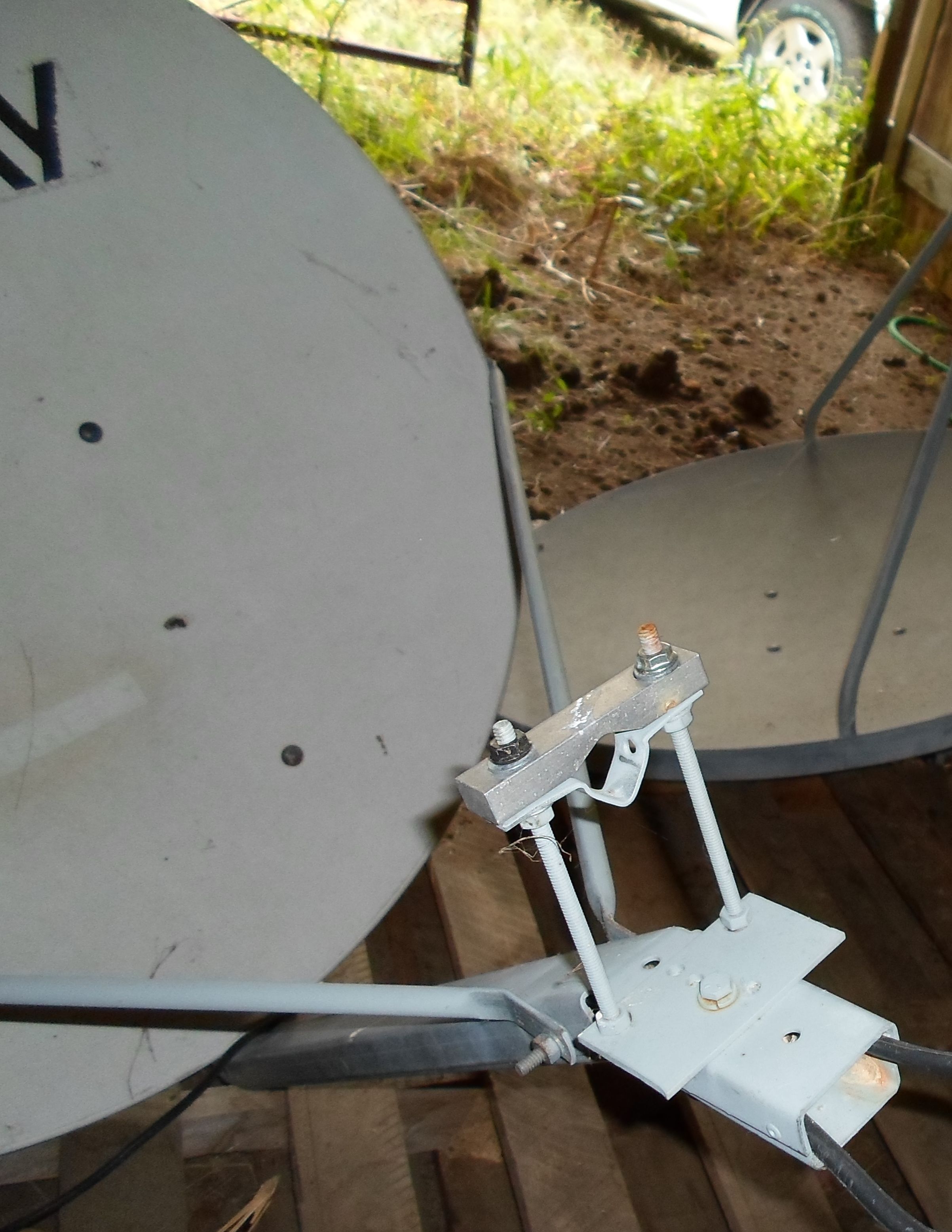

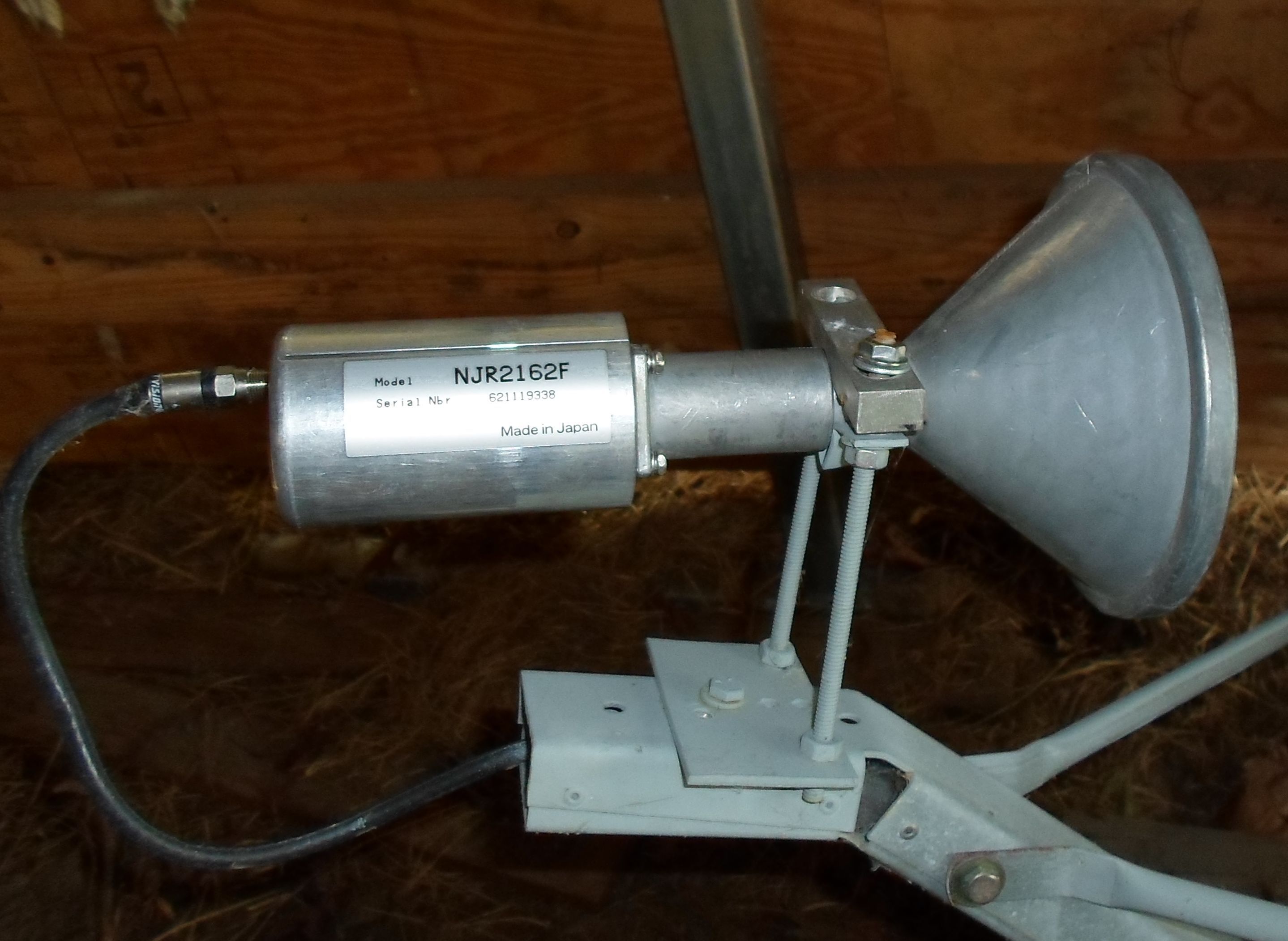

I have one very similar to yours - this is what I did for mounting an LNB. This dish is currently not in use, but is stored in my barn.. hence the dirt :(.. When I had it up and running the results were very impressive.
