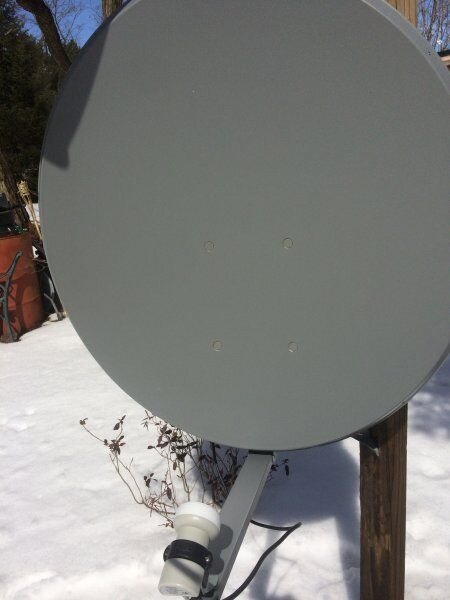

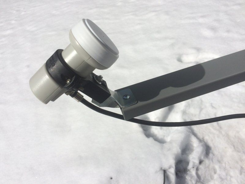

this is how i have it setup. and no this my first time getting into the ku band. after ku im going to try c band

I see it's a modified dish, is the LNB in the correct place and pointing to the right area of the dish. Placement is very precise -- a couple of centimeters can make a huge difference in the signal being received. Here's how the dish normally looks. See the LNB is pointing to the lower center of the dish. Is yours pointing to the same area?
Reactions: Titanium
For starters, the LNBF doesn't appear to be mounted correctly on the arm. If the new LNBF feedhorn is not set at the correct height, distance and angle to the reflector, it will have very poor or no reception.
Place the original LNBF back on the dish and make a template of the exact position and angle of the feedhorn cap. Install the bracket so the new LNBF feedhorn cap is at the same height, the same angle and the same distance to the reflector.

ok i will check the height and distance with the old lnb
Reactions: Martyn
ok i got it all setup now. i fix the height and distance which help the best and was way off lol. should i be using a dish that is fixed for ku band lnbs? does the ku band give program guide info?

If the LNB is in the correct place then that dish should work. But, as mentioned before, it needs to be in just the right place. Getting a fixed FTA dish would remove any problems you might have with LNB placement, but will also cost you money. Before investing in another dish, I'd try to get this one going.
If you think the LNB is in the correct place, your next job is to aim the dish.
Using dishpointer, get the dish pointing in approximately the right direction then, standing at the dish, move it *slowly* from side to side looking for a signal. If you get nothing, move it a tad up or down and do another sweep. Rinse and repeat. If you are slow enough and careful enough, eventually your signal meter should detect a signal. It might not be 103W, but once you're on one satellite, it's much easier to move across the arc to others.
