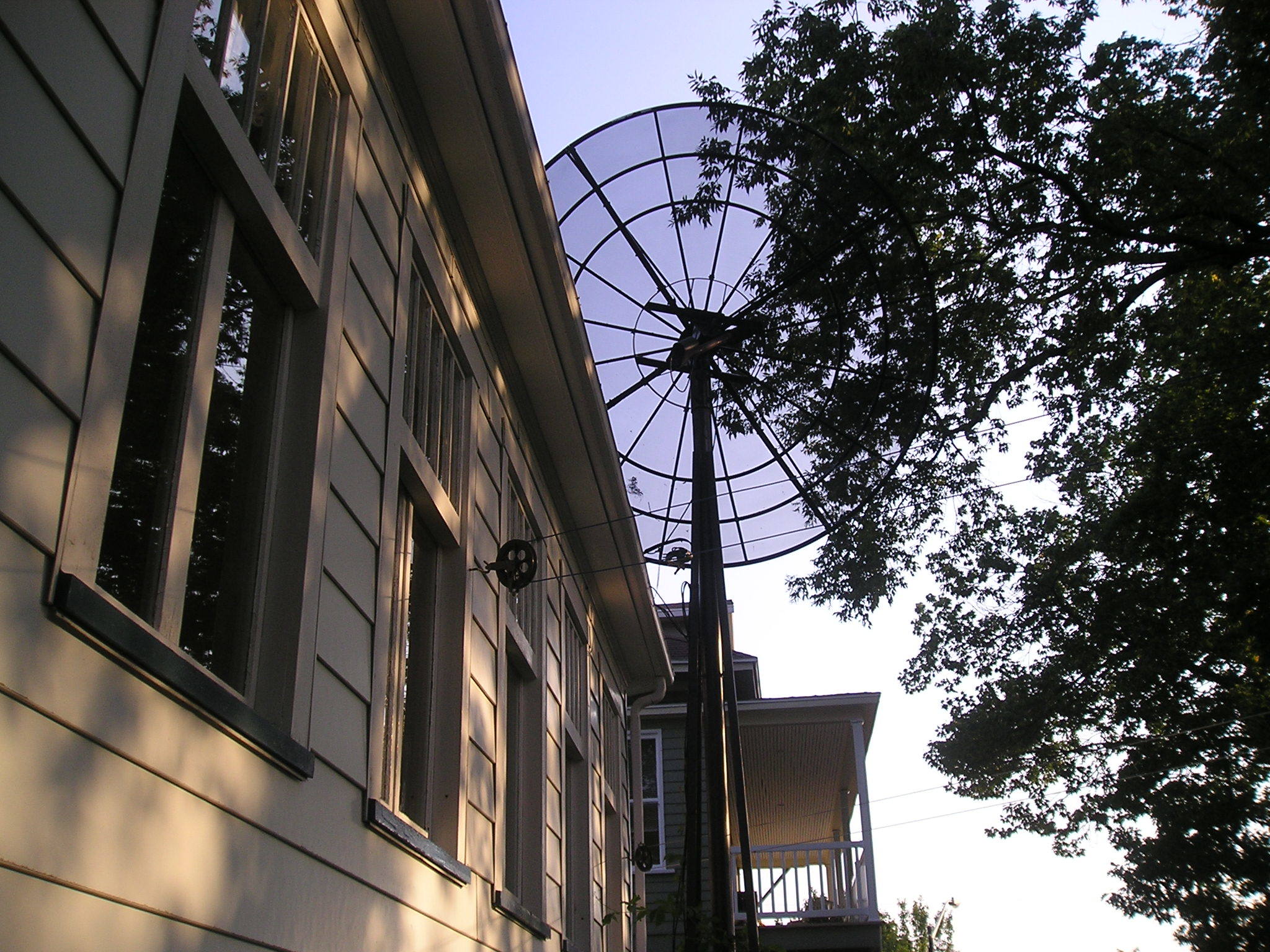

Here I can receive the H signals from PBS, but Montana PBS hardly watchable; not been able yet to get the V ones, maybe it is because of the leaves blocking my view (see pic).
