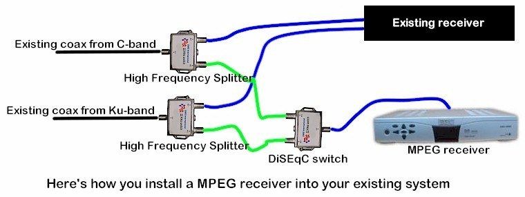

you will have to slave the viewsat off the 922. use a dc block splitter and use the 922 to control polarity. if you need more info... search the forums as there are tons of posts on how to do this.
crackt out,.
heres how mine is setup off of the 922.
I have mine stup so the dc pass goes to the 922 it controls the power to the lnb and the polarity. the dc block side then goes to the diseqc switch then to the sathawk pvr 800.
