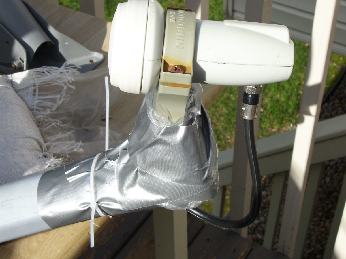

got bored yesterday so I monkeyed around on the system (huh imagine that)

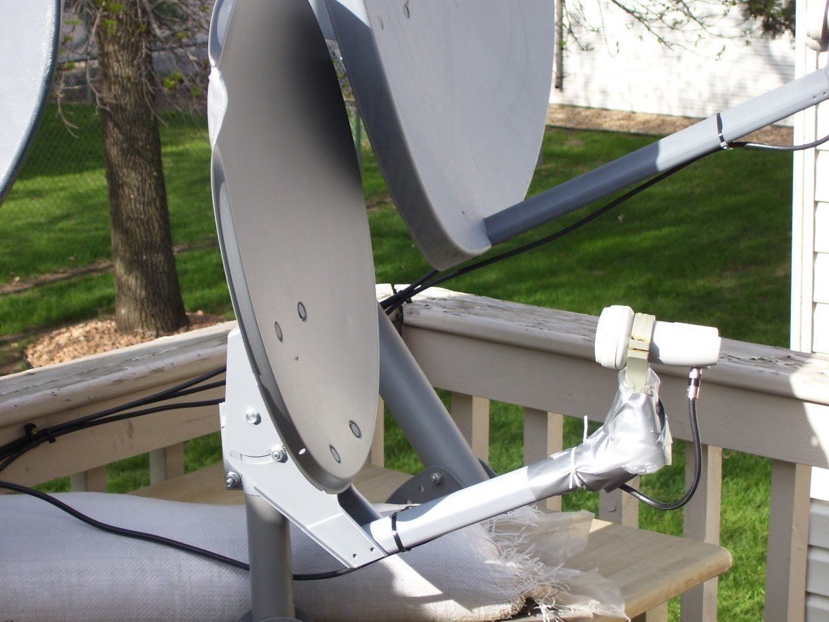

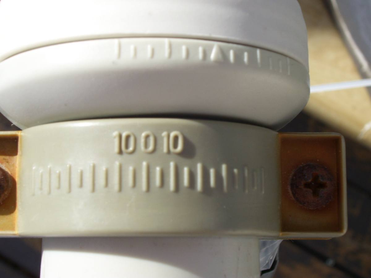

Added a LNB for 110 on the Glorystar system....that left a 18" dish sitting there lonely. Thought "61.5?" then I realized after the C-Band multiswitch issue that left an open port on my Visionsat setup. Thought "maybe 72?" just for a couple channels...but on a 18" and enough signal? Huh, lets see

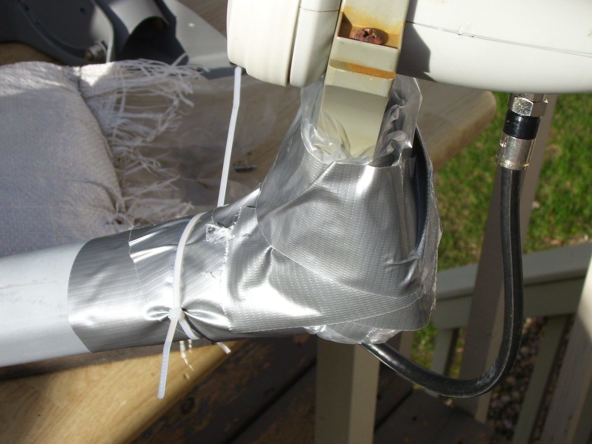

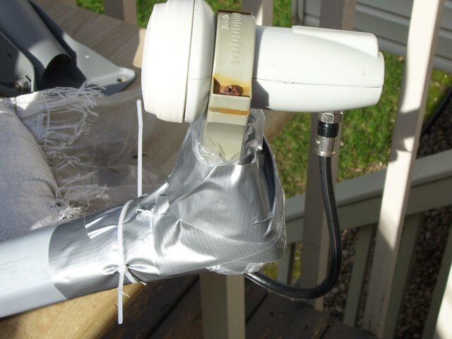

Got the dish info from thelist and grabbed my old KU LNB holder for a 18" dish (I got this a while back from someone. They had it when ExpressVu was KU Band). Well part of it is broke so we got everything set up and duct taped the hell out of the bracket onto the dish.
Skew is very critical so set to -20 which is what it should be and swung dish to vicinity...BAM 40 quality..
tweaked it and have 65-70 on the active transponders out there. Put some plastic around the duct tape and then duct taped that too to keep from the bottom stuff getting wet :)
so if you have a 18" or Phase II laying around and want to use it...try 72W...strong beam :)

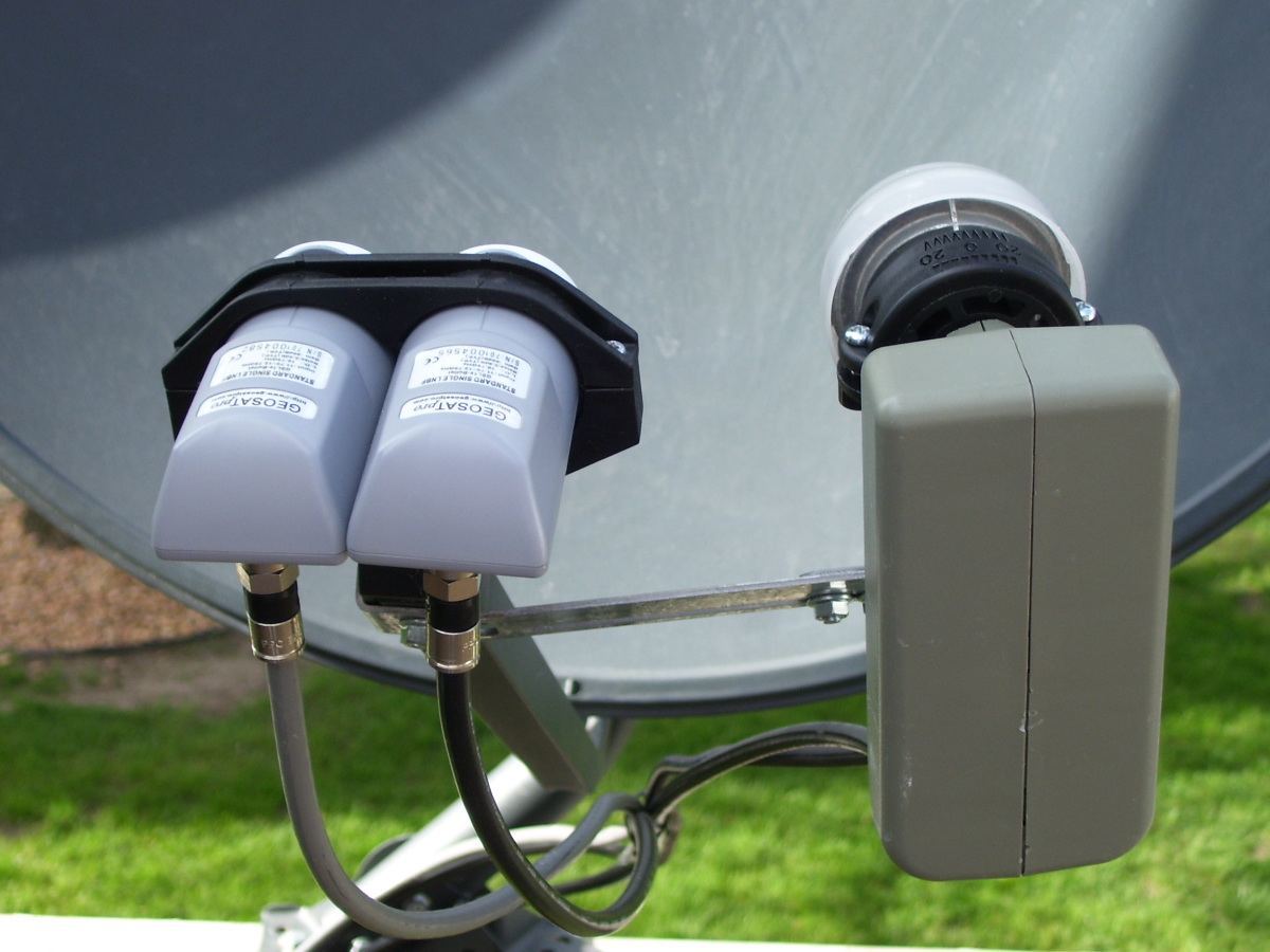

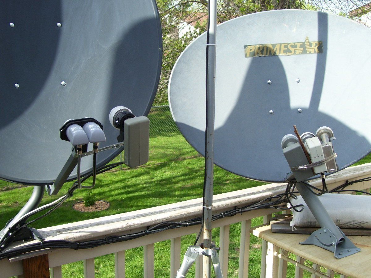

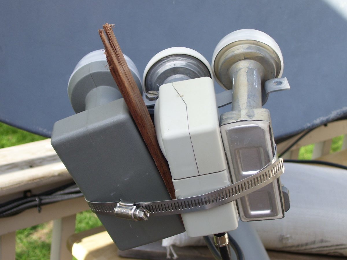

yes the dish is bent there at the corner. That was so I could get the Primestar at 123 and the D300 at 110...also are pics of Primestar with 119/123/129 and Glorystar with 97/101/110

skew is the most critical honestly. I put it to 20 and got the elevation to what it should be and went in the general area. Since I have the P* dish at 74W I knew approx where to aim.
I got more than 5 off skew and quality plummeted
