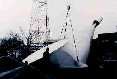

Maybe we all should buy one of these to receive Shepherds Chapel? :D
http://www.afcsat.com/SatelliteConicalHorn.html
