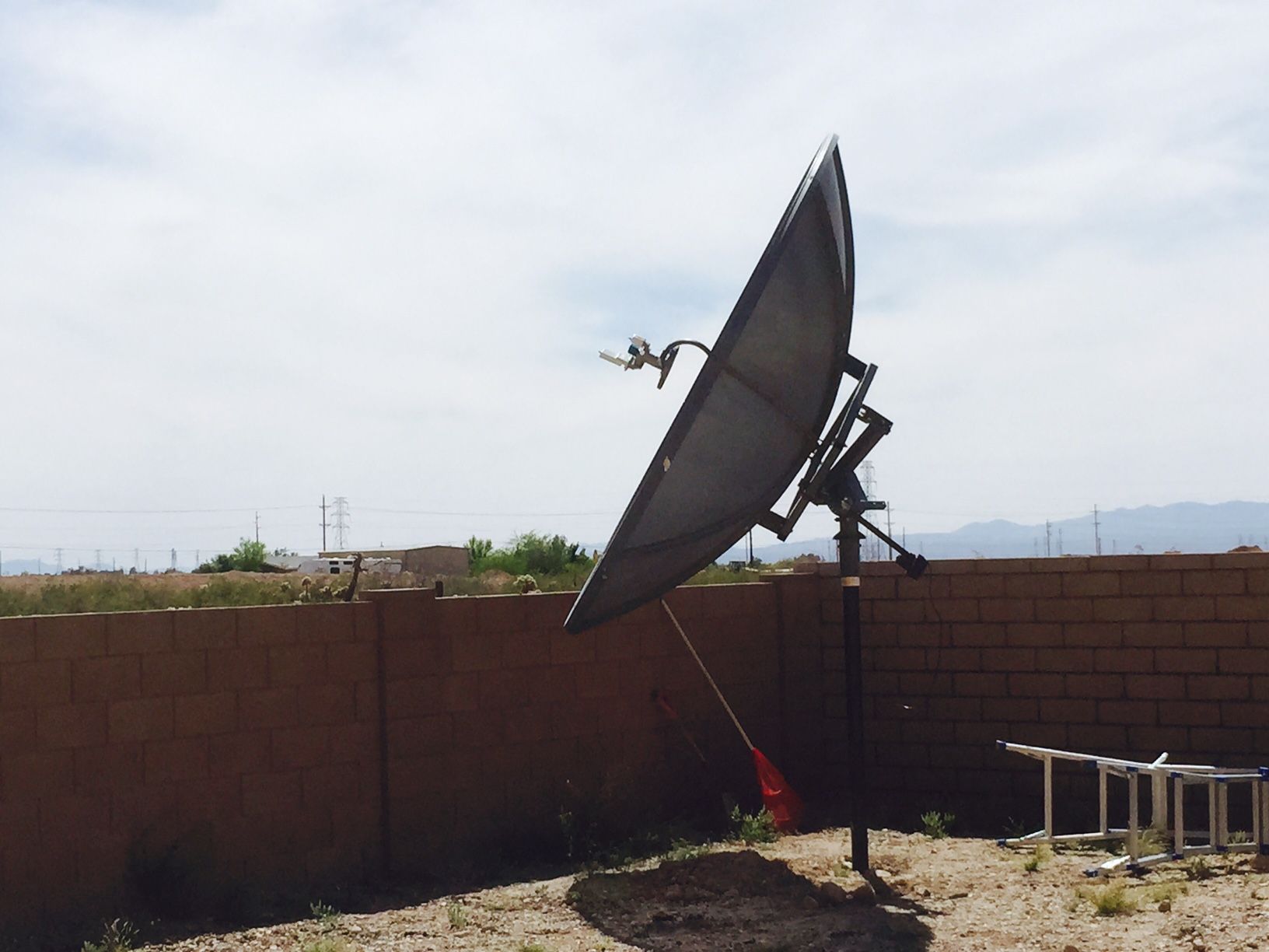

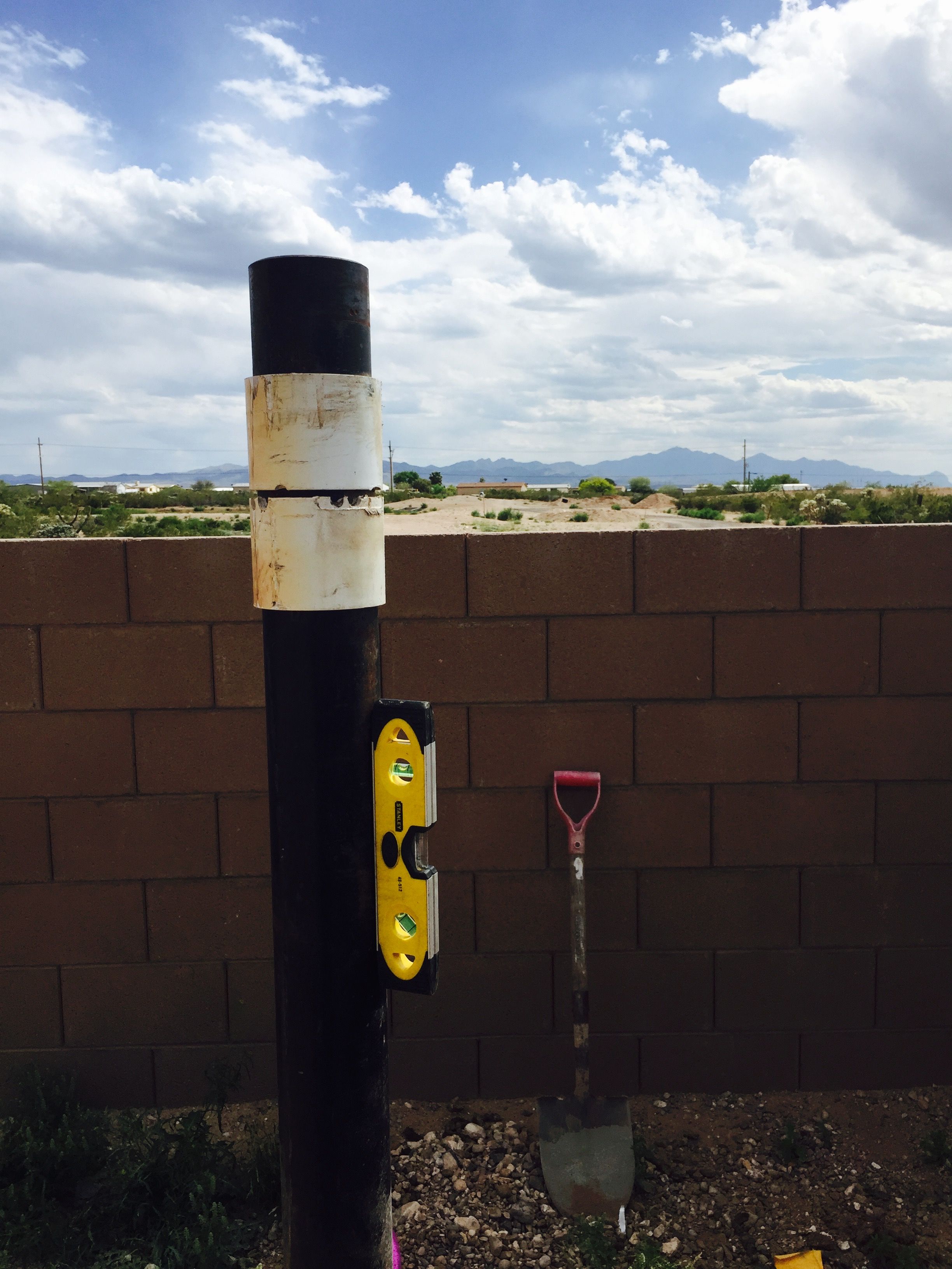

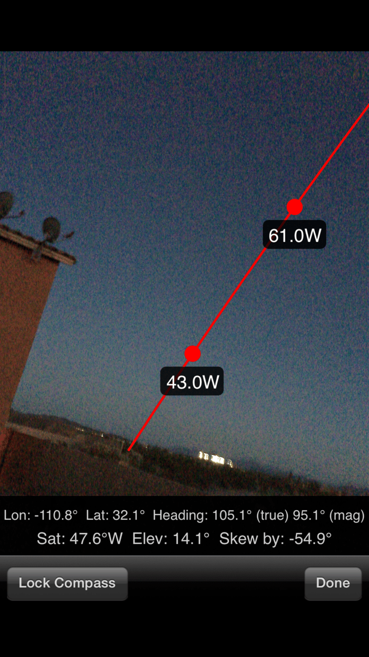

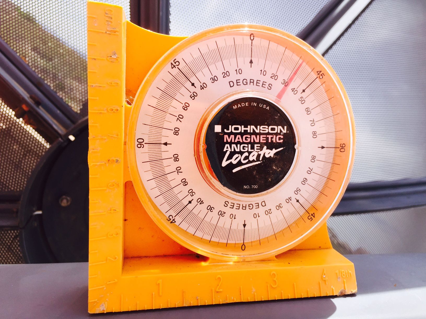

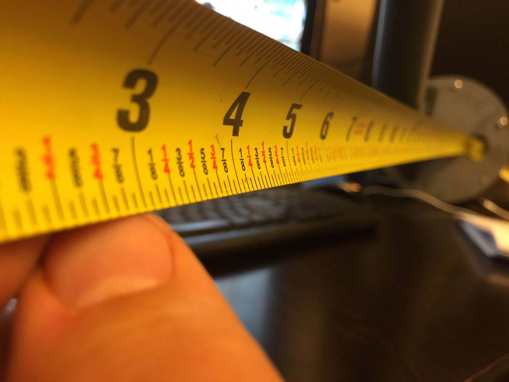

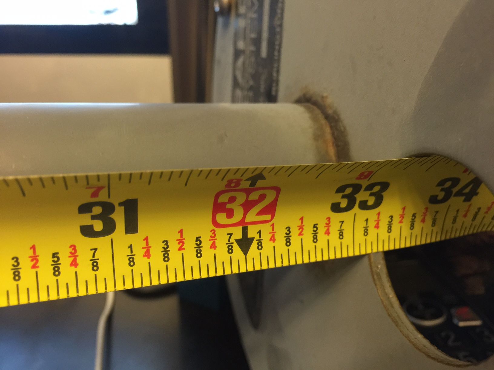

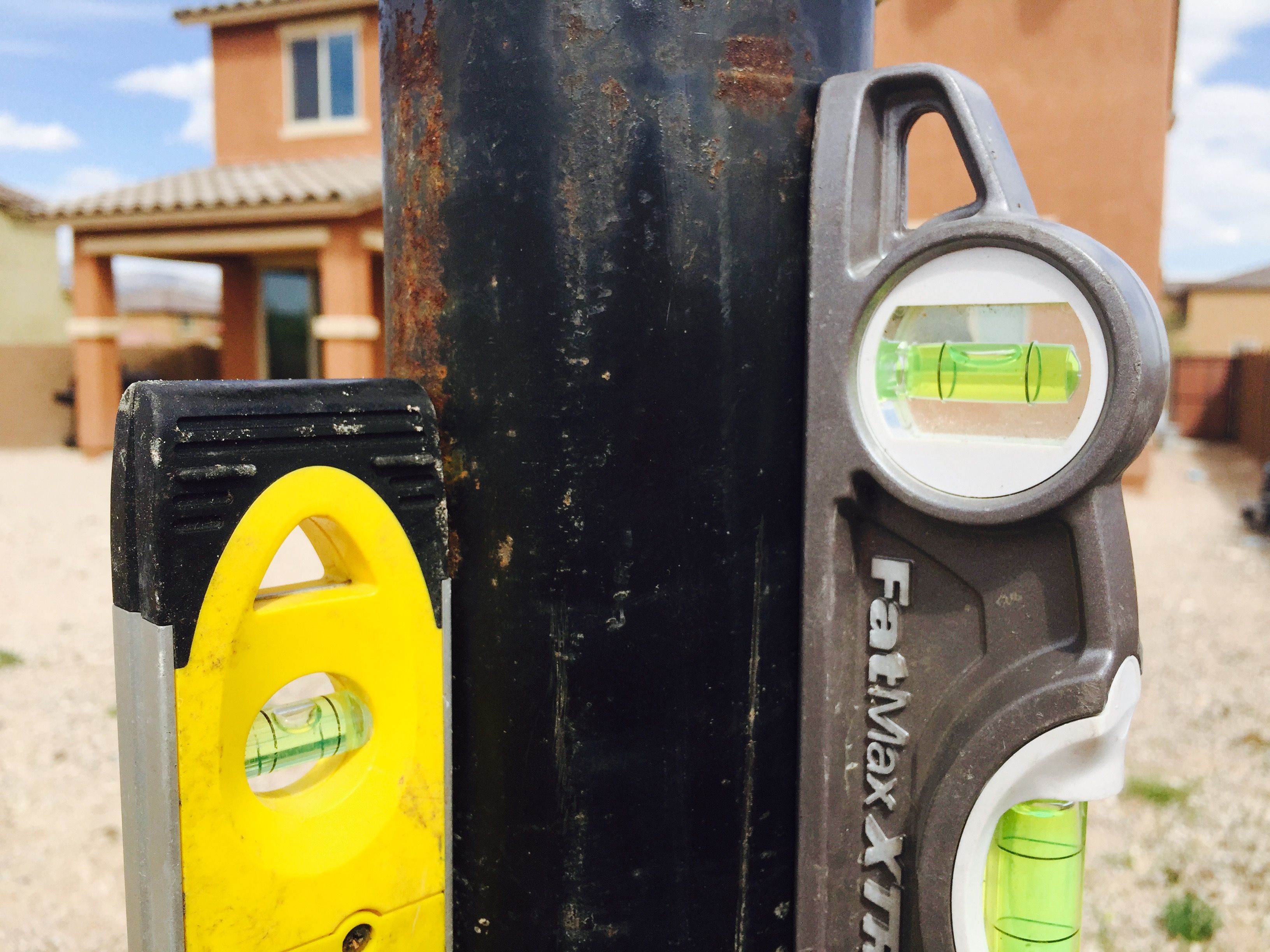

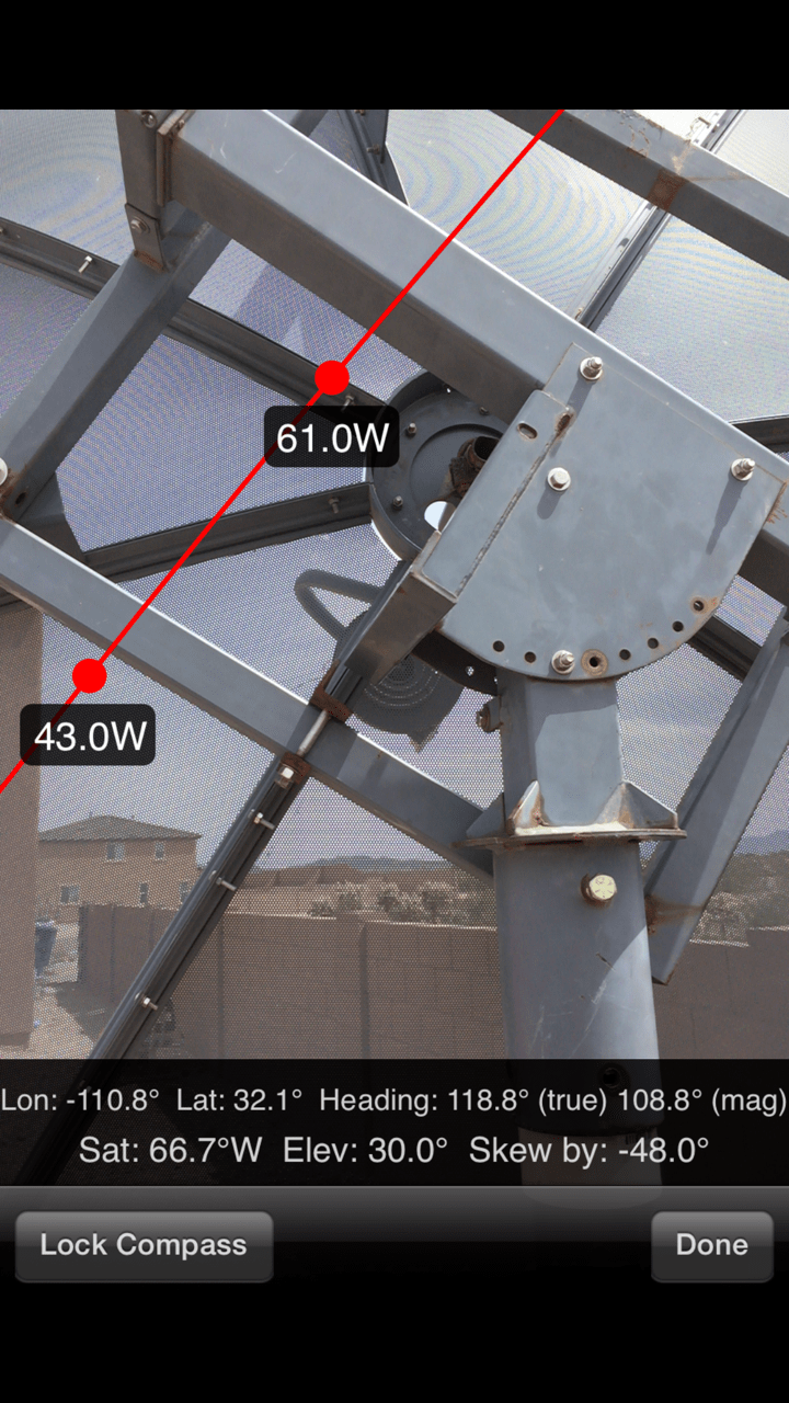

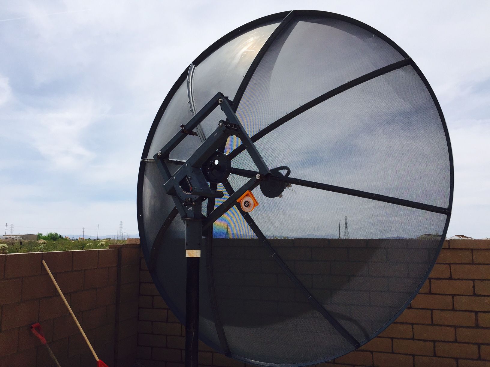

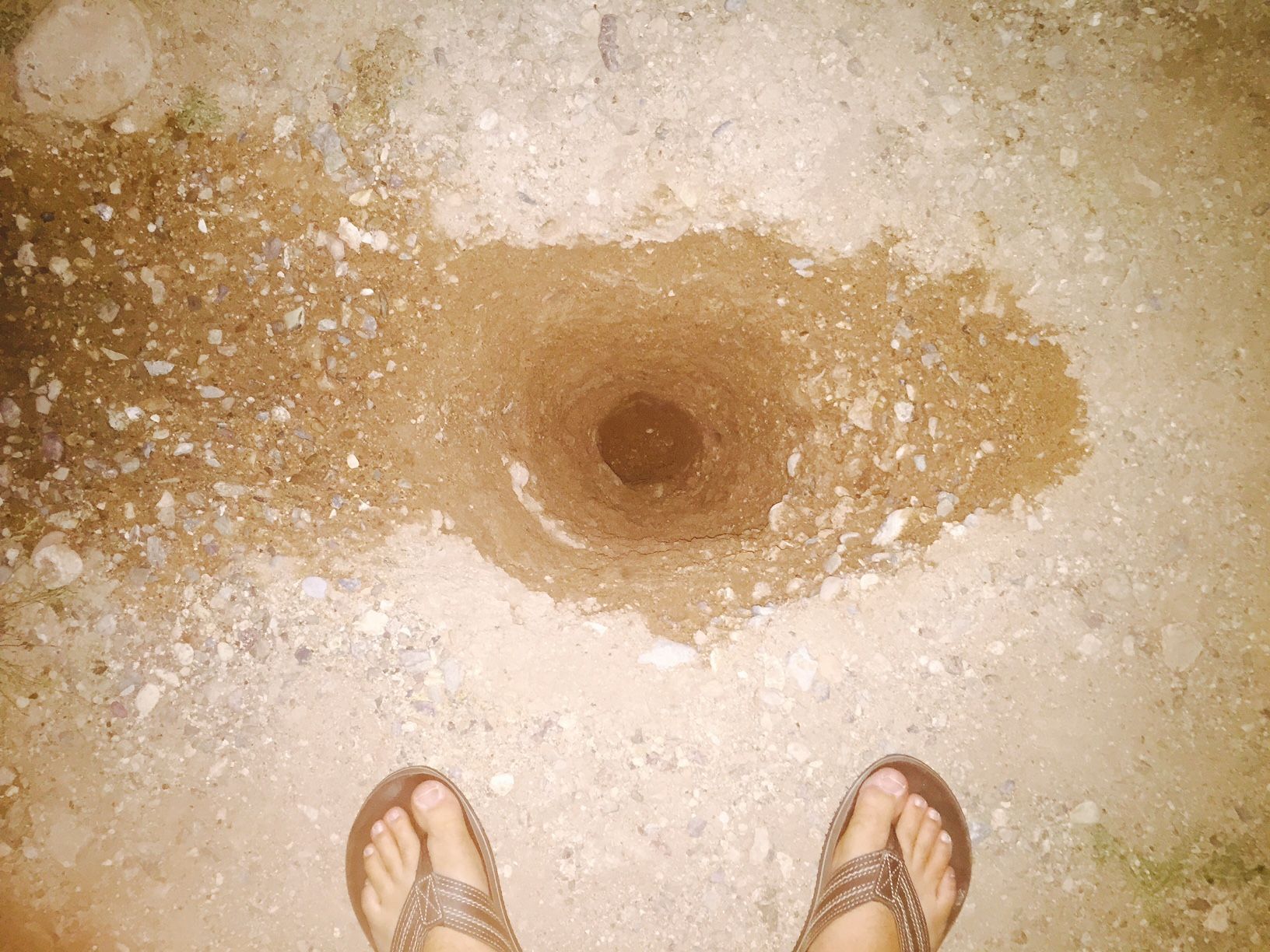

So I finally got my Cband setup this weekend going. (10 foot Pinnacle) After getting HOA approval. I will post lots of pictures. So far its been straight forward. I quick created the pole last week with 3 80 lbs bags of quick crete. The pole is about 5 feet into the ground and is in solid footing. Attached the reflectors together this week making sure they snapped into place as well as screwing them. I set the elevation and declination levels on the latitude head, then attached the buttonhook to the reflector. I also set the LNB 33 and 3/16th's per manual. I split the difference as I have a Chaparral feed horn with no golden ring. I will adjust when I tune it up later on in the week. I then attached the latitude head to the pole and then the reflector. Once that was all settled, I began the process of wiring and ran out of time tonight. Wireing is going to be the easy part. In the next few days I will have to get this guy on the ARC and I should be good to go. It wasn't too bad putting it up. Just heavy.

One more thing is I have to thank Magic Static. Without his help this dish would have never gotten off the ground. A big thank you! So now that it's up I have to plant some trees to camouflage it in to make the HOA happy and paint it a tan color to match either the desert or the house. I also am running all of the wiring through PVC pipe and putting the pipe underground.

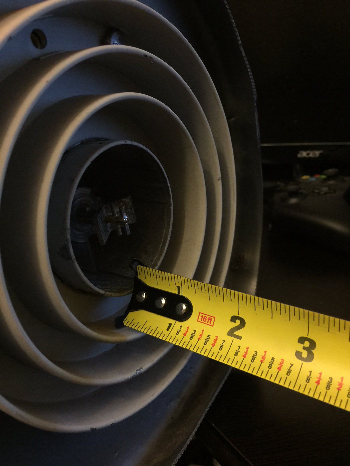

Nice!! But it looks like you need to make a big adjustment on the scalar ring. At the desired F/D length the feed horn should protrude from the scalar almost 1 1/2" for the deep dish .278 F/D ratio. The way it is right now you won't see half of the dish. This is according to the information on the Chaparral site. Pendragon discusses this here http://www.satelliteguys.us/xen/threads/dual-orthomode-feed-on-a-deep-dish-mod.171565/
Congrats on getting your dish set up! :)
Yes the scaler ring to feed horn adjustment is important to getting the best signal to noise ratio from your particular dish/feedhorn combination. The settings that are calculated using your dish focal distance and ratio is the best place to start. Takes a lot of time and patience to get the setting dead-on, as each time you change your feed horn position inside the scaler, you have to re-position the scaler to maximize signal again; that is to keep the feedhorn at the focal point. If your initial setting seems to work good, try it out for a while. Eventually you might want to peak certain signals that are right on the reception edge, this is where fine-tuning will gain you an extra couple of dB to pick up those signals more reliably. It's easy to get carried away with fine-tuning these and other settings... and spend hours (and even days) of playing around with the different adjustments just to capture that extra 1dB...

-making sure your feedhorn is PERFECTLY centered over the dish and at the focal point (As close as you can possibly get it!)
-making sure the pole stays perfectly plumb at center and each end of the arc

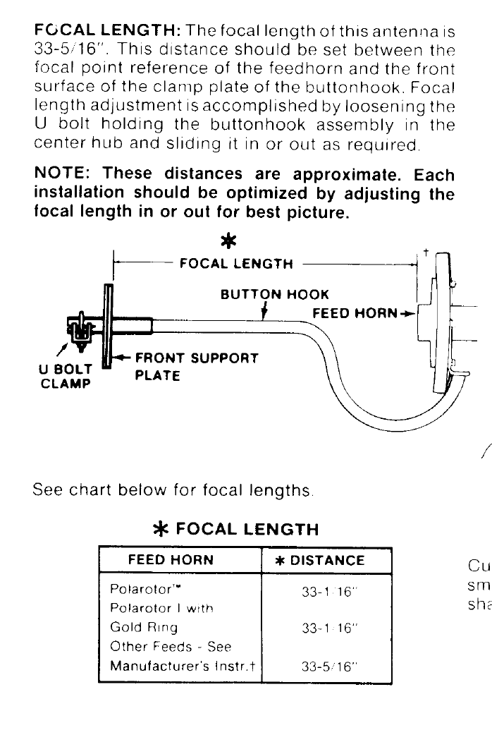

This is where I am confused because in Winegards manual for the dish it says to set it at 33 1/16. When I do that the feedhorn is way in. (like pictured) I think I may have to adjust the length of the button hook and re adjust for 33 1/3 to get that feedhorn to pop out a bit like its suppost to be. The Feedhorn hasn't been adjusted since I originally picked up the dish seven years ago.

Exactly. The button hook needs to be lengthened. I found on my Bullseye II I had to shorten the focal length for optimum performance on the Ku side. But with your Corotor the KU is a little different.

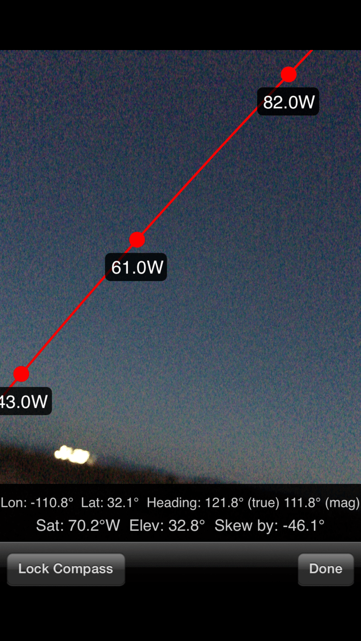

Thanks to everyone on the congrats with the setup! So far so good. I was able to point over at 125. Remember I haven't officially even tuned this to see if I am on the arch. I actually think I am going to leave the LNB where it is. I was able to tune in TBN, Evine and most of the encrypted services over on Gal14. The encrypted S2 services I was maxed out at 100 percent quality. with TBN in the high 80's to high 90's. On the KU side I was able to pull in PBS off of AMC21 and I was in the high 80's for quality there. (This is on an AZ Box Premium) I am very happy to see that both KU and Cband sides are working. The ASC1 has been working well so far. The only issue I am running into is that it seems like the Cband side is bleeding over on the switch. This may be a switch issue. This is the switch I am using. http://www.ebay.com/itm/NEW-RadioSh...5653ae&pid=100204&rk=4&rkt=29&sd=141522294869
I am wondering if maybe I need to change out this switch. Over all so far so good. I just need to hook up a spec anny to it and figure out where I am. The sad part is I left my poor man's spec anny at work and need to grab that.
