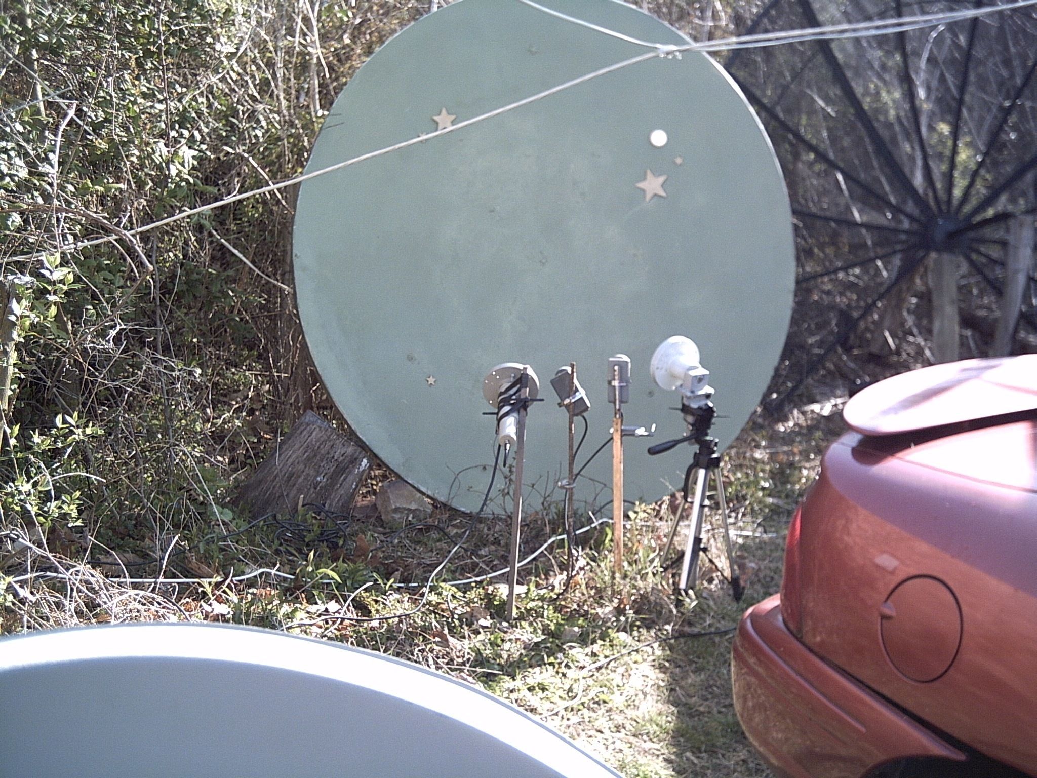

I have an offset Ku solid 2.4 m 110 volt dish that is set
in fixed position facing south -- roughly toward 100 deg. W.
From left to right I have lnbfs stuck in ground on poles/rods
and secured with clamps: BSC 621 -2 C band receiving G99C with good signal on most transponders; 0.4 db Ku getting 101 Ku all channels; and 0.5 db Ku receiving all channels. Now I'd like to watch A Channel Halifax on F1RC
at 107 W. Hooked up a Chapparal feed w scalar rings and
a Chaparral 20 degree noise Hemt lnb and get 80 per cent
level but 0 quality when moving the feed around slightly to the right of the 103 deg lnb. I can adjust polarity by manually turning the plastic rotator that is made to connect to a polarotor servo. Have tried setting receiver to 4 or 5
different transponders some H some V with no luck, and moving the feed in and out, left and right with the probe in various positions. Does anyone have any suggestions?

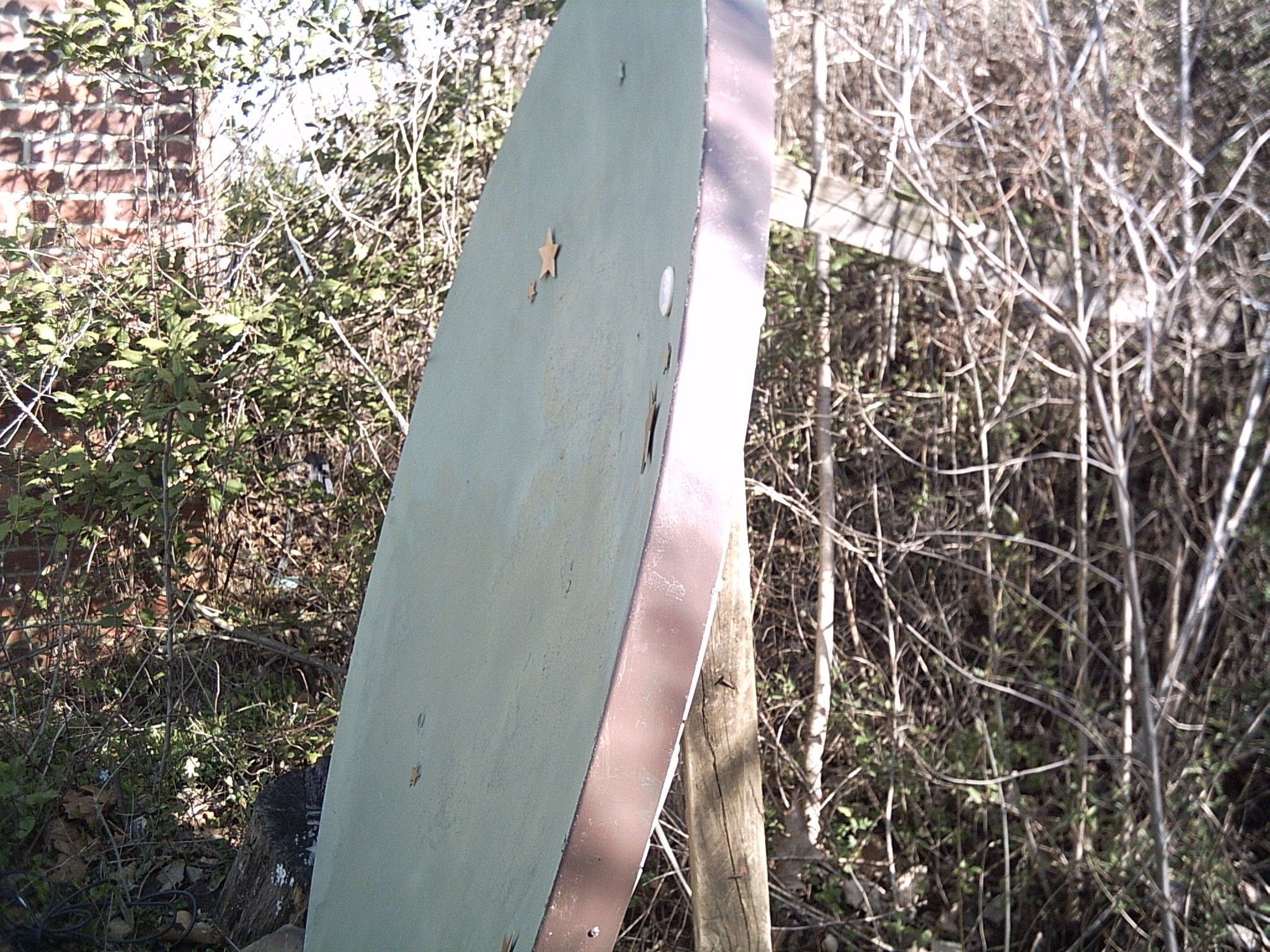

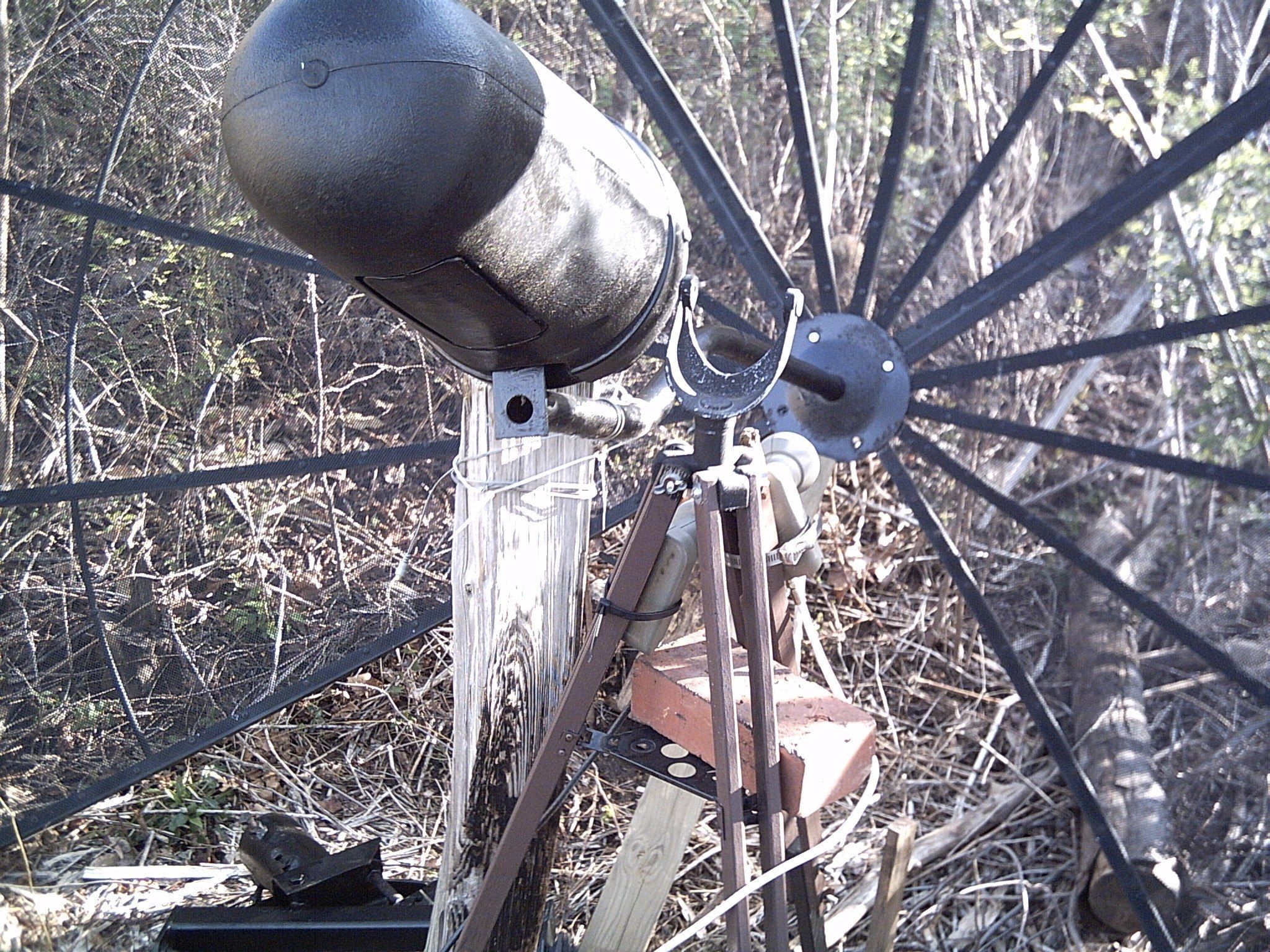

Just got a free Dish Pro dish with 3 lnbfs, one was a Band Stacked FSS unit that I plan to use for PBS on 125 W Ku using 3/4 of a 10 foot center focus mesh -- one panel missing. I get G 18 Equity channels with this setup, though for how long, who knows? Here are pictures of dishes, etc.
Looking at pic #4 I see you have taken the servo motor off and the plastic probe coupler has backed out of the feed housing a bit. I would push it back in and put a piece of tape over it to keep it in place. When tweaking my 1.2 meter AMC 8 dish I did the same thing since I needed only one polarity. Mine backed out like that and when I pushed it back in it brought the quality up 2 or 3 Q's...made a difference.
fafhrd2, glad to see another person close to me here in WV!
Iceberg: damn...that 2nd pic is pretty "ghetto"... :D
I agree with Iceberg that is GREAT! Just when you saw it all man! Great job on the rigging! Nice Pictures! Just thought I would buzz in off subject for a sec to say :welcome to The Satellite Guys!
