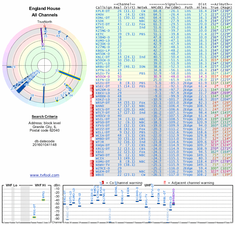

Here is the TV Fool report:
I would not use a preamp at first. A preamp is used to boost distant signals.
You may be too close to some towers for that, as that could degrade your signal.
I usually install the antenna, then hook it to a single TV, adjust, aim and fiddle for best overall signal.
I bring a TV to the antenna and watch the signal meter.
Depending on the lengths of the runs in your house, and losses, a distribution amplifier may be needed.
It is used just like a splitter but also boosts the signals slightly to overcome any losses incurred in distributing the signal
throughout the home.

Yeap, as others have said, you'll be fine. You're close and most are in the same direction, within a few degrees of each other.
