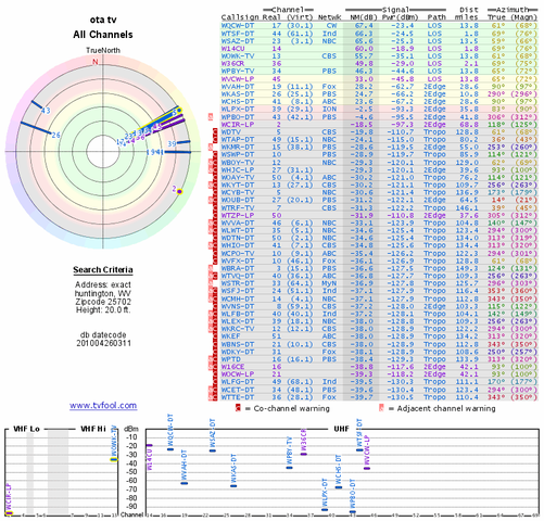

problem is i can't lock 33.1-3 that is our local pbs that is in the same direction.
Nothing i do changes it.
I don't think that an antenna replacement will help.
The problem could be preamp overload. Have you tried receiving PBS with just the antenna? To do so you must remove the preamp from the circuit, unplugging the preamp doesn't bypass the amplifier.
The source of the overload might be FM stations. An antenna that can't receive FM might fix the problem. In your case the best antenna is a wide beam UHF antenna that can also receive high band VHF. The Channel Master 4221 is one such antenna. The Winegard HD-1080 is another.
I Removed the preamplifier and connected the cables with a barrel connector...still no go.
I thought of fm since the signal from our local 103.3 fm is stupid strong in that area and that UHF/Vhf/ antenna may be loading the signal with fm harmonics from the radio station. I will try a UHF only antenna. I have an FM trap I can try.
I suspect that 103.3 is mixing with TV channel 17 making a third order intermod on channel 34. Eliminating 103.3 with either a filter or a UHF antenna has a good chance of working.
