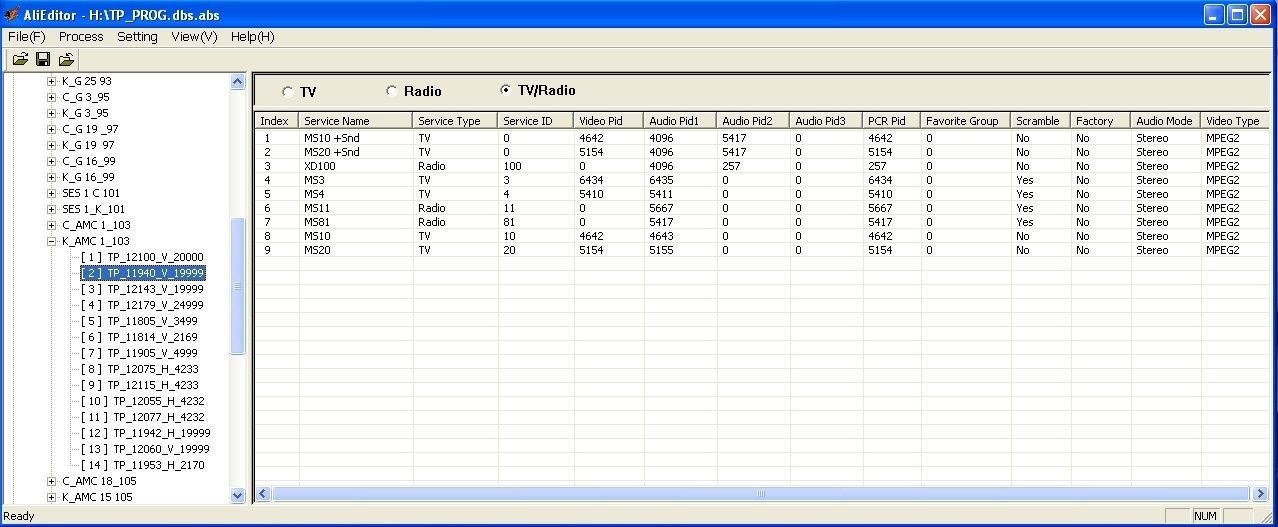

Not sure what's happening there. here's a screengrab of the editor showing the channels I added. (top 2 lines)
No need to add the 2nd audio PID, doesn't work.

Looks just like mine except the 2nd audio and the service ID. Yours are zero/zero. I will try that as soon as the news is over.
RT.
It's the service ID. Not the second audio pid. If you scan the sat and the added channels have the broadcast service ID that is broadcast, it will correct itself to the PIDS that are broadcast.
Yes. Set mine to zero and the music has been running for 15 minutes now. Nice to look at the waves, the sun setting, and now the music. Just wish the camera had zoom to check on the beach dollies!:cool::):D
