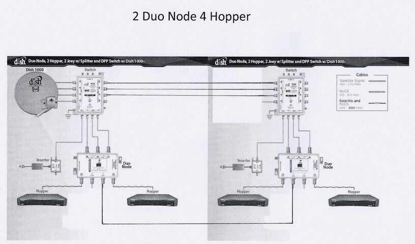

I wonder if a 4 Hopper setup like this would work and allow all four Hoppers to see each other.
I was wondering if more than two could work just not sure if the nodes will allow the Moca between each other
Will not work. Each hopper uses four of eight available MOCA channels. That interconnect would knock everything out.
