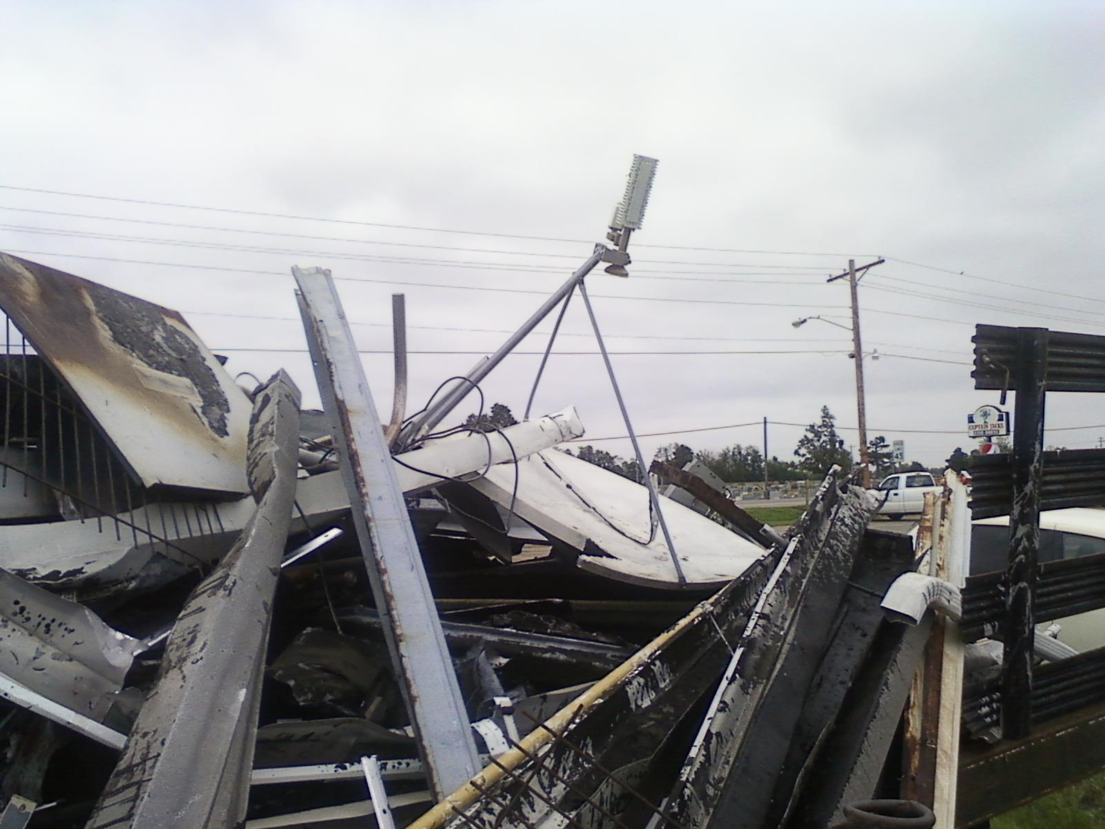

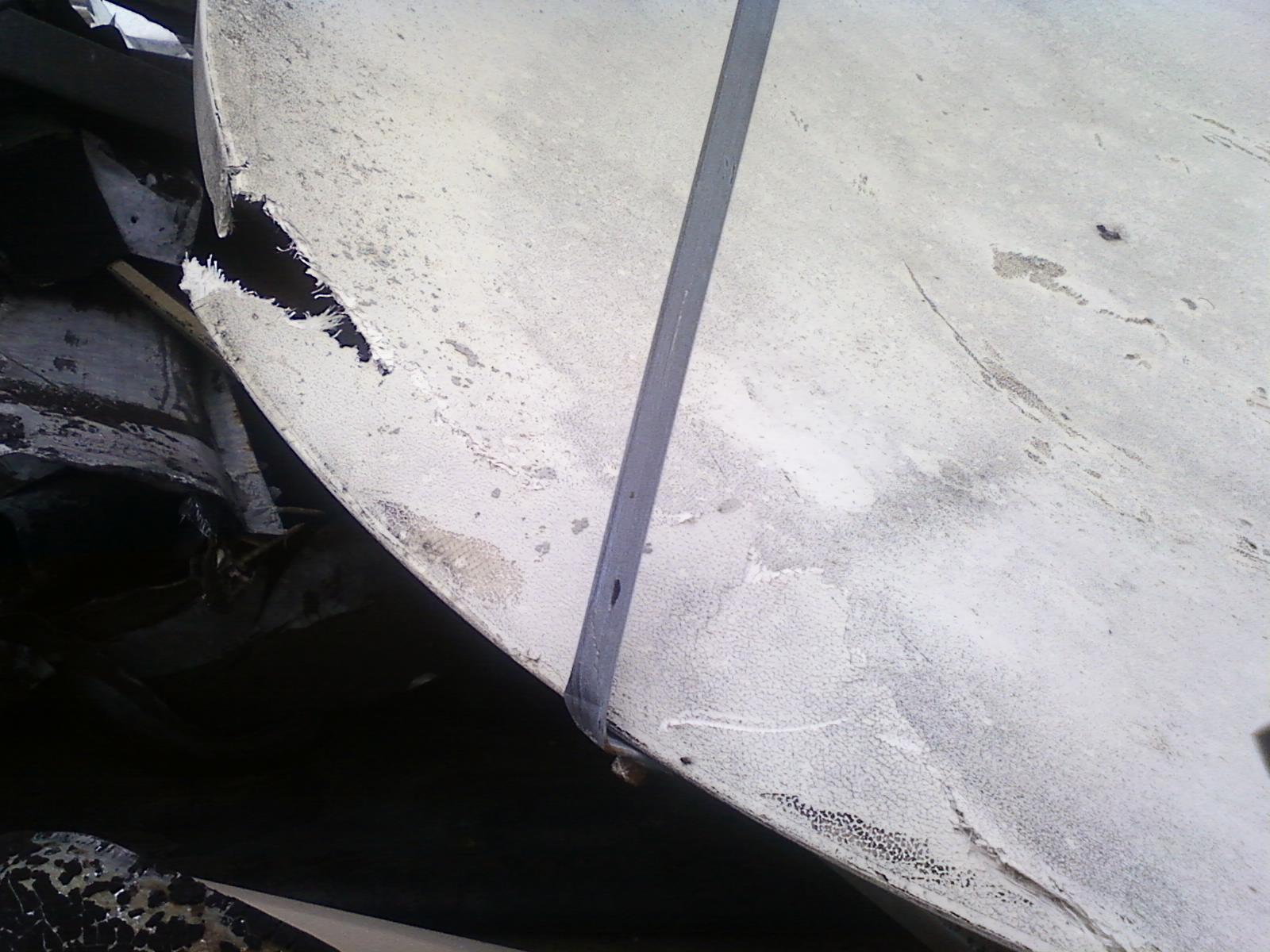

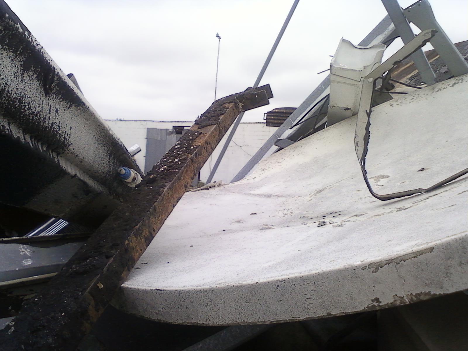

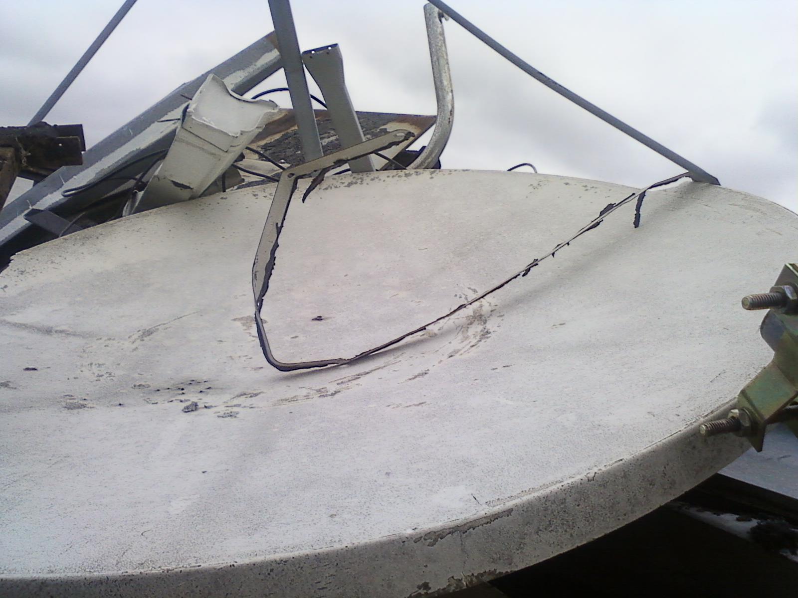

I saw this dish today and was wondering if there is any hope for it? How can I repair the torn edges if possible?
Run away, don't walk.....
Many more opportunities for a free dish out there that will only require a strong back and a scrub brush!
Pull the feed horn and BUC for a future project.
Can't tell if it's a 4' or a 6'.
I don't recognize it as a Prodelin (but might be), nor Channel Master/Andrew, but maybe someone else knows?
I'd look to see what sort of dish it is, then proceed to take home the three LNB support arms and the feedhorn.
But, that's just me.
Someone would be happy to get the feed and maybe LNB/BUC.
As for the dish, I have to agree: keep looking.
Looks like a 1.2 meter Prodelin. As Brian and Anole said, salvage the feedhorn, the LNB supports, and mount (if applicable). The reflector is trash. Reminds me of a 1.2 meter Channel Master I found after Katrina. I took the feed supports, parts of the NPRM that weren't rusted out, and left the rest.
What's really sad is that the dish was probably in perfect condition until someone threw it from a roof to get rid of it.
I would go with Anole's suggestion and salvage the components that are not damaged (lnb and supports, etc.) plus, if the mount still is attached and undamaged, I would get it. You never know, the next dish you find might have a missing lnb, missing supports but a relector that looks almost new. Good luck.
The feedhorn is the LNB...they can be used on other dishes

It is worth noting that the feedhorn on the Prodelins (at least the one in the picture, which is identical to my 1.2M Prodelin) is NOT the common C-120 flange. It is the same size, but the bolt hole configuration is slightly different. You can mount a C-120-flanged LNB such as the FSS LNB from a Superdish on it, but you'll either have to drill new holes or use fewer screws to attach the LNB to the feedhorn. I just went out and looked at mine, and it seems only two of the four screw holes on a C-120 LNB will line up.
Mine was in use at a friend's house with only two screws in place for years, and there was never any trouble. Be sure that the O-ring is in place between the feedhorn and the LNB, and you'll be weathertight. Using that feedhorn will be important if you ever do find the same dish without one (or with a damaged one).
