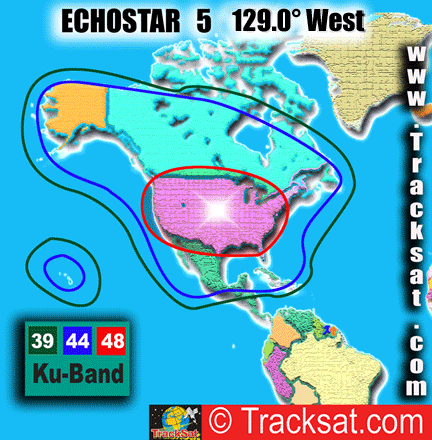

But as battery power is depleted, it'll drop. I think Dish should shut down some TPs, to conserve power. Maybe they can't work that way. Adding more channels may stress 129 even more... why don't they just trash the offending TPs that don't have the panels to support them, or is it all or nothing?
Your 129 TP31 signal strength is a couple of points higher then what I get and I have not had any "acquiring satellites" warning since peaking 129 TP31 to a "47 signal strength" a few weeks ago. Maybe something else is going on.
Understand, even with the numbers I have off of 129 (E5), I'm experiencing anomalies on a regular basis, and now — lost signal...
Dish is sending out service on Monday to upgrade my 1000 to a new 1000.2. I'm going to really try to get the installer to skew and tweak to the most precise position possible for maximum gain off of 129 (E5). I sit in a semi-healthy footprint in the central far west (based on the attached map from levibluewa), that is, unless it has shrunk due to 129's (E5) power restrictions. But given comments from people across the nation, it appears those in the northern most positions suffer the most as they sit on the edge of the footprint, while the rest of us are still subjected to the normal annoyances, yet we are now subject to signal loss as well, but when Bradtothebone stating, even he is subjected to dropout as well in Kansas City, it makes you wonder... no matter where you are, 129 (E5) still is a sick bird, and there may be little to do other than tweak a little here and there, and hope for the best. My concern are the lost panels, and the lack of ability for 129 (E5) to power itself, as well as maintaining its orbital position. Its become apparent, 129 (E5) is running out of fuel to keep it in its position, as well.
Based on bradleys comments from NW, a larger antenna is and option, but I don't think Dish would pay and install it, for a dedicated Dish for 129 (E5) reception, nor am I comfortable putting out the personal additional capitol, as 129 (E5) may just simply fail...
Regarding E11's launch scheduled for Tuesday... its original slot was announced as 110. The question, is E11 still going to 110... where will 110 (E8) go... perhaps 129?
The discussions over at 'Echostar 6 to be moved to 72.7wl', contains very well though out analysis of the present situation, which contains scenarios, and potential solutions, but at the same time, they mention Dish at present, is not in a healthy position. The fleet of SATs, given E10 is sick as well — if there are anymore failures, the discussions are painting a rather dismal picture... Its tough to look at the glass as half-full, at this juncture.
