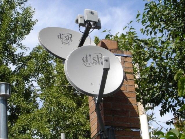

Original install was an 18" pointed at the 129. Drop-outs 2x an hour 1-6 minutes each depending on transponder. Replaced the 18 with a 24" and a "low-noise" lnb pointed directly at the 129...not as bad, drop-outs still 2x an hour, 1-3 minutes each depending on transponder. Tried a 1000+ thinking larger dish would trap more signal. That proved to be false, perhaps because it can't be peaked as well. Back to the 24" with drop-outs, again 2x an hour 1-3 minutes each event depending on transponder.
The 1-3 minute signal loss is really a minimum. If it goes into searching for satellite you can be playing around looking for a signal for 10-15 minutes, cause the stupid software, or something, goes to the 105 satellite looking for a signal, Hello!!! They should come out with new software that instead of looking at the 105 satellite just switches to Directv!
