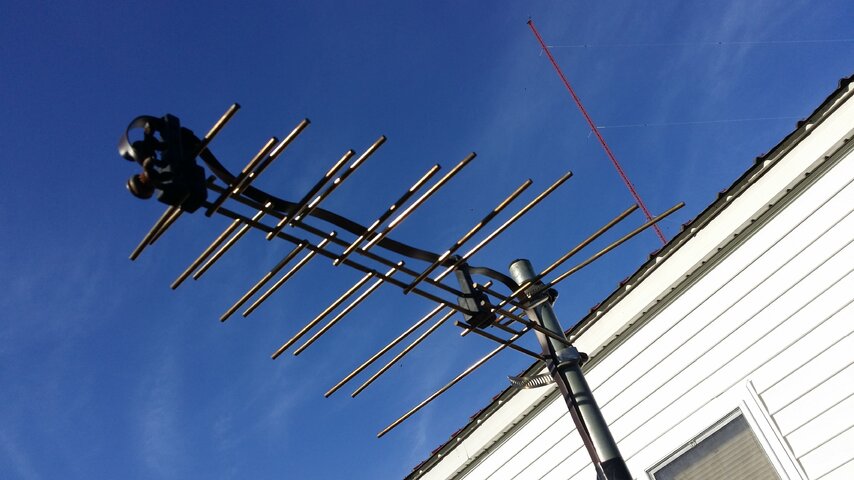

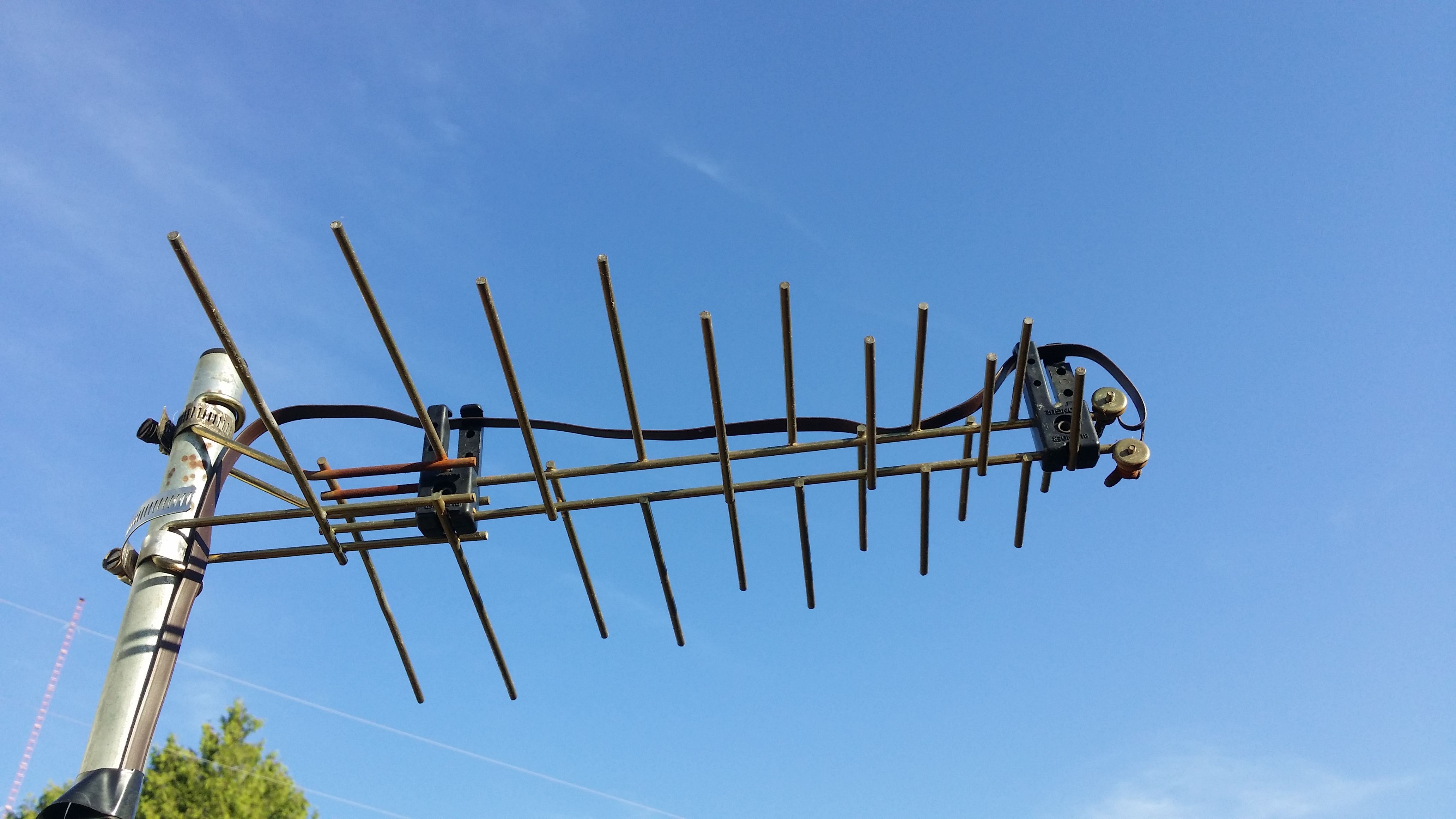

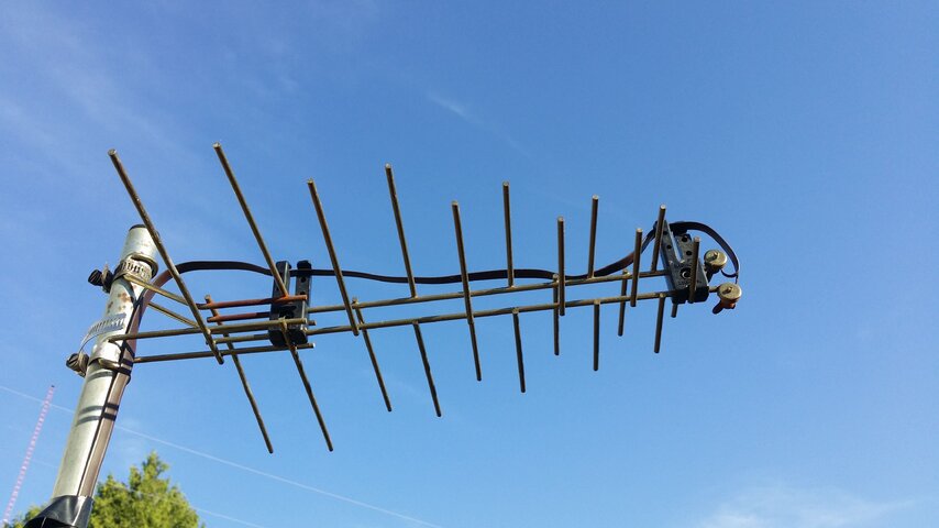

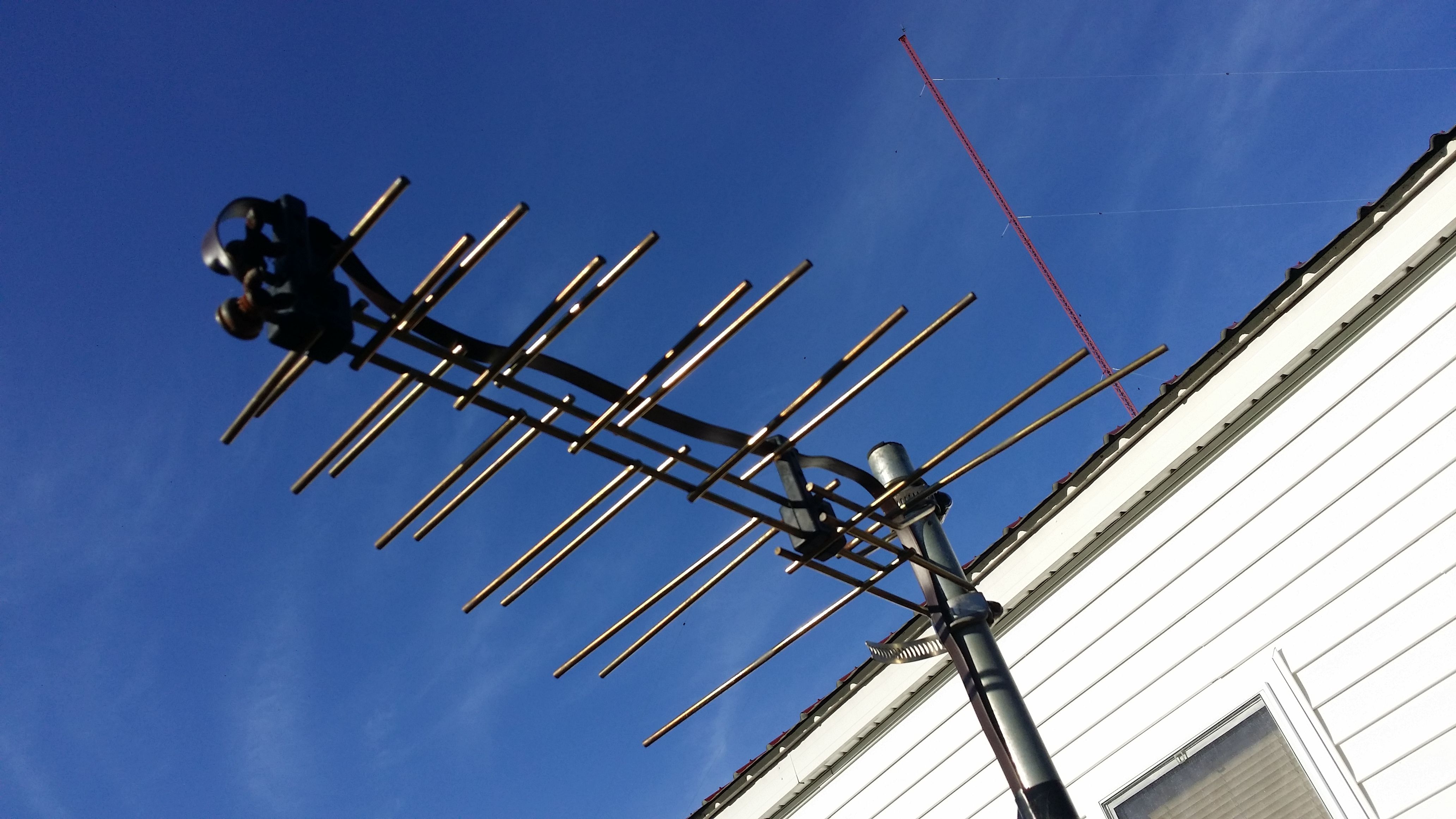

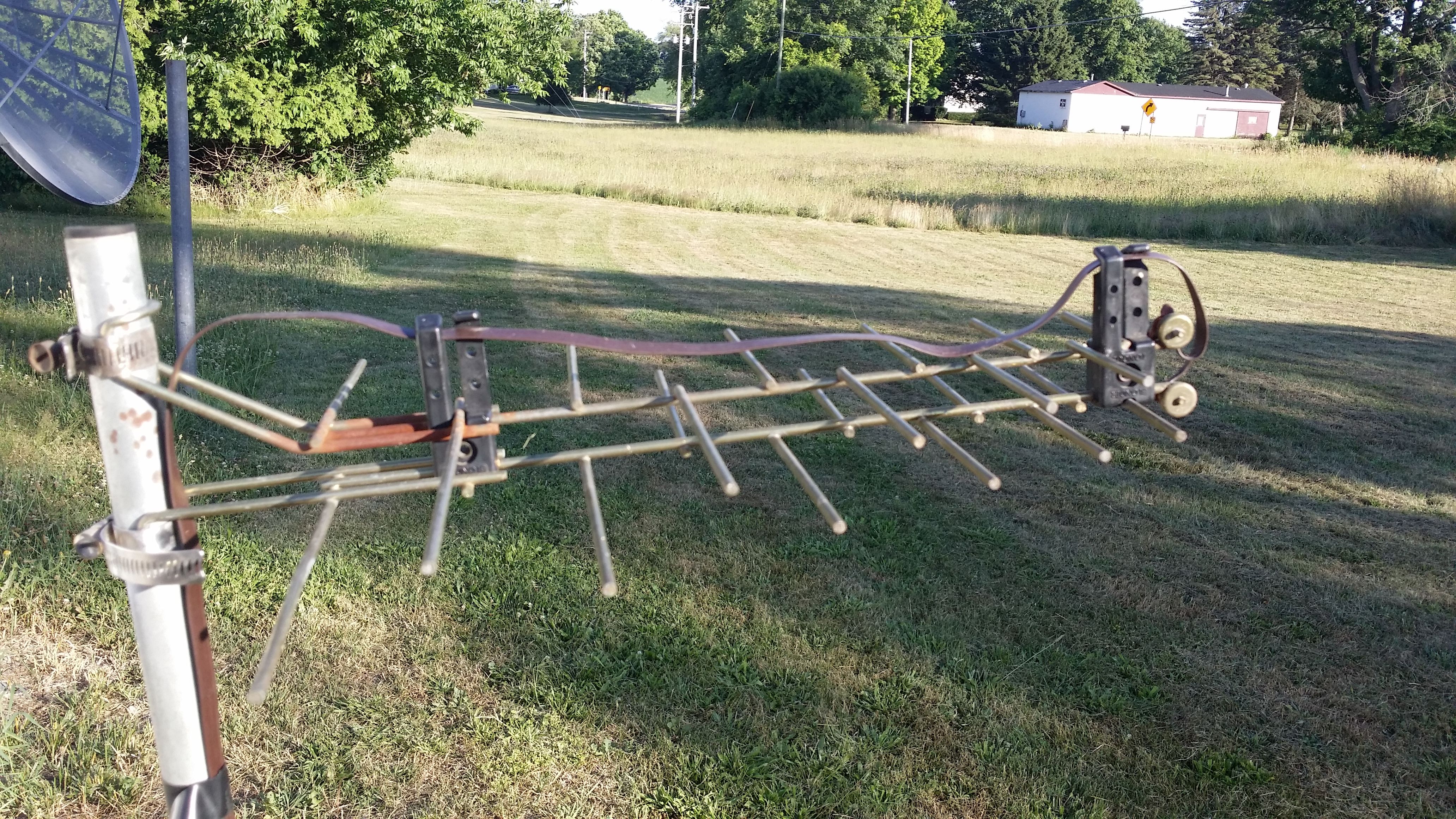

Got it over the weekend, let it sit, then today, for a break in my office-day, I stuck it in an old tripod at ground level, fed the twinlead into my office window and scanned! Blonder-Tongue antenna, appears to be part of a larger rig, or an add-on for UHF from many years ago. Worked great at ground level with 16 channels in one direction, I can only imagine what it would do on a rotor with coax cable feeding my office monitor/TV!
Guess I'm curious if it's torn off of a bigger rig, or an add-on, and apparently....the circuit includes the mast....so it has to be mounted similarly to how it is now with respect to a small diameter pole. Bet a modern antenna at $50 surrounded by plastic from a box store wouldn't do as well! Got a few "likes" on FB from people I didn't think would even care...and yes, the former owner mounted it upside down, or so it looks...
Thoughts?

Dunno about being an add on. Looks like BITD commercial log periodic. Direct DC ground to the tower leg on both sides (L&R elements) Probably just attached to a cable TV tower leg. Probably abandoned when they switched to satellite. (or getting a feed via fiber)
Would even work better with that twin lead if you use stand-offs. Keeping it spaced from any metal. Also make changes in direction gradual. No sharp 90's.
What is the width of the longest (back), and shortest (front), elements Overall length?
