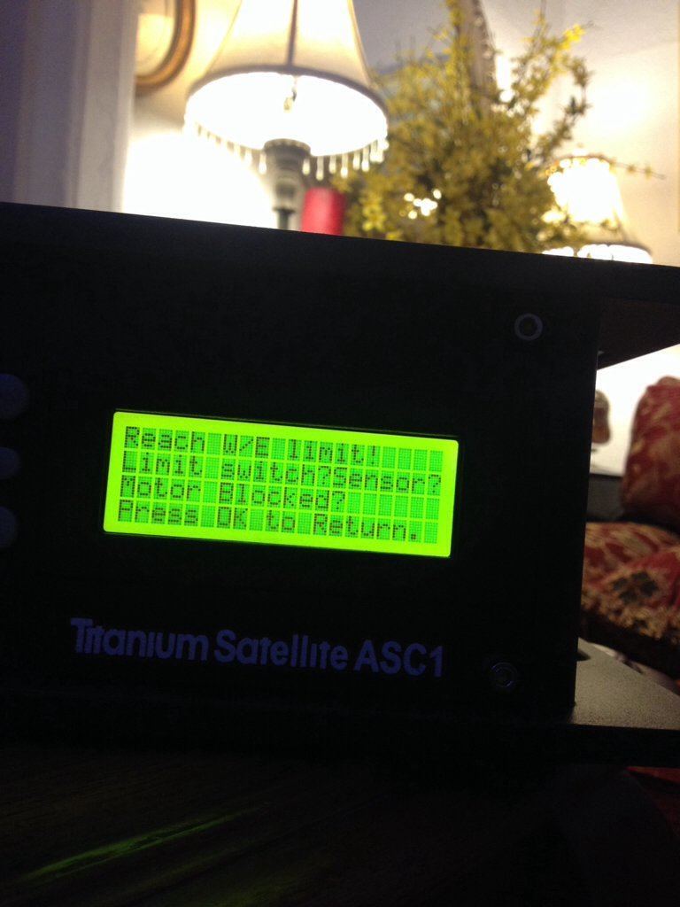

truckracer SatelliteGuys Pro Original poster Sep 17, 2004 4,338 351 Charleston wv Dec 28, 2013 #2 Mine keeps giving me "reach W/E limit! limit switch?motor blocked? Press ok to return" I can connect my analog receiver or vbox back and the dish moves fine.

truckracer SatelliteGuys Pro Original poster Sep 17, 2004 4,338 351 Charleston wv Dec 28, 2013 #4 I have checked all wiring from the house to the dish. Reed switch on motor is working.
M Magic Static SatelliteGuys Master Lifetime Supporter Oct 12, 2010 7,498 4,853 Montana Dec 28, 2013 #5 Reset the Limits. It sounds like they were inadvertently set wrong
Titanium AI6US Lifetime Supporter May 23, 2013 7,650 9,065 Meadow Vista, Northern California Dec 28, 2013 #6 Sent a link to all purchasers on Friday with the beta loader and beta firmware that corrects the dish move error. Some actuators issue long duration pulses and we updated the ASC1 firmware to accommodate this lower pulse count issued by your motor. Please email support@titaniumsatellite.com if you did not receive the email.
dougruss Retired and Loving it ! Pub Member / Supporter Sep 7, 2005 675 21 Northern Indiana (15,000 Feet South of Lake Michi Dec 28, 2013 #7 In your "Main Menu", scroll down to "System Reset", then to "Reset Soft Limit .....Press OK

truckracer SatelliteGuys Pro Original poster Sep 17, 2004 4,338 351 Charleston wv Dec 28, 2013 #9 Reset soft limits. Still getting the error message when I try to set the limits. My actuator is a 36" super jack.

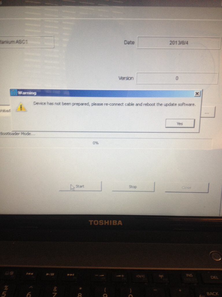

truckracer SatelliteGuys Pro Original poster Sep 17, 2004 4,338 351 Charleston wv Dec 28, 2013 #11 Crap! None of my pc's (laptops) have a serial port!
truckracer SatelliteGuys Pro Original poster Sep 17, 2004 4,338 351 Charleston wv Dec 28, 2013 #12 I will have to buy a USB to serial adaptor

truckracer SatelliteGuys Pro Original poster Sep 17, 2004 4,338 351 Charleston wv Dec 29, 2013 #15 I keep getting an error
truckracer SatelliteGuys Pro Original poster Sep 17, 2004 4,338 351 Charleston wv Dec 29, 2013 #16 Tried rebooting and reconnecting.
dougruss Retired and Loving it ! Pub Member / Supporter Sep 7, 2005 675 21 Northern Indiana (15,000 Feet South of Lake Michi Dec 29, 2013 #17 Are you using the Serial Cable that was provided? If so, that the problem. The wrong cable was shipped !
Titanium AI6US Lifetime Supporter May 23, 2013 7,650 9,065 Meadow Vista, Northern California Dec 29, 2013 #18 Using a USB/serial adapter or serial port? Using a NULL modem type serial cable?
KE4EST SatelliteGuys Is My Second Home Staff member HERE TO HELP YOU! Lifetime Supporter Aug 9, 2004 26,911 7,268 EM75xb Dec 29, 2013 #19 Make sure you are also set for Com port 1.
truckracer SatelliteGuys Pro Original poster Sep 17, 2004 4,338 351 Charleston wv Dec 29, 2013 #20 I am using the cable that was shipped with a USB to serial adaptor. So I need a null modem cable?
