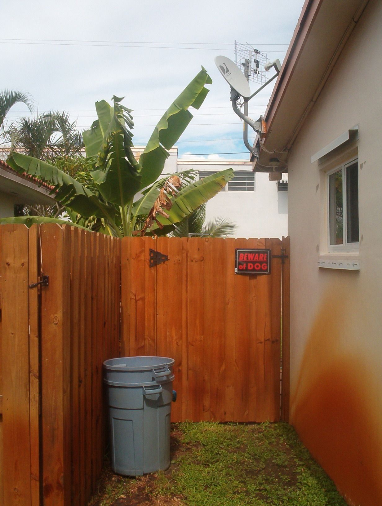

I'm having a 5LNB installed Friday. My existing dish is mounted on the north side of my house to my fascia board then pointing southwest( the foot print of the bracket is bigger than the fascia board ( it hangs below the fascia board about 2 1/5" ), so its kinda shaky ) Do I need some under the eave setup ? ( if even available ) would the installer have something like that to install the new heavier dish ? I would like to have it bolted directly to the concrete wall and coming up from under the eave - this would seem much more stable ? Do they even have equipment to do this ? my dish cant be mounted on the south side because of a neighbors tree's. If needed I would pay extra - i just don't think my current dish setup would be adequate for the new heavier dish. Any ideas ?

I would have to put it on the north side of my house and I only have six feet from the property line, so I would need to find a pole tall enough to get a sight line above my roof, so I would need a 12'-14' pole including 2' in ground. I wouldn't know where to look for one that size. Ideally the installer could move it to the South side of my house and just bolt it to the concrete wall, but my neighbor has a big tree, so i don't think that's a option either. any ideas ? my picture kinda shows my situation. thanks -

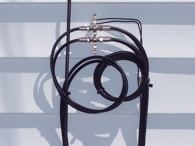

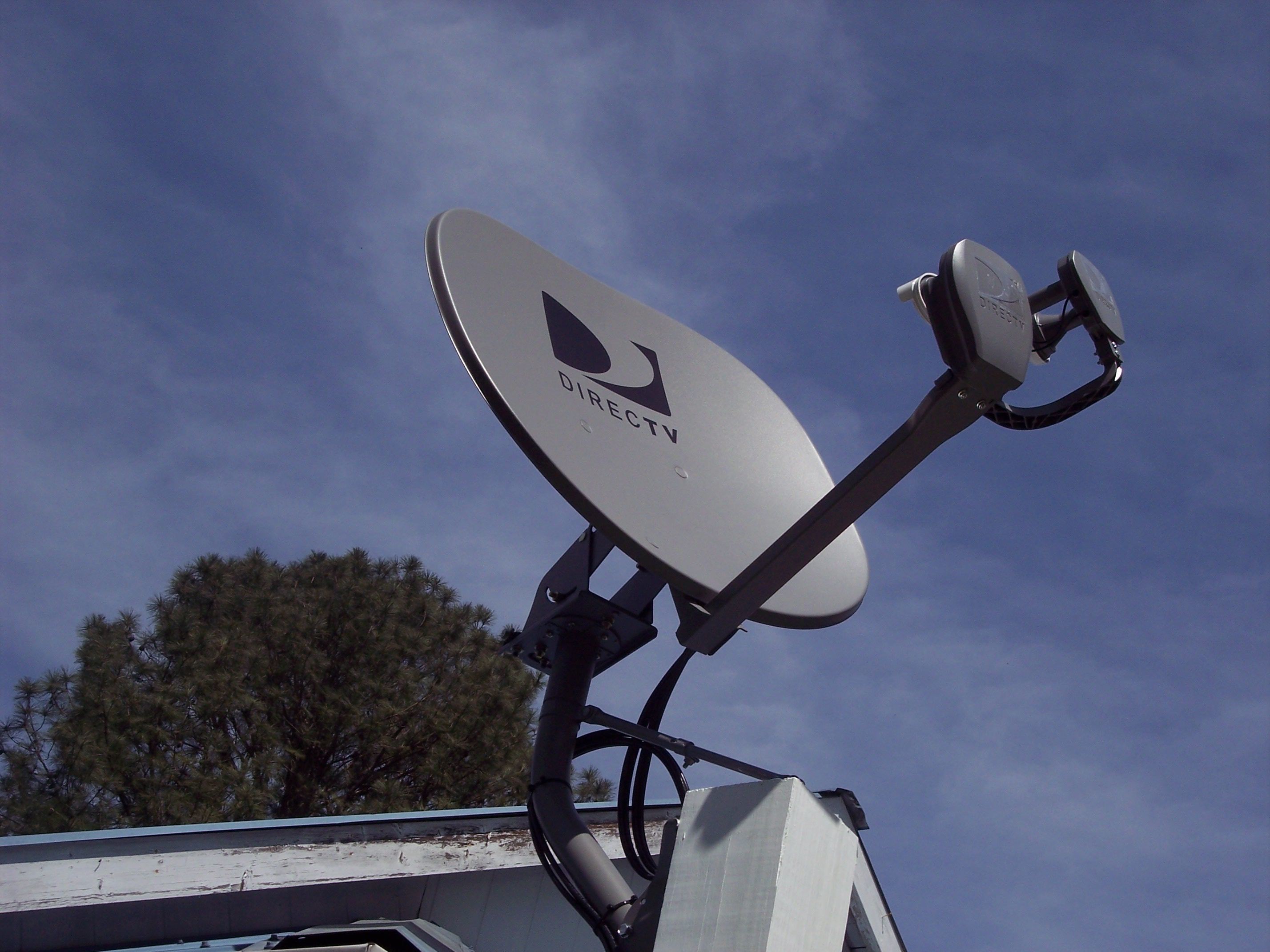

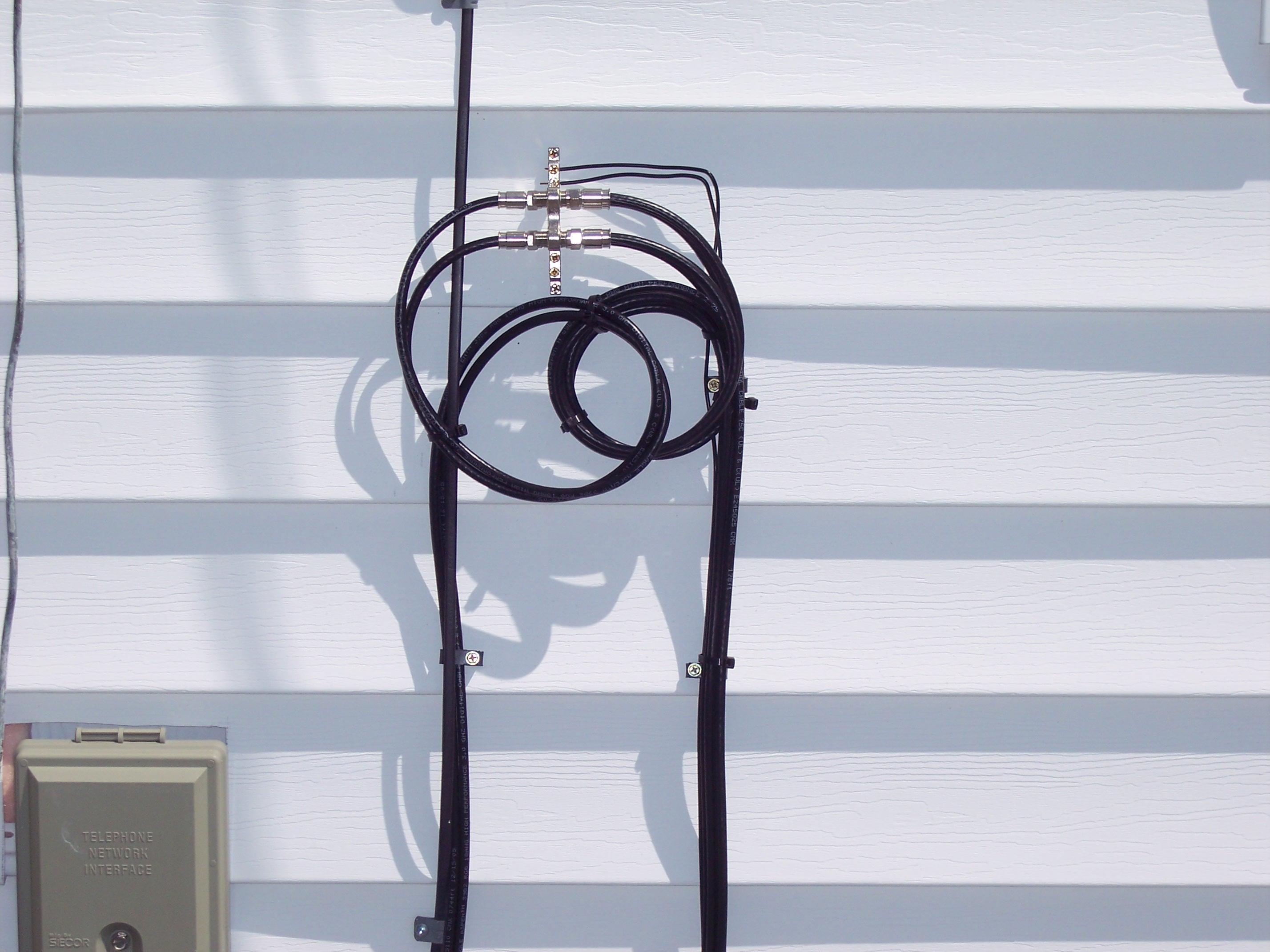

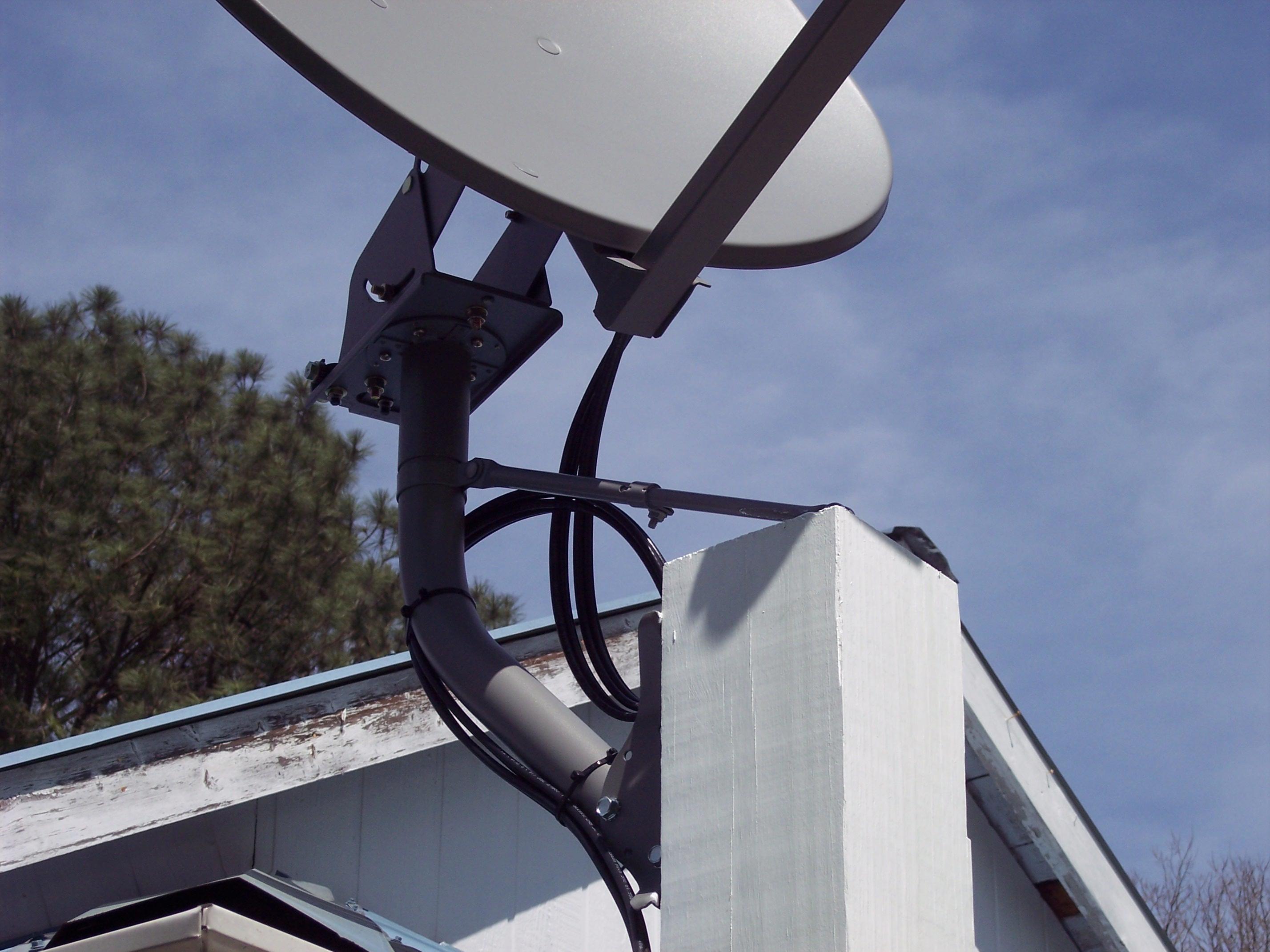

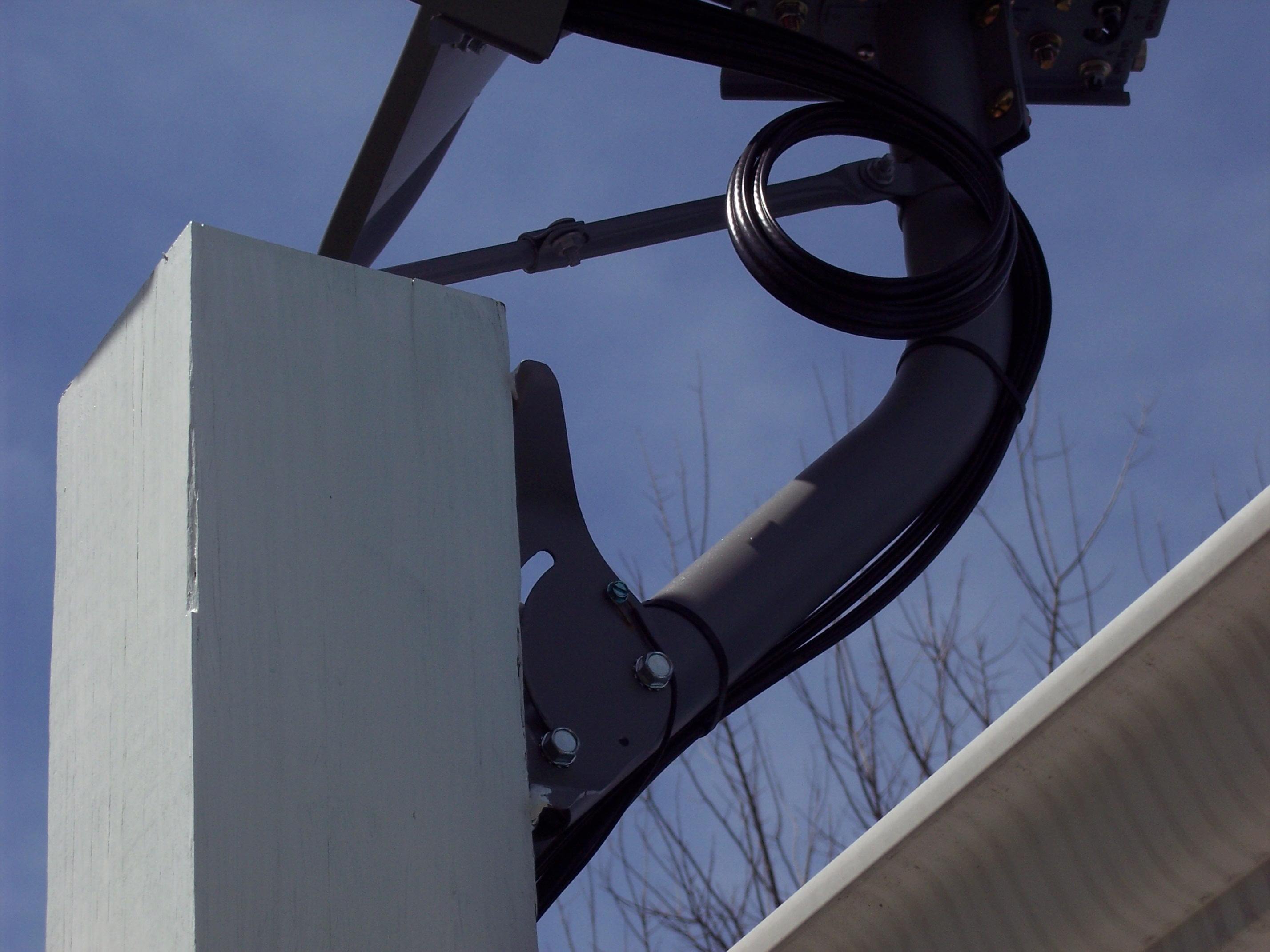

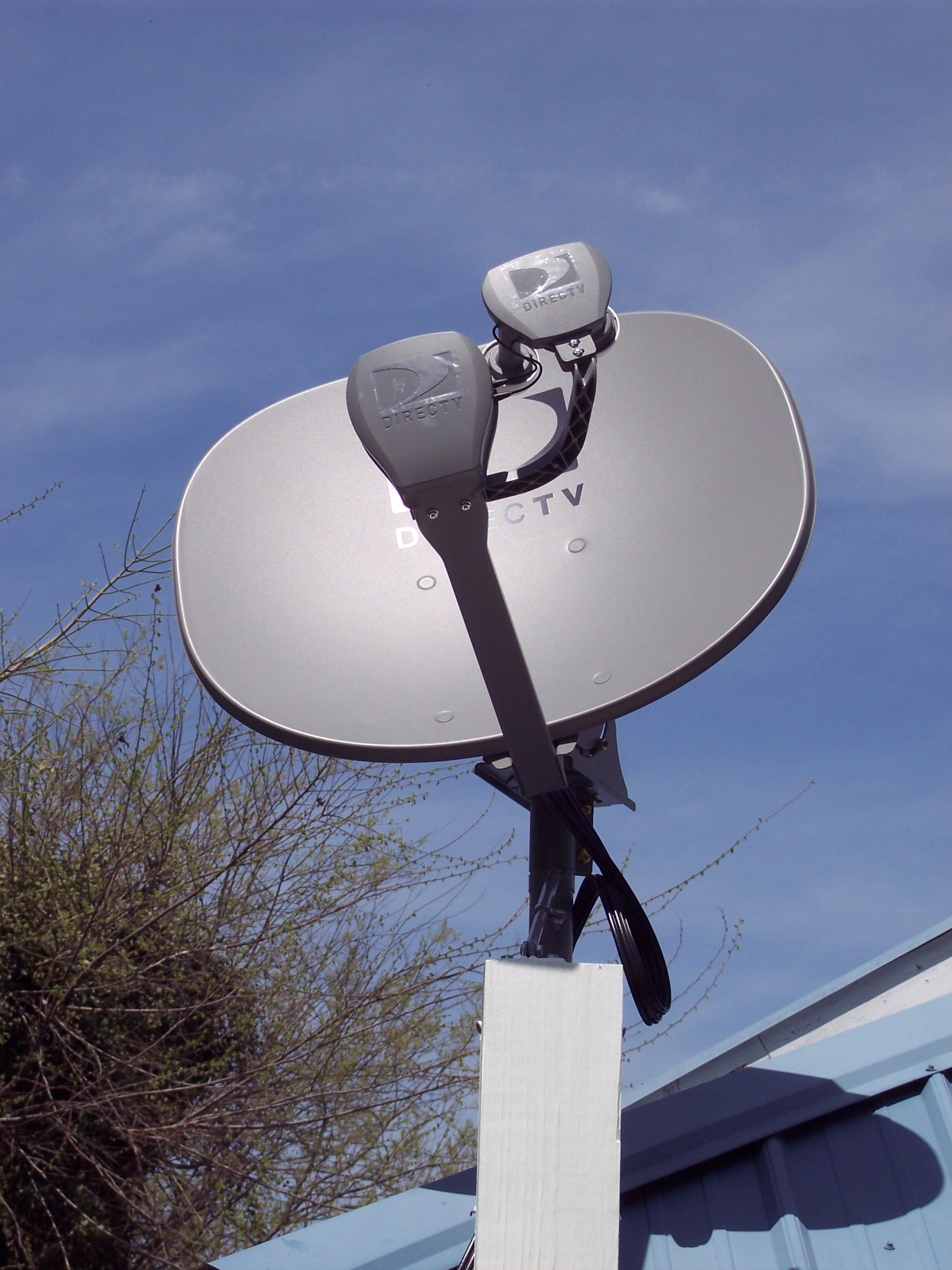

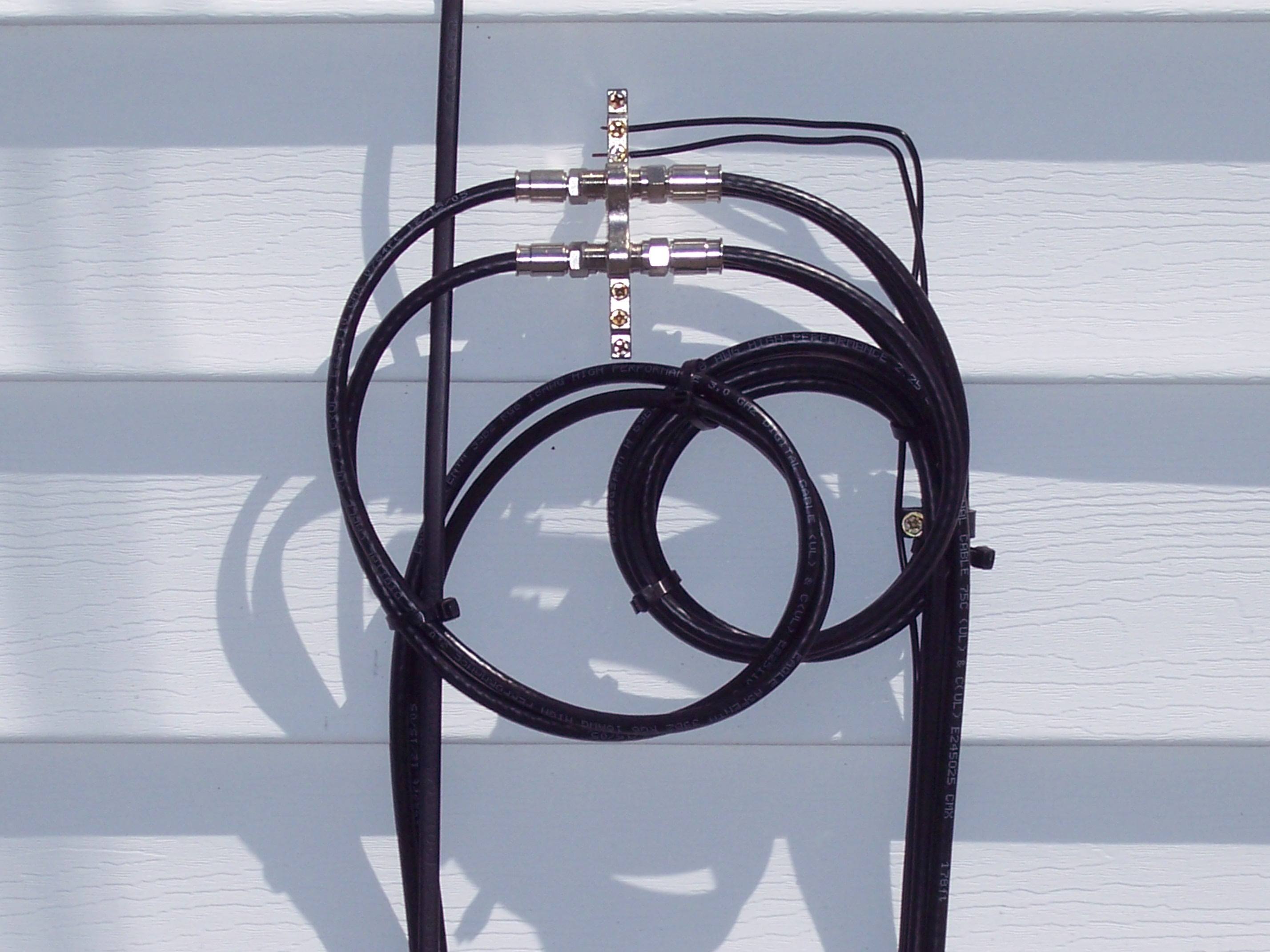

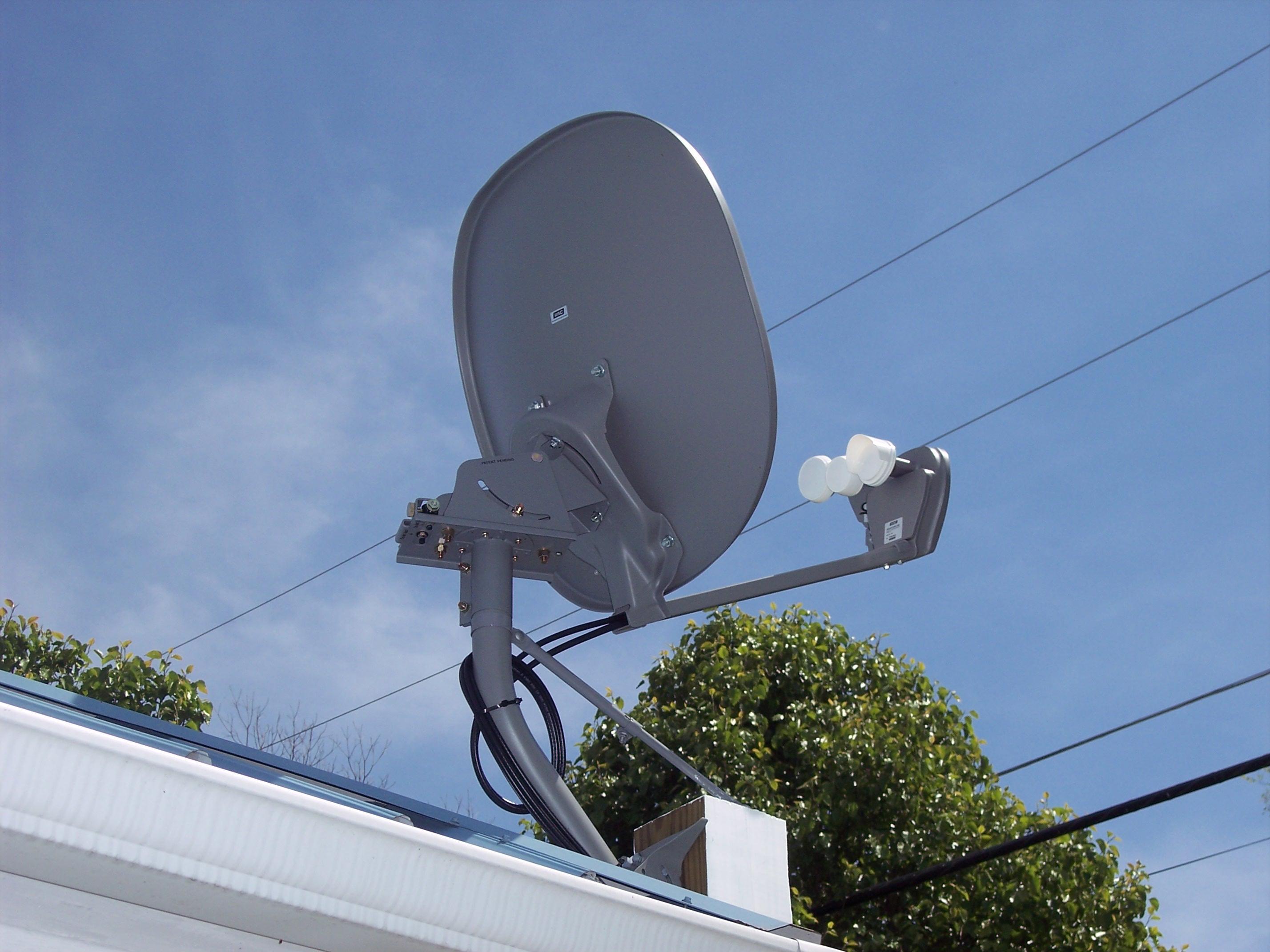

We bought a 12' 6x6 pressure treated post at Home Depot for around $40 for our D* install in March '06.I put 3' of it in the ground,anchored it with 100 lbs. of concrete.We had the AT9 and 2 H20s installed.Everything has worked just fine for us since the install.We have had several stormy days and nights (alot of rain and winds) since this was done,we've had no issues with loss of programming or anything of that nature.The D* tech that installed this for us came back out once to adjust the dish for our HD locals from D*,other than that,everything has worked smoothly. :up :) I am attaching a few pics of the install job to view.
