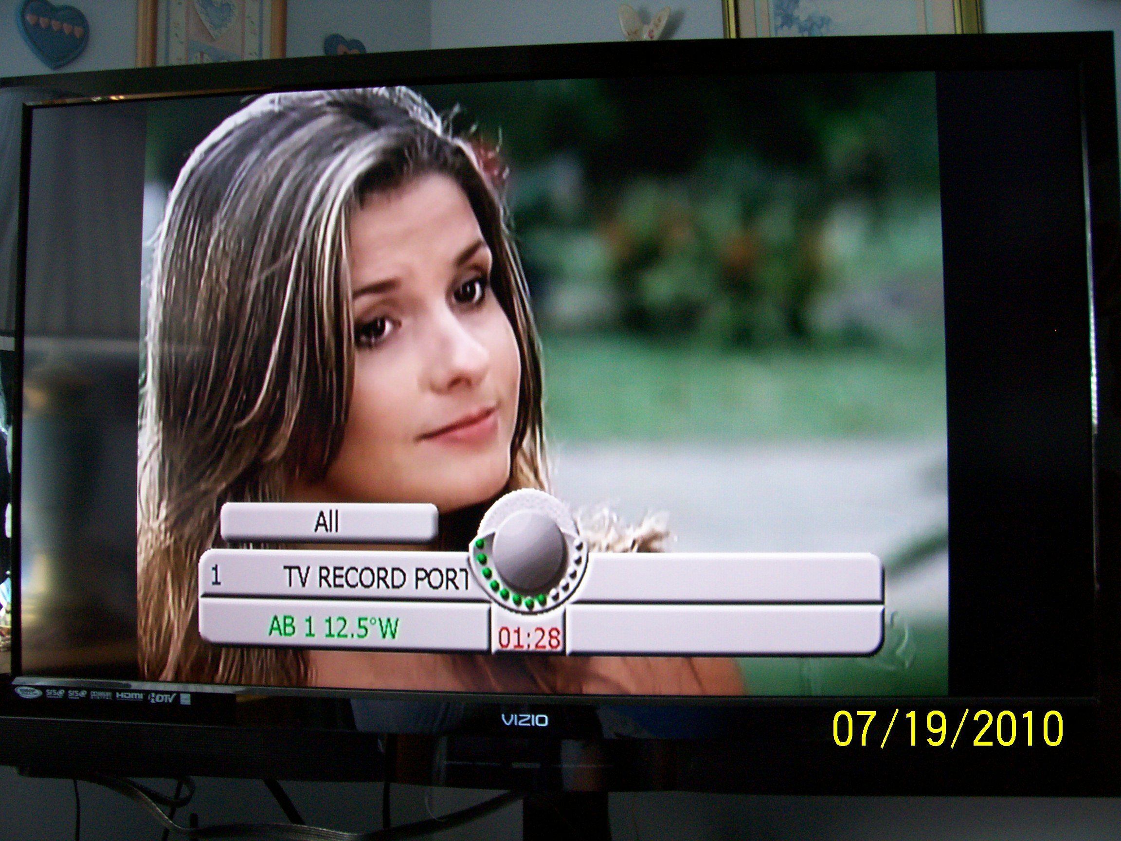

Nada...Record was there last week and the SkyLogic data signal is there tonight but nothing else that I can see...
Only one of the two I get here is 11622 H 3255. I lose it when there are storms
off to the east as it is very low here. I'm pulling it in now with only occasional
pixelation. The SkyLogic data signal ACRadio refers to is always pretty strong
on that Sat.
A pic from this morning...
What dish size are you using to receive this satellite? With a 36 inch dish in the Toronto area, I only get the occasional blip of signal from the Record transponder. However, I get 80% quality on the skylogic data transponder.
Tried with a 39 inch dish and still nothing. Wonder if a better LNBF would help? I'm currently using a FortecStar 0.2 dB universal.
