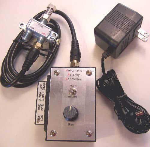

does anyone have one of these i need one thank you
they been out of stock and not coming back
