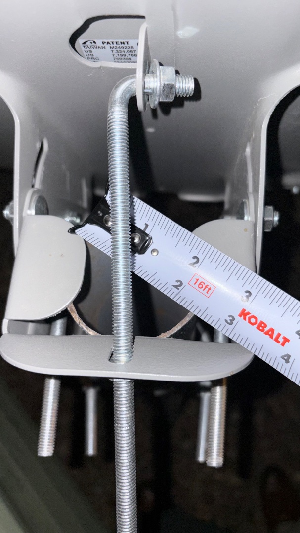

to fit on what size OD pole?
Appears to be just shy of 2 1/2"
