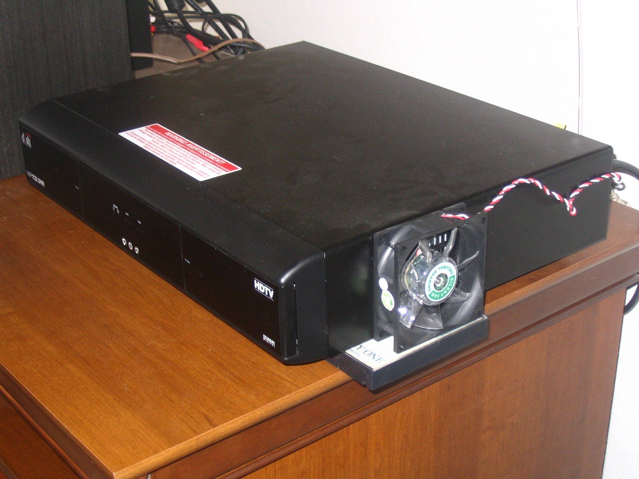

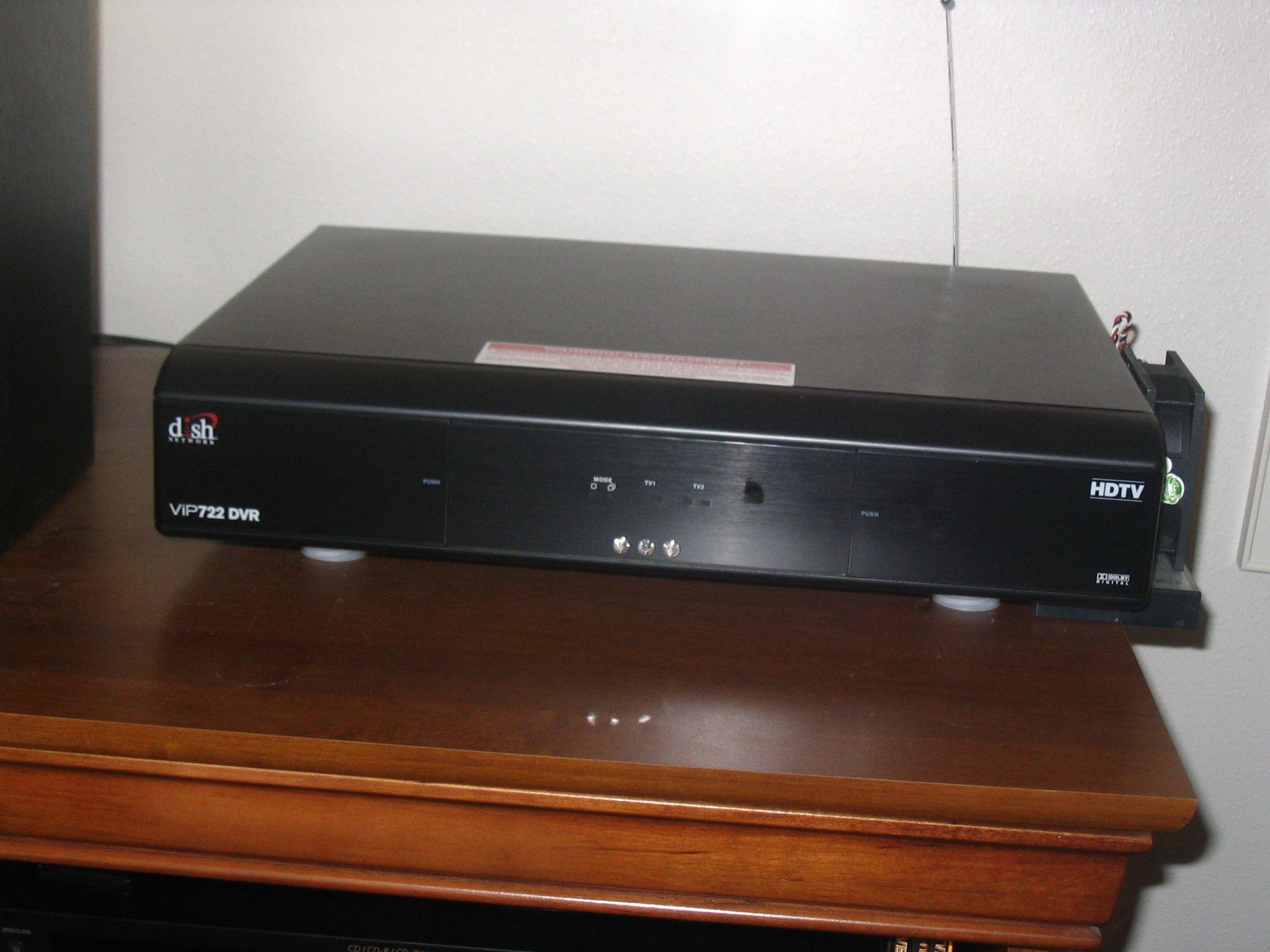

Here's my temps before:
High: 132
Low: 113
Avg: 118
And after having a fan for 9 days:
High: 132
Low: 93
Avg: 111
Anyone else have any ideas? I want to wait another week with this new fan and see what happens, but after one nightly update, no change. I also raised the receiver off the top of my TV stand by 1/2 inch with some plastic lids from some water bottles and it has good air spacing all around (I think).
The attached pics are my receiver atop the TV cabinet. The fan is blowing into the right side of the receiver as of yesterday. Previously I had it sucking air out of the left side.

The fan is rated at 12V 160mA and I'm running it at 12V 150mA. So it pretty much is at it full speed, but like I said it doesn't seem to get a good air-flow right up touching the side of the receiver. See the pics from my last post.

See, you have yours on the opposite side as me, I never had much luck on that side forcing it in or pulling it out.
Here are some pics, as you can see its in an enclosed cabinet:
Thats the thermaltake usb fan pulling air out of the back right, over the power supply. Dropped from 122 to 107 in the enclosed area.
I have my fan on the other side towards the back.
I tried that for about 5 days and got an average temp drop of only 4 degrees. I was able to get 3 more degree drop by moving it to the front left and sealing off the rest of the left vent (essentially making all the air go out the fan).
We'll see what happens with the fan on the right side. Some people said it would work better, but I've yet to see that. I guess it's worth experimenting until I get it the best.
