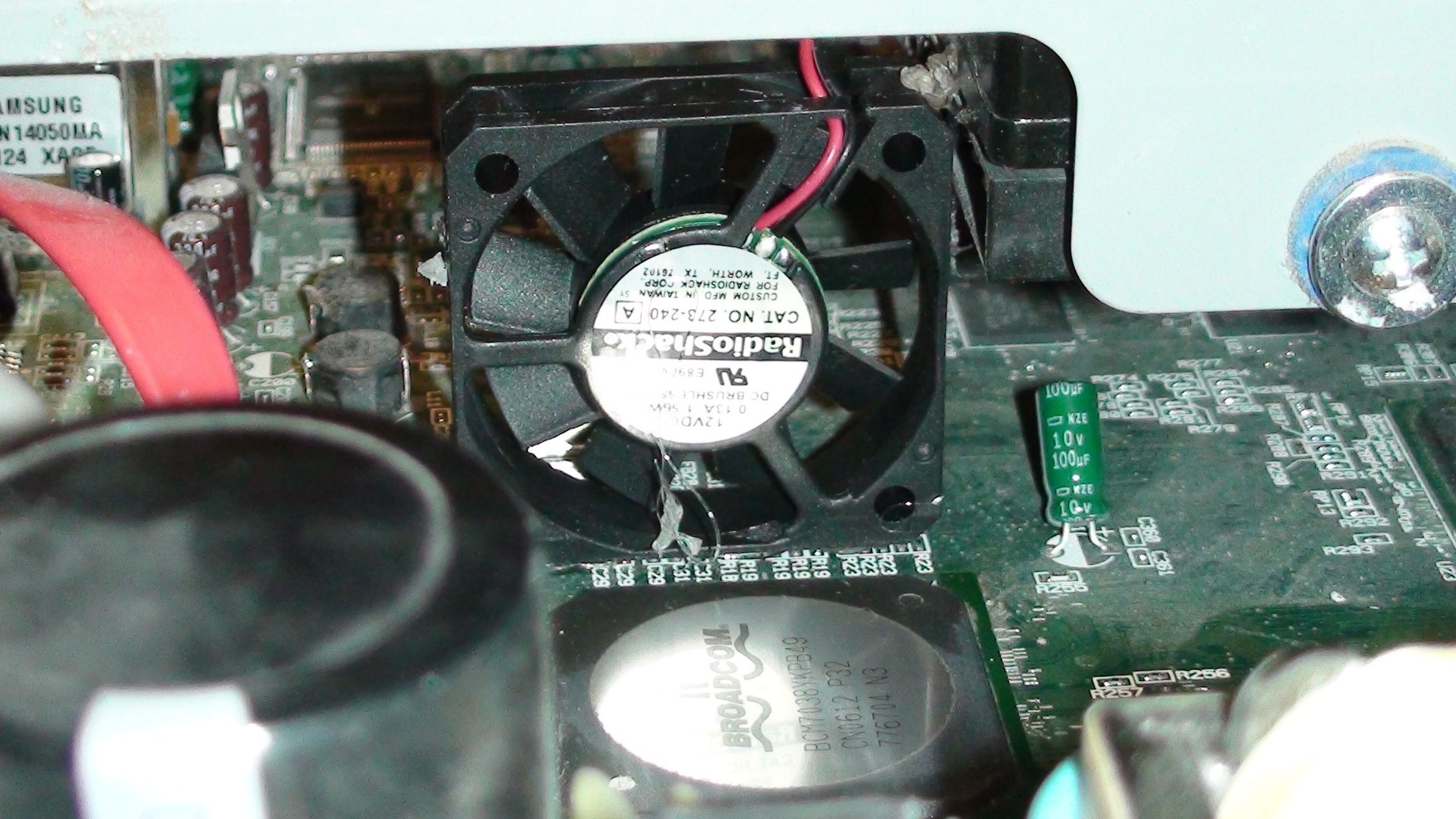

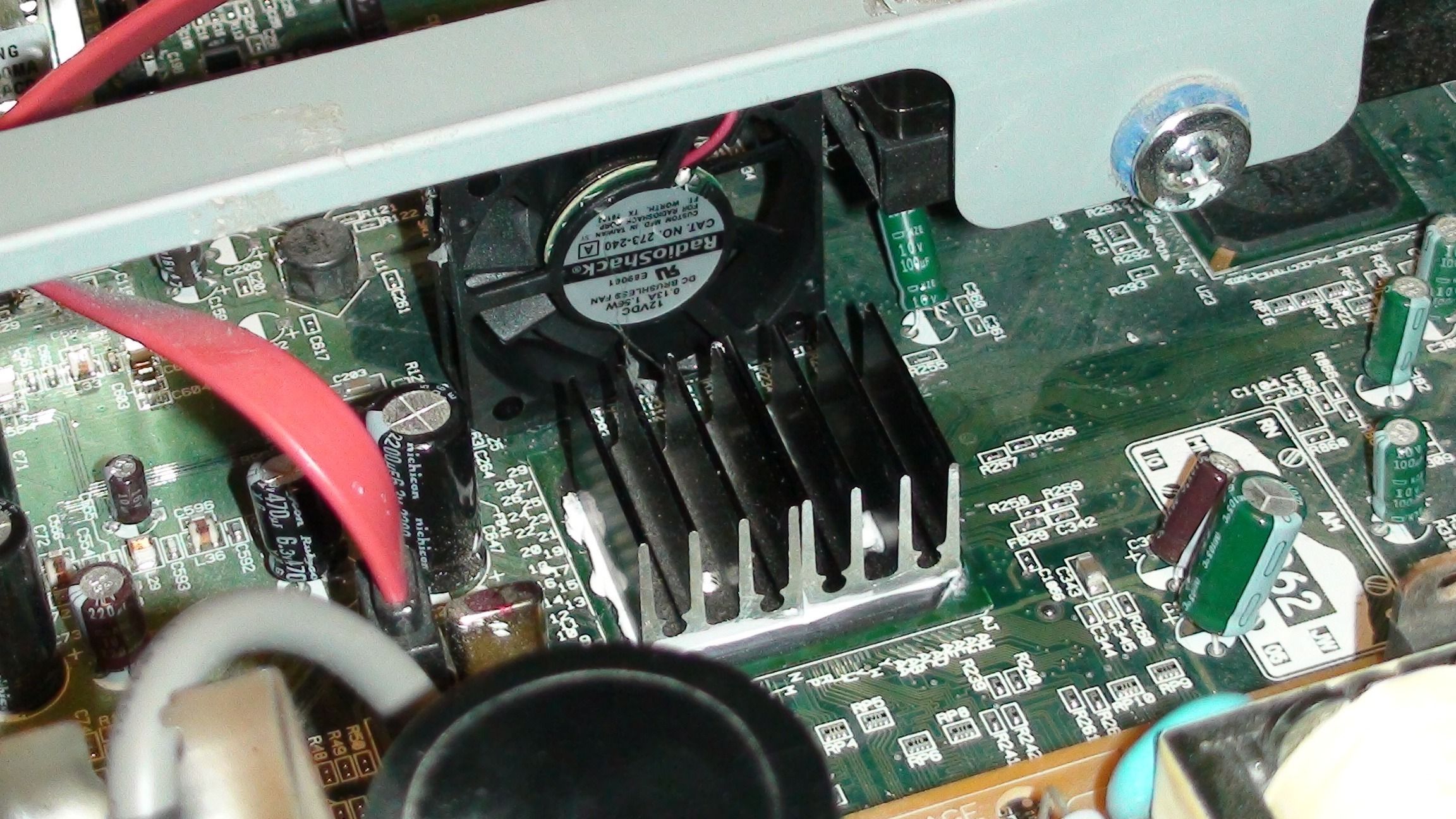

Hi again all! I was glad to see this thread re-emerge. It reminded me that I had some unfinished business to attend to here!
When I first posted some experimental results in this thread (#163, 15 June '06) I mentioned the additional experiments I was planning to try. At that time I had taken a number of temp. measurements under varying conditions. I became focused on the BroadCom processer as that was the hot spot in my unit, and I was concerned that it's excessive temp. (>160 deg. F with the lid on) wasn't going to help the long term reliability any. I ended-up leaving the cover off the 622 with a 3-fan laptop cooler blowing down into it for ~2.5 years! In that situation it would run at less than 120F while "active" and less than 100F in standby. Some improvement but not optimal. It sat that way until I finally got around to trying an internal forced air cooling system.

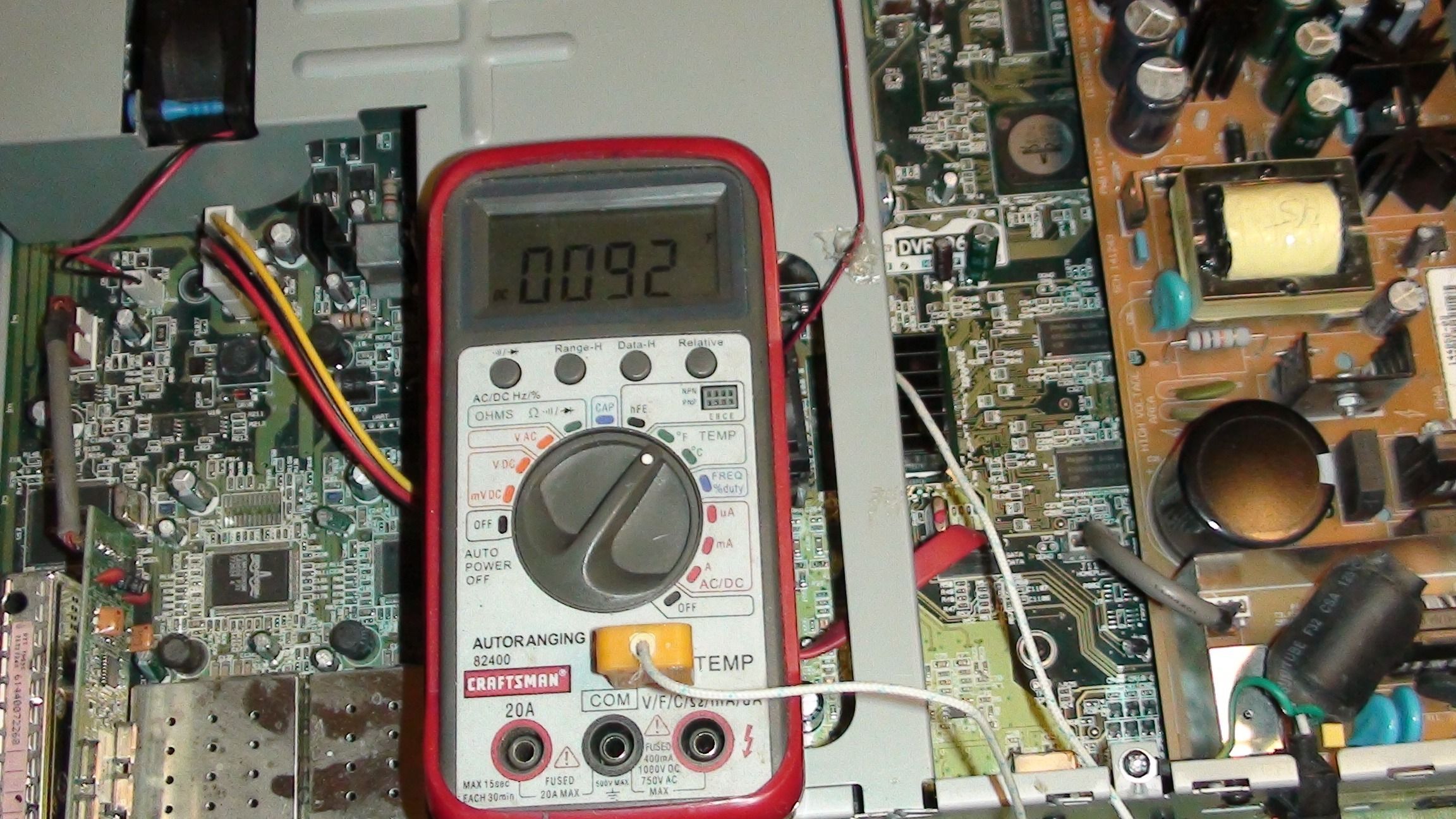

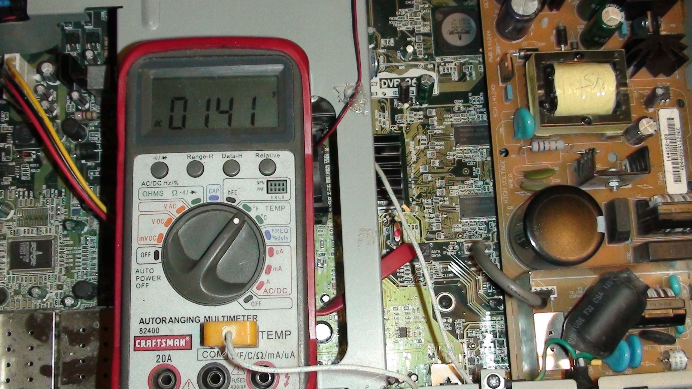

So this past Dec. I sucked out a ton of dust, installed a brushless 12vdc fan ("hot melt" glued to the PCB and HDD mount, powered from the 622's PS), installed heat sinks on the BC chip (held on only by the silicone grease which will harden with time), and took some new measurements. The pics below show the details. The first temp. reading (141F) is with the unit powered in standby, but no fan, and the second (92F) is with the fan running.
At this point the 622 is running again cover on, so I expect the chip temp. to be at least 10 deg, higher. The system is reliable, no glitches. I'll open the unit from time to time to check up on the fan and clear any dust accumulations.
It's hard to say whether or not I'm getting any improved performance or the 622 have a longer life this way, but IMHO it can't hurt!
