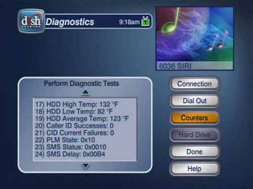

Here's a pic taken from E*'s Tech Portal, showing the counters we're looking at. It shows High Temp at 132, Low Temp at 82, and Avg Temp at 123.
I doubt that this suggests the "ideal" or "model" temps... but, I thought it was interesting.
