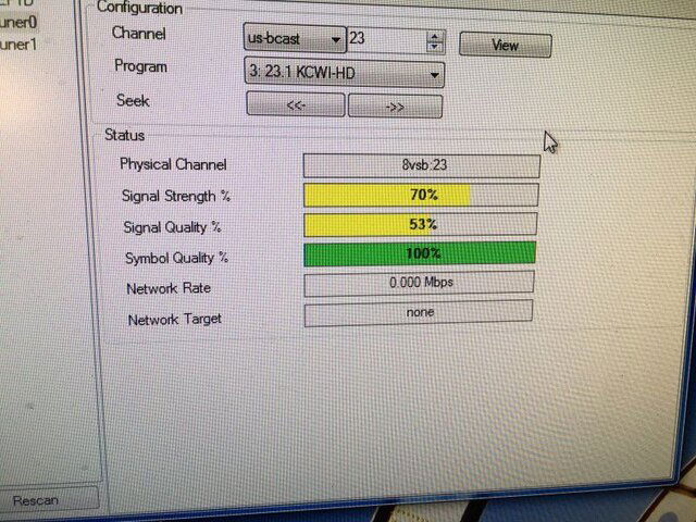

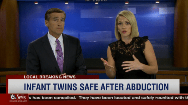

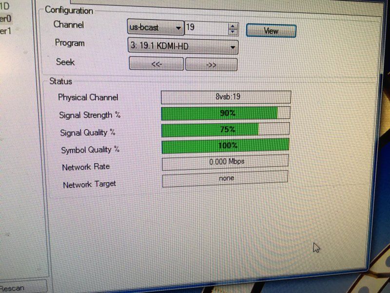

Awesome tropo locals coming in tonight
That's awesome!! Whats your antenna setup?? Love to know!! Thanks, Andy
Nothing too exotic. RCA ANT751R antenna on a J-pole mounted at the apex of the roof (approx 18 feet up). RCA TVPRAMP1R pre-amp running behind it. Then, I split that signal using an RCA 10db amp, running one feed to my Dish Network 211k receiver and the other to an HD Homerun HDHR3-US.
I have to say, for a low-profile antenna (about 3 feet long), the RCA ANT751R is the best I've tried so far. I had an Xtreme Signal HDB91x briefly, and although it was almost 7 feet long, it didn't do nearly as well as the RCA.
As of right now, KCWI from Des Moines is coming in also. 246 miles away. Lots of DX activity tonight!!
