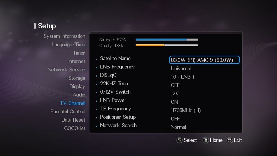

I have some problem with MAZ. Can someone check this out?
Satellite on position/index '0' is showing diferent data in MAZ and AZBOX. In my case; AZBOX is showing LNB as a standard, LO 10750, but MAZ is showing as an universal and LO 10750 (disabled editing).
In MAZ, channels from satellite on index '0' (in my case AMC21)are not showing up at all, but I have no problem watching it. AzBox is listing them correctly.
MAZ 2.3, FW 0.9.3877
Yurek,
I observed the same problem on my system with MAZ 2.3 but with FW 0.9.4142.
The satellite listed with index '0' happened to be Nimiq 5. I had it set up as LNB 11.250, but Maz Edit showed it as Universal 10.750. I didn't have any channels scanned on this satellite, so I cannot confirm what you observed in regards to the channels not showing.
I deleted this satellite using the AZBox remote and downloaded the channel list again. This time Nimiq 5 was removed, but no satellite was labeled with index '0'.
Obviously there is some flaw here.

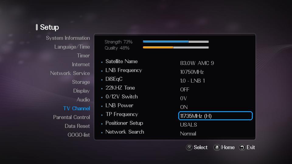

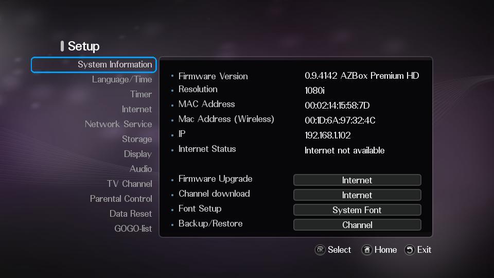

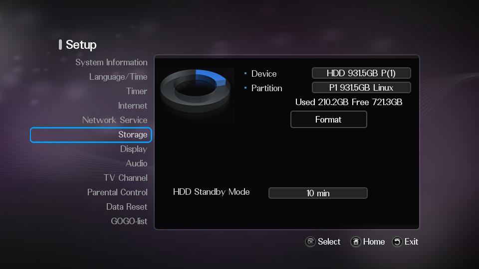

One thing that is really handy, you can take screen shots directly from the editor and even screen shots of the On Screen Displays. I'll post a few just for examples. There is one small glitch here, it saves the images as a PNG file. You have to change them to jpg to upload here.
Also, notice that on the setup screen, it shows INTERNET NOT AVAILABLE. I am connected and everything is working fine. Another bug!
RADAR
RADAR

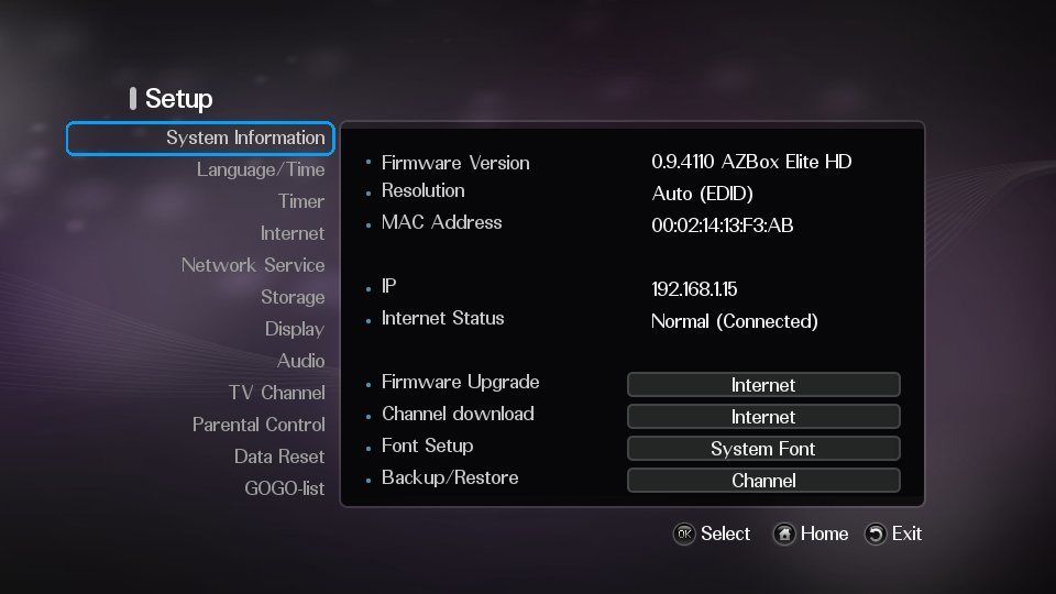

Hmmmm, I'm using Maz 2.3 here also but still on firmware 9.4110 and when
I saved a screen shot the default type shows "Archivos Jpg". Saved with jpg
extension but your right, was actually a png file. My Internet Status shows
Normal (Connected) also but I'm using a wired connection.

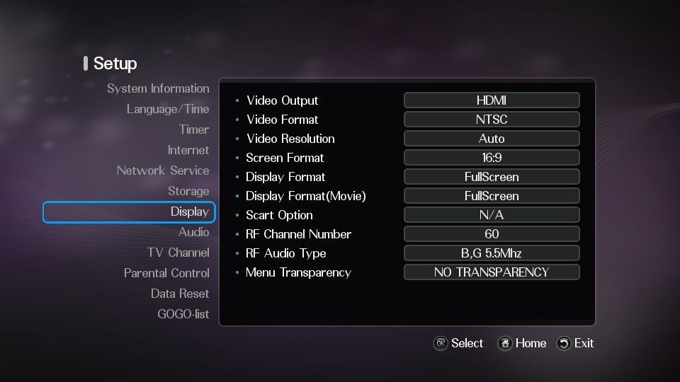

I had my Video Resolution set to 1080i a while back and after one of the last updates
it changed to auto. Seems to be displaying the HD feeds ok so I left it there. With it
set that way it displays the AUTO (EDID) in the system information.
