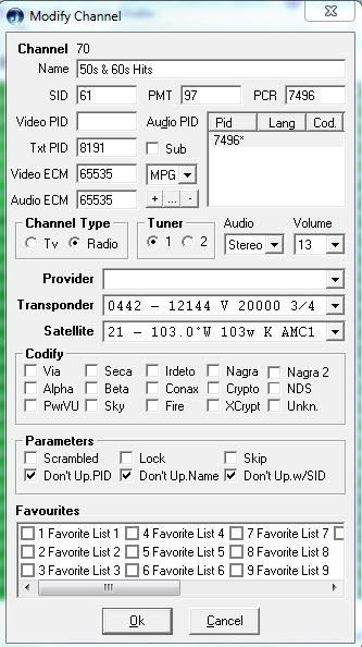

I am trying to add the Muzak / mood channels to my GEOSatpro MicroHD using Mediabox Editor Studio (MES). I'd done this a few years ago, but in the meantime, my original MicroHD died and I must have deleted my .udf files.
What's happening is that although I am able to add the correct audio pid in MES, and the MicroHD will play it temporarily, it will not display the correct audio PID. I can play the channel, and then when I move to another channel, it'll revert to the MS81 that I had copied & pasted as my channel to modify.
Can anyone look at this screen shot and tell me what setting(s) need to be changed? Thanks in advance for any help!
