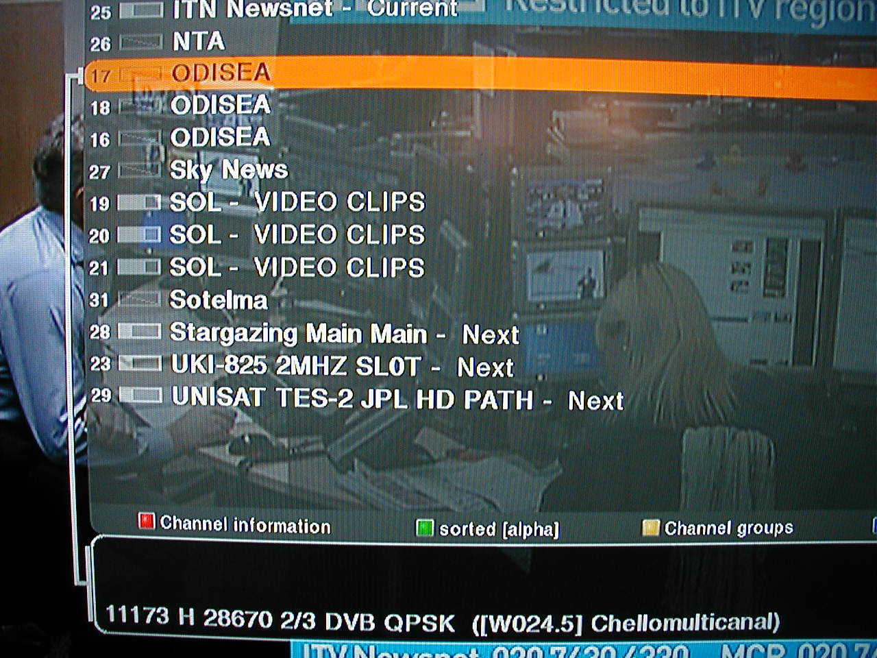

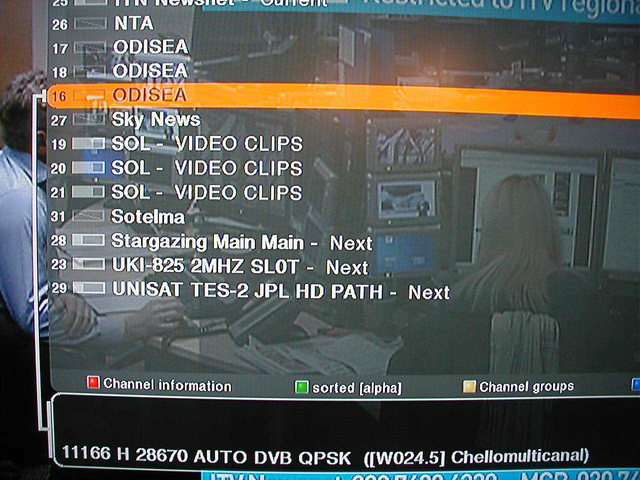

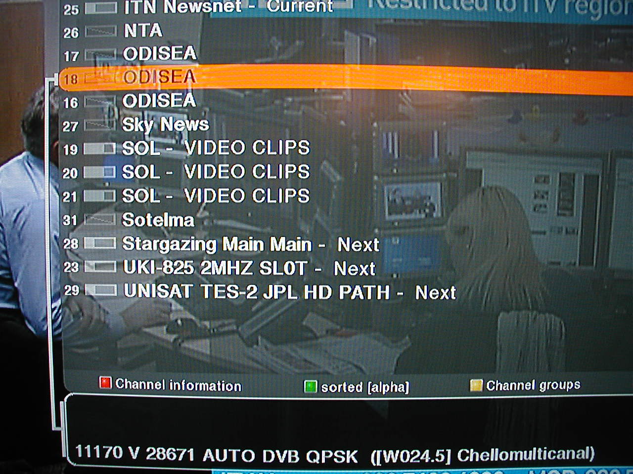

I'm getting along with it just fine. Only a couple of things gripe me which I know you are working on. One is the blindscan speed, it seems to find the transponders fast enough, but when it comes to channel download it takes quite a while, and seems to duplicate channels which have a high symbol rate, see attached pictures of the same channel duplicated three time from the same transponder from one scan. Also a remote based delete is a must to clear out channels before you blind scan for feeds else you clog up with dead channels from previous scans.
Also in and out of the media centre is really slow but your new drivers will hopefully fix this. Apart from that it works just great for me anyway. P1010006.JPGP1010004.JPGP1010005.JPG
