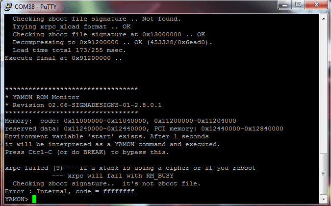

This post is really useful for me. First I would say thank you for your tut. However, I got a little problem in the end. My azbox got stuck in booting sequence, I have followed your tut step-by-step carefully and have succeeded through the entire process. But after update, the box is failed during the booting process. It got "Error : Internal , code = ffffffff"; Here I put the pic.
What's wrong then? I guess the recovery file is bad or there is something else? FYI, the recovery file I used was Kernel 344.
Hi Lange,
Thx for the response. As I stated I used kernel 3.4.4. And actually I used two tut to recover my azbox, one is from Radar and one is yours. Thx a lot.
But alas in the end I still find error. Oh yeah, I used file that is packaged together with your tut, so I guess the file is right.
The only thing is, it could also be kernel 2.6.x f*ck-up.
Did you try that kernel as well?

darkCoklat,
From all appearances, it looks like all your hardware is in good shape. You were able to communicate past the point where my first failed AZBox was, I never got to the point of recovery with my failed box as it was a physical hardware failure and I had to send the box in. Evidently you have a corrupt Zboot file, but is the error message telling you that the resident file is bad or the recovery file is bad, I am not sure on this. If you can get on line with the tech support from OpenBox, you can detail the error and they will explain it better than I can.

Lange:
I got my box messed up when I was trying to install Open PLi image using AZUp2-2-7. I am not sure about the kernel version, but yes, I did check the "Copy Kernel" option. Say, If it's true I tried the 2.6.x kernel, can my box still be revived?
