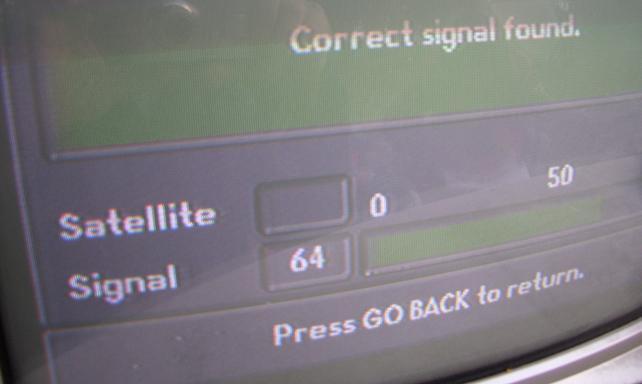

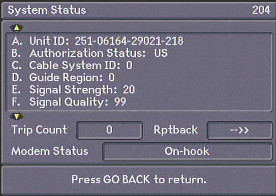

Today I took out the ol' 13 inch TV and my dead-battery DSR-410 and got the 5 footer locked on W5. The results were actually pretty good for a smaller dish like that. Between the dish not having ANY markings for az/el and the small size making it very touchy, we got it done! Now when my new DSR-410 comes next week we'll get a sub going and see how well this project will do. babycw5.jpg

You have 64% signal with a 5ft dish.
I'm getting 99% with a 10ft temporarily set up with a DMS Intl model ASC421 13*K LNBF. The dish is located close to ground level between my house & fence in the back yard.

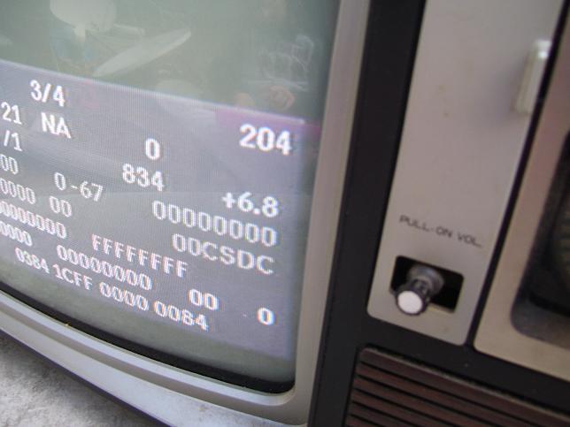

This one has a goofy ID number nothing like the one on the back. Also it CHANGES every time I plug it in! :eek: ..It still works for finding DCII signals, though. At 17 bucks it don't owe me anything after it helped me get the 5'er tuned in! :D:up

You can check by going to option 6 4 or if the unit is 12:00pm and on channel 255/204 when first plugged in. (Like after a MR)
Pic is of a unit that has a bad ID.
