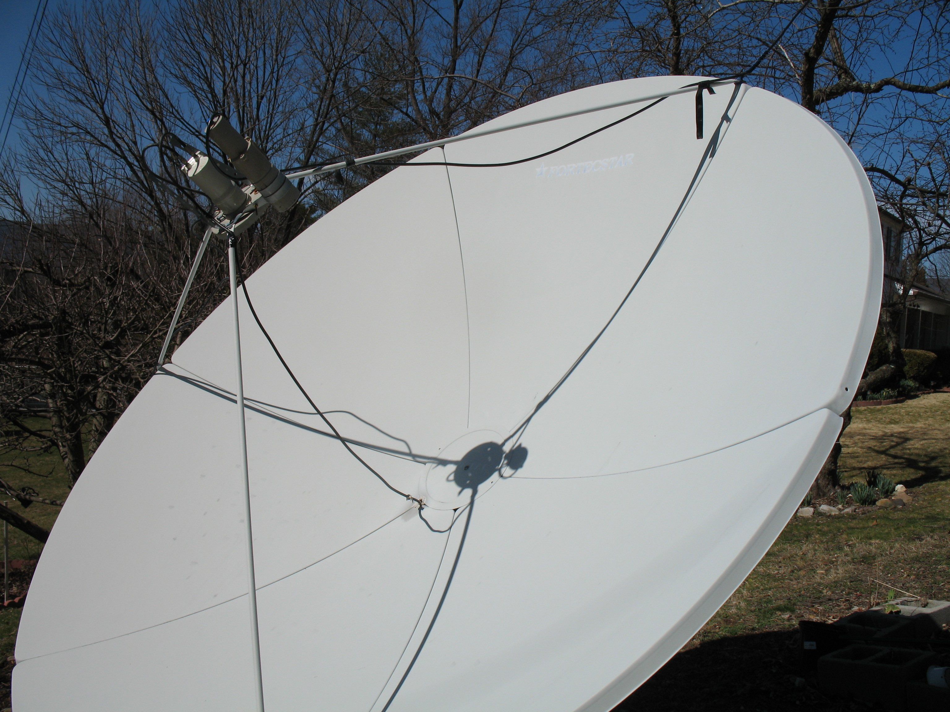

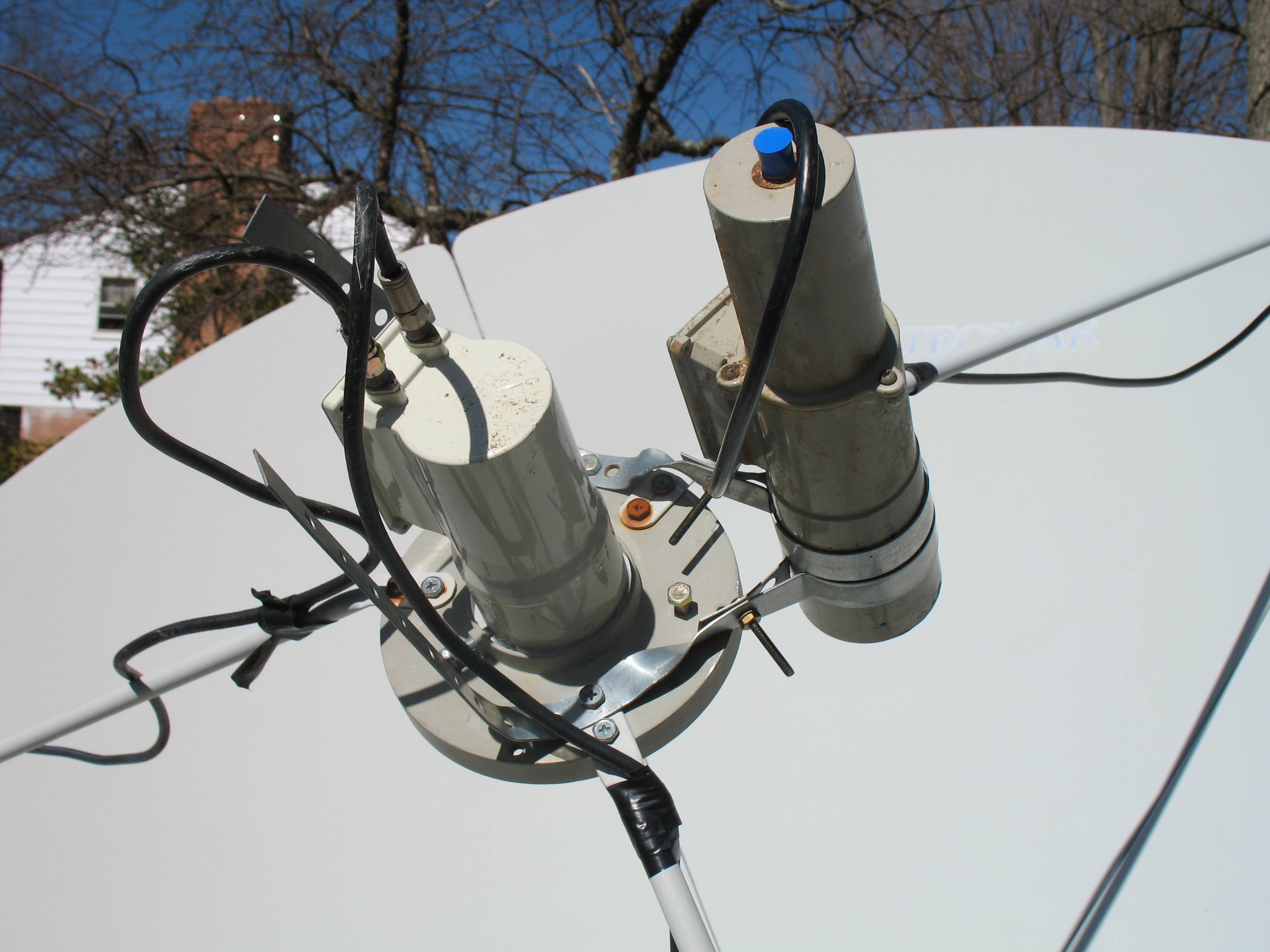

IMG_0614.JPGIMG_0616.JPGI am using an 8 ft stationary dish aimed and peaked at 99W (G16) with an offset LNBF to get the signal for my DSR922 from 105W. I get plenty of signal for the DSR922 (EBNO >9). If you have extra LNBF, you might try the same. Photo attached. The dual LNBF is for 99W, the other is for 105W.
I like that setup migold! I got to find a satellite chart so I can try to get the arc set up on my dish. Got to find the X4 satellite so I can get my maps redone plus to reset the clock on the 922.
