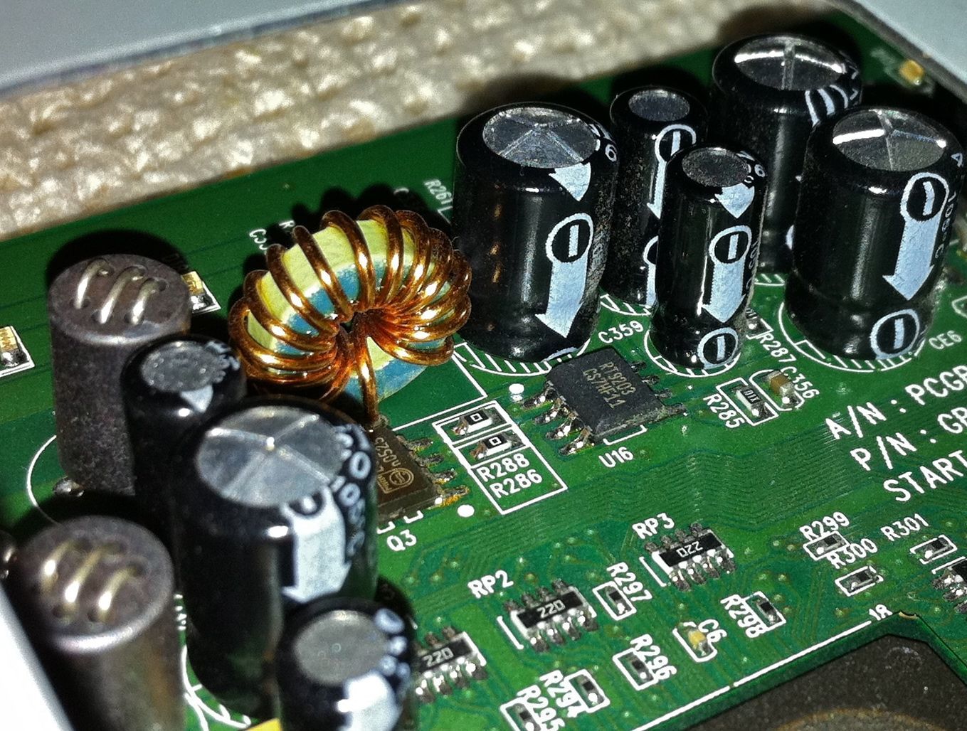

I swear, you can't write this stuff: when I got home from "Green Lantern" (an enjoyable movie, BTW), my Mac was telling me that it had no connection to the iTunes Store. I noticed that all the lights on my Ethernet switch were out, and when I went to pick it up, the Linksys SD2008 switch was extremely hot to the touch.
I had repaired this switch 2-3 years ago when it had failed the first time. Bad caps, of course; two 2000 uF 6.3 V caps in the 5V power section. So, I opened the Linksys up to see what I could see. The photo is attached and you can see that four of the caps are swollen. I'm so lucky...
As I don't have any 470 uF 16 V electrolytic capacitors on hand, I ended up at Staples and bought another Netgear ProSafe switch. The good news is they had reduced the price by $10 and I'll be back on line in no time.
