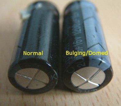

P.S. I found an image of a bad capacitor. It is more likely you will see something like this happen inside the PS than on the motherboard.
